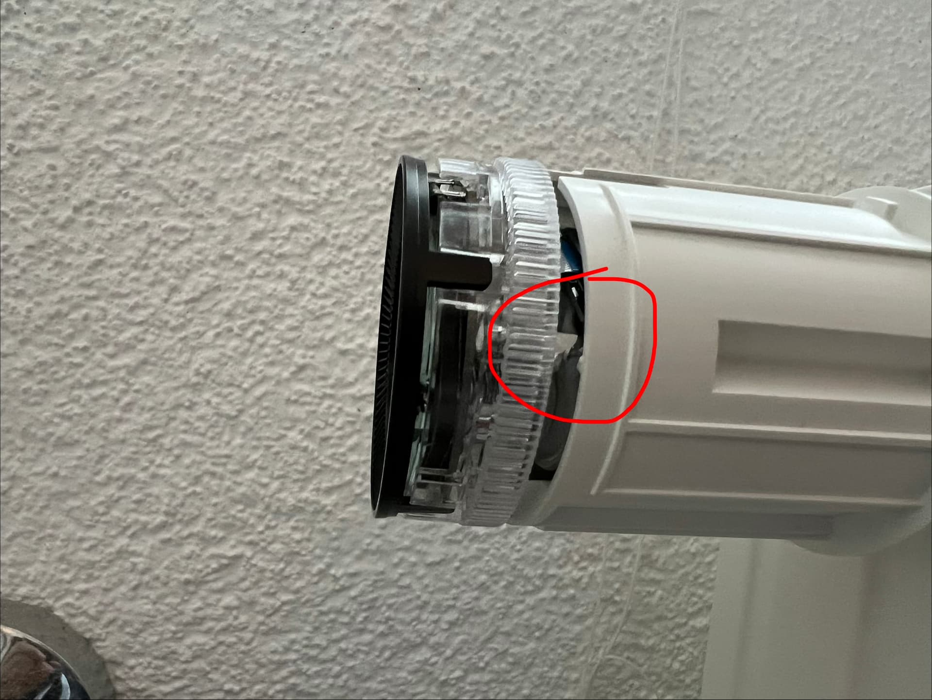

In my opinion, the problem is that the motor is too powerful and the calibration does not work well, so the motor does not stop in time. In other words, when the valve is closed, the motor generates too much tension on the thermostat/housing. This makes it difficult or even impossible to operate the thermostat manually.
In some cases, constant pressure is also exerted on the rotary knob, which causes the thermostat to constantly switch to pairing mode.
In my defective thermostats, the pressure was so strong that the internal anchorage broke.

the screws are broken.

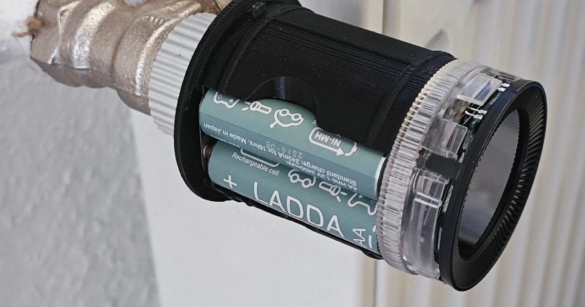

you can 3d print a replacement housing with better screw holders so you won’t need to throw away the whole device
