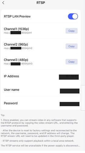

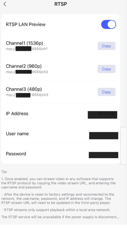

I use a different NVR myself, but if you have enabled RTSP LAN Preview in the settings, the IP address, URI, user name, and password should be displayed.
According to the Hikvision website, you then need to enter the following URL in the software:
RTSP with Authentication
rtsp://[username]:[password]@[IP address of device]:[RTSP port]/Streaming/channels/[channel number][stream number]
So, for example, I would assume that to achieve 960p with the G410, you would need to enter the following:
rtsp://123:987@192.168.178.100:8554/ch2
