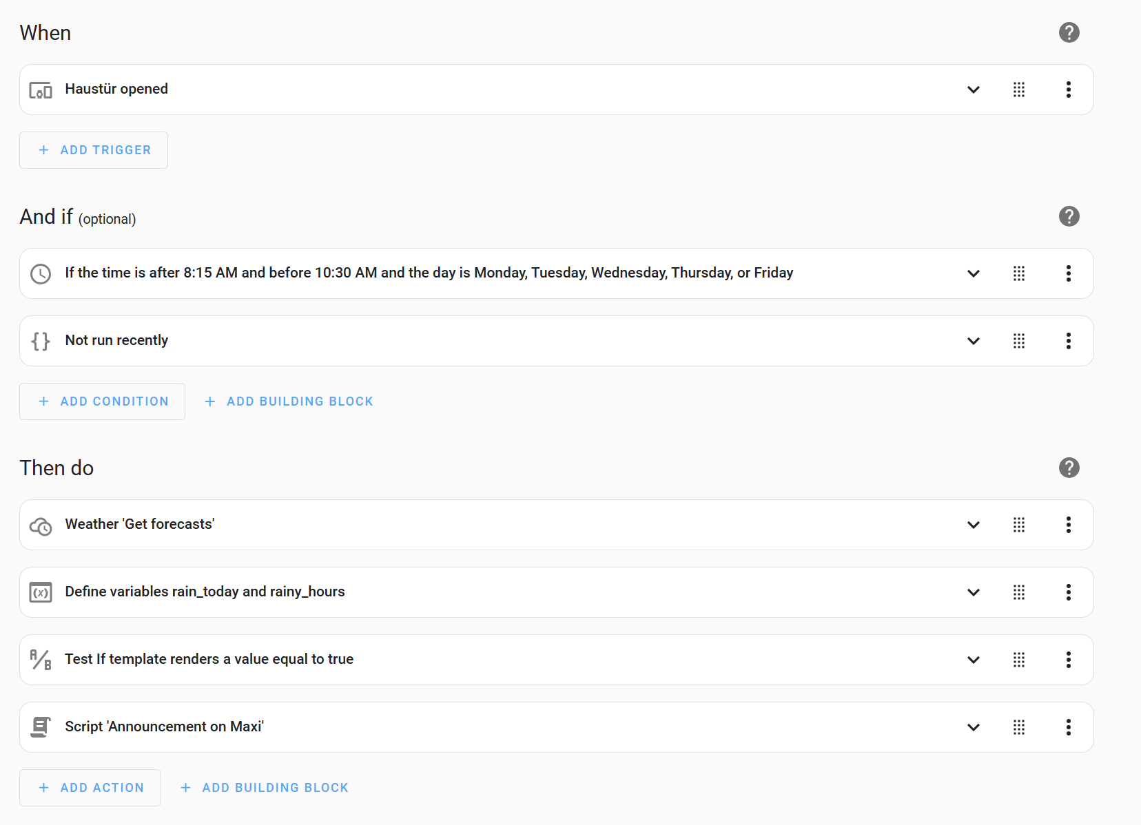

I bike to work. As I regularly ended up being surprised by rain on my way home without rain clothes, I set up an automation to warn me via a TTS announcement on my Google Nest Hub whenever I leave house.
Currently this only includes a door sensor and my Nest Hub Max. It’s realized by the Home Assistant automation shown below.
One weak spot in this set up currently is that it can’t differentiate whether someone comes home or whether someone leaves home. Combining this with a presence sensor would allow to resolve this issue.

@mark_lanthaler Thank you for sharing your current setup! It’s inspiring to see how you’re utilizing automation to make your daily routine more convenient. To address the issue of distinguishing between someone coming home and someone leaving, integrating a presence sensor like the Aqara Presence Sensor FP2 could indeed be a great solution.
The FP2 sensor supports various automation and scenes that can help you achieve this distinction, such as detecting if someone enters or leaves a space. You can configure it to trigger specific actions based on presence or absence over a set period. This might allow your system to make more precise announcements about weather conditions, enhancing the reliability of your setup.
