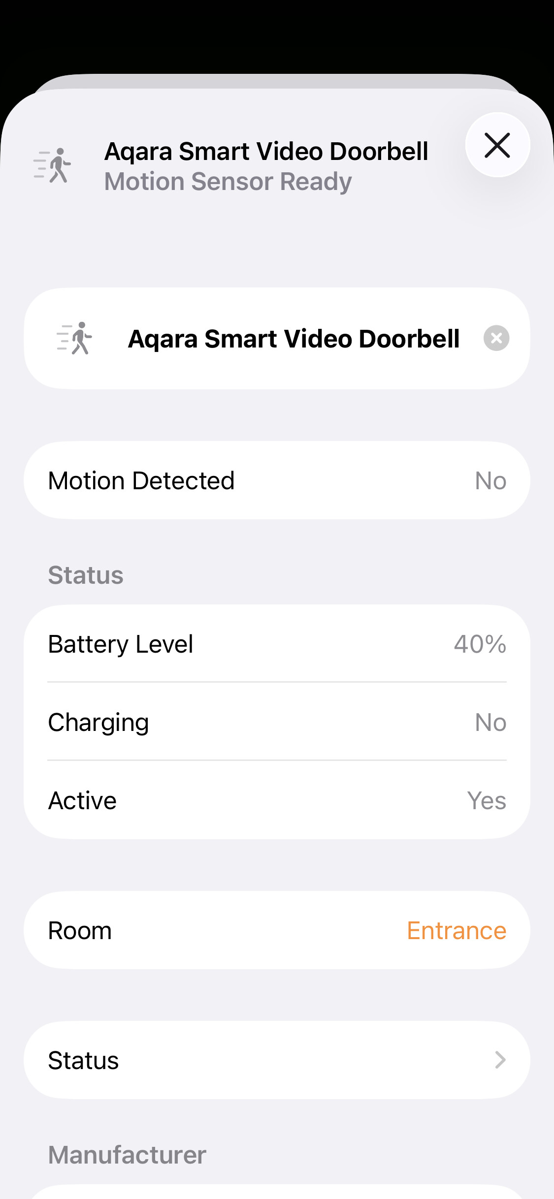

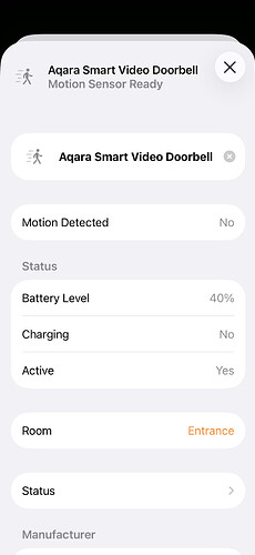

However, when I connect to Apple HomeKit, there are no notifications β€” no motion detected or chime bell rings.
I checked the Apple HomeKit settings and found that the motion detection is off and cannot be changed.

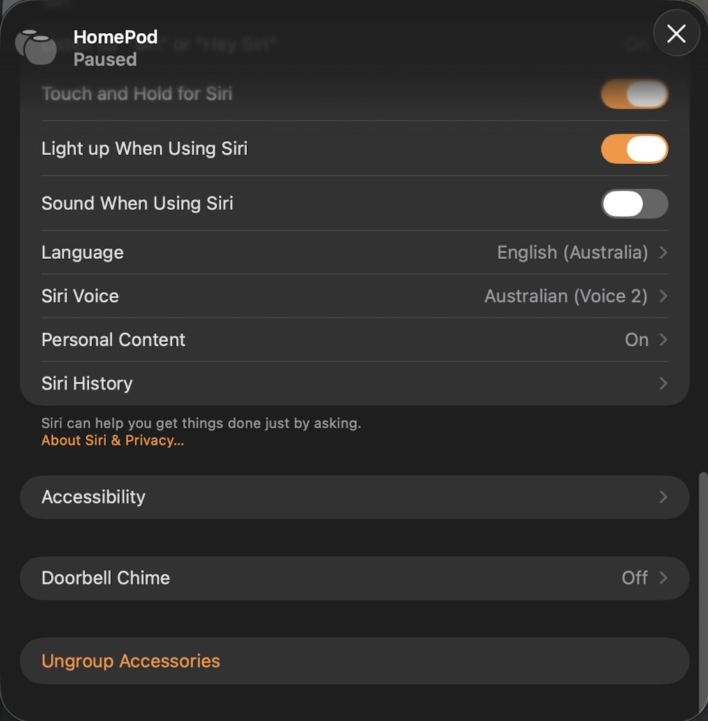

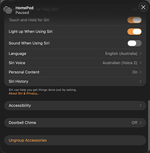

As far as chimes are concerned check your HomePods to see if that is on. You go into settings on the HomePod and scroll down.
