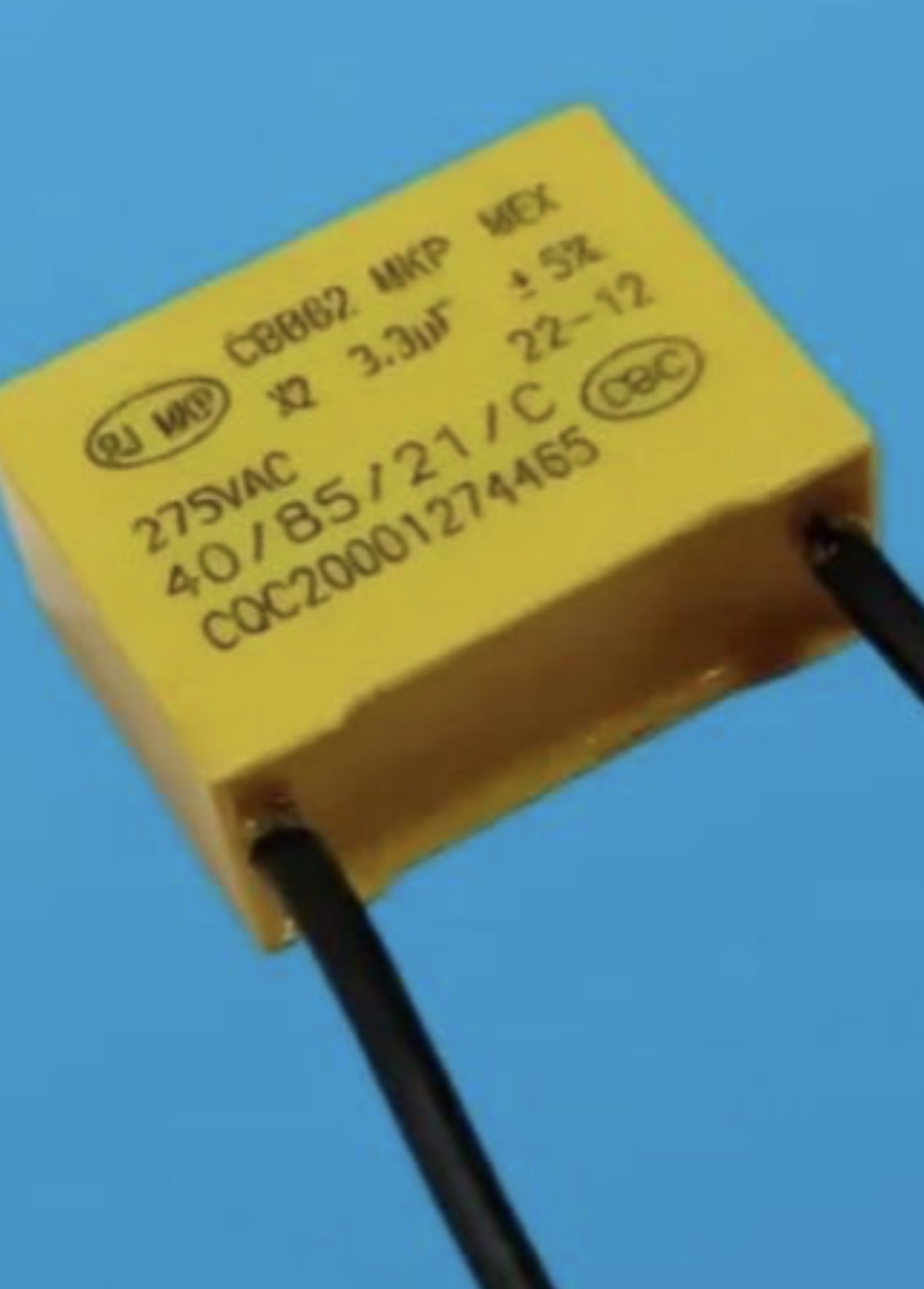

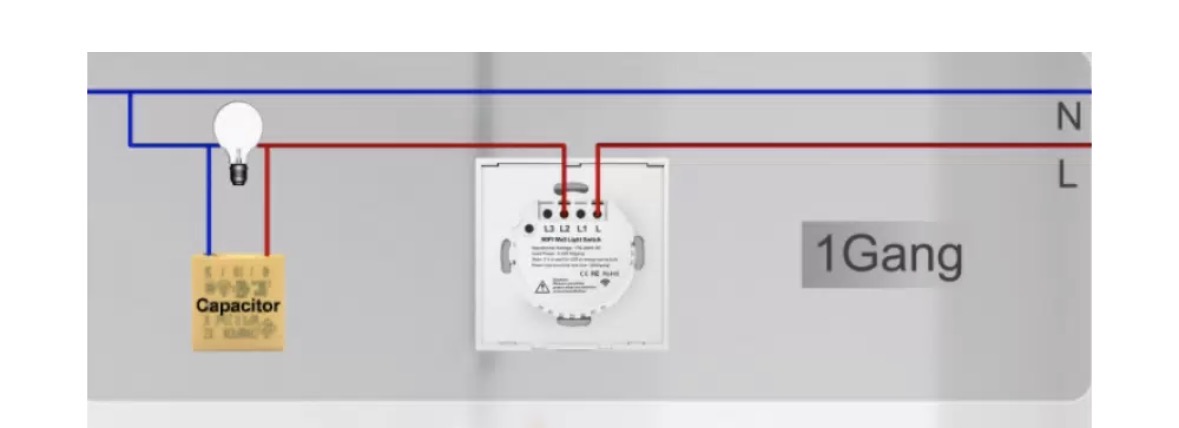

If you use a connection without a neutral, you need to install a capacitor so that H2 does not disappear from the network.
Can you give me more detail about adding that capacitor? What size capacitor and where should it be installed?
Thanks!
