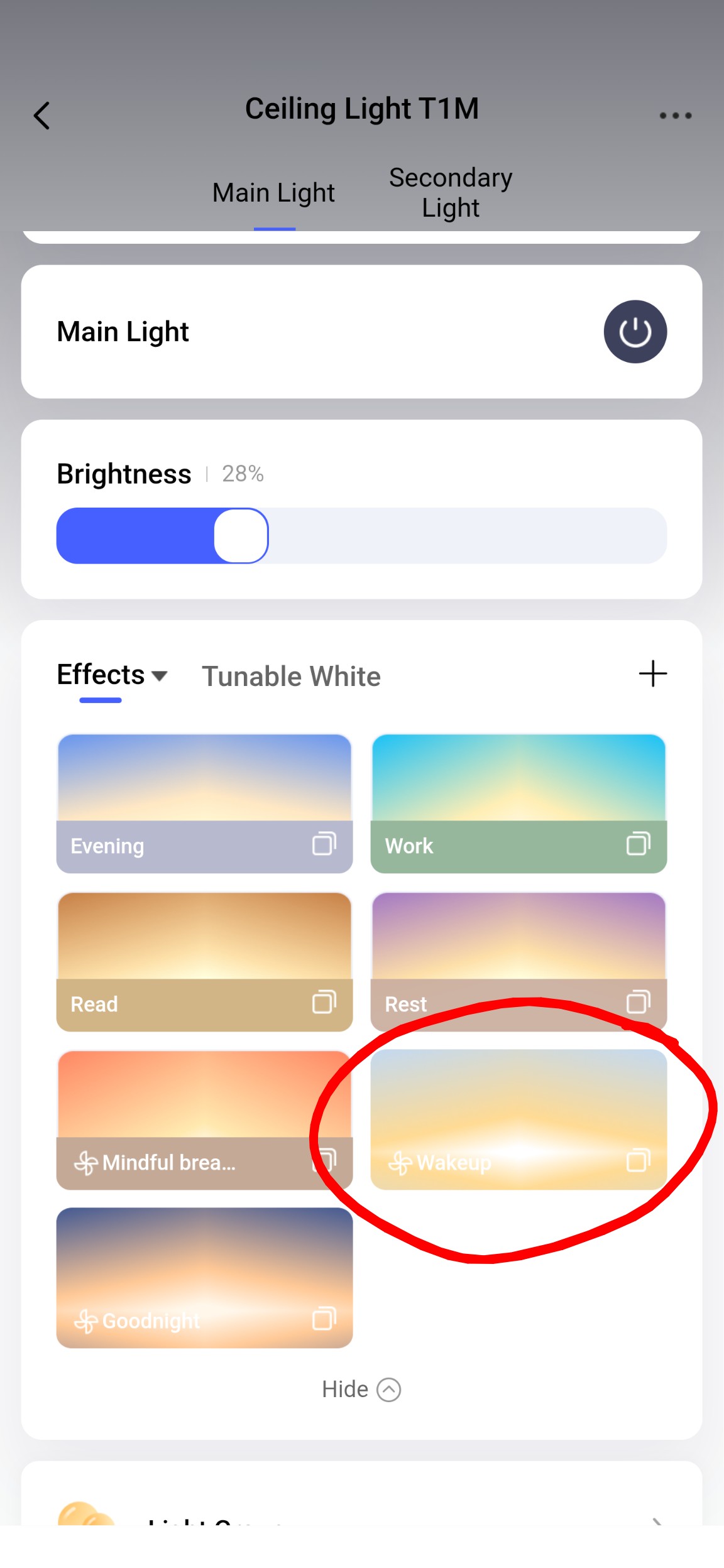

There’s an effect sequence for the white light called Wake-up.

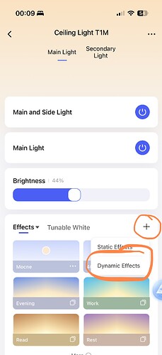

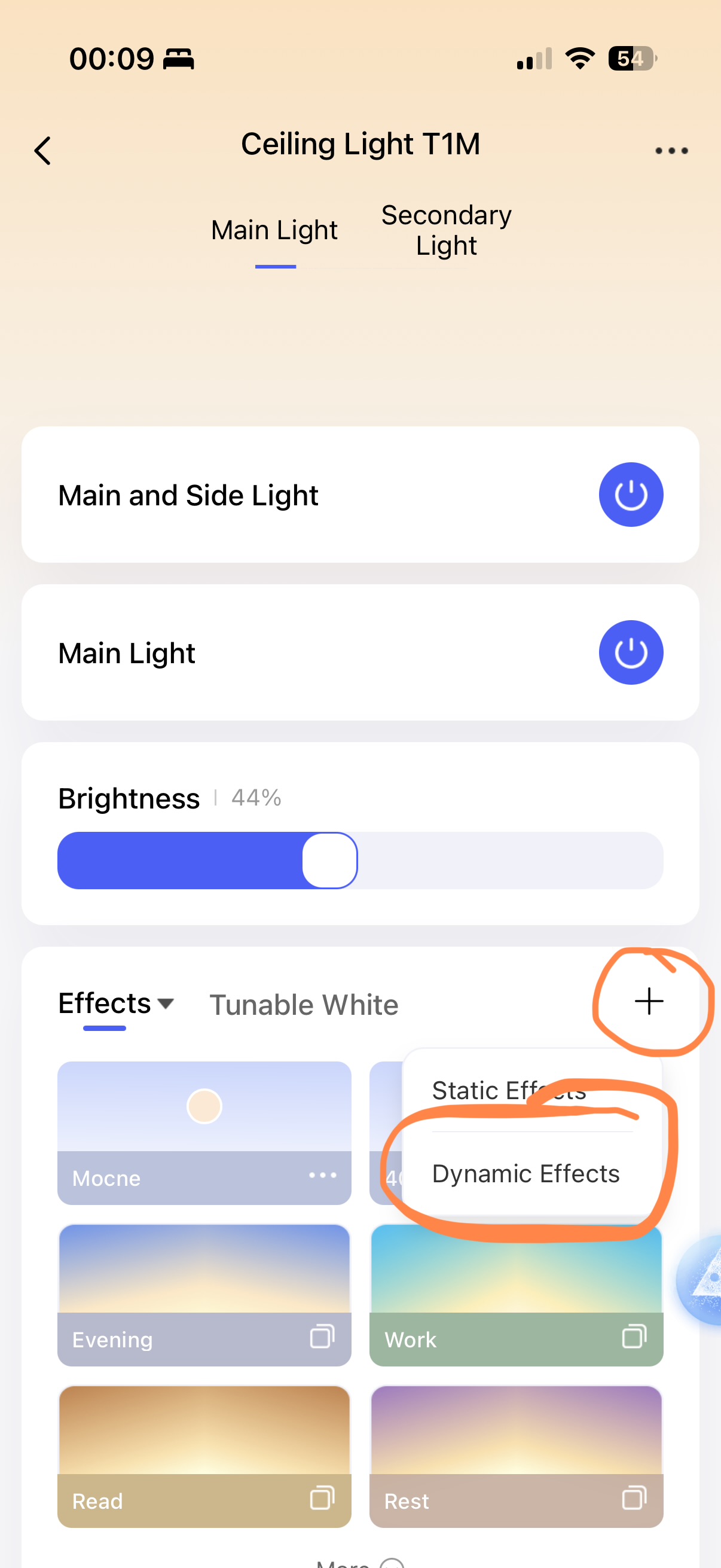

If you wish to manually configure the effect (instead of using the default Wake up), you can click “Main Light”, then +, then “Dynamic effect”.

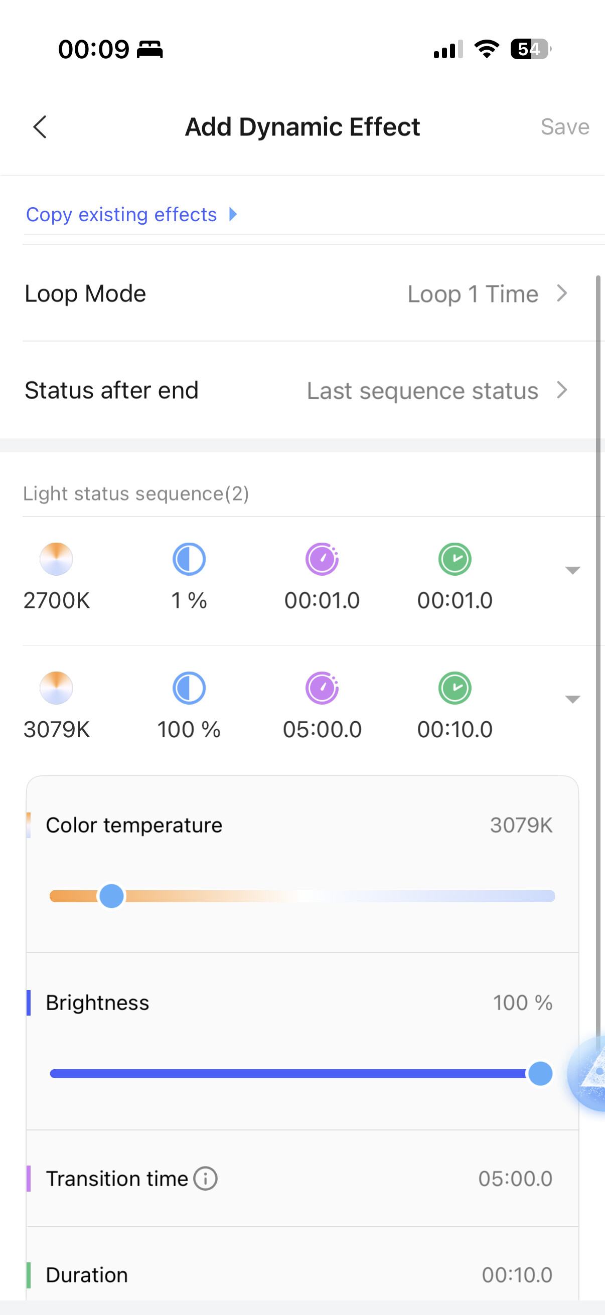

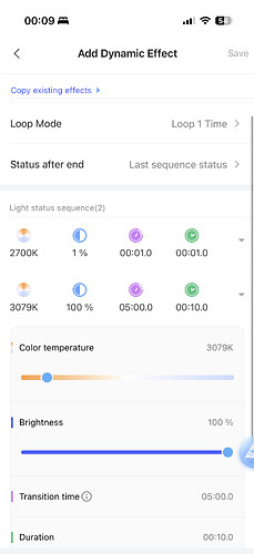

On this screen set “Loop 1 time” and add two sequence items - one is the starting brightness, second is what you want at the end.
Set the duration and transition time of the first sequence item to 1s.
Set the transition time of the second item to the desired time (for example: 20min).
Example (transition from 2700K 1% to 3079K 100% in 5min):
