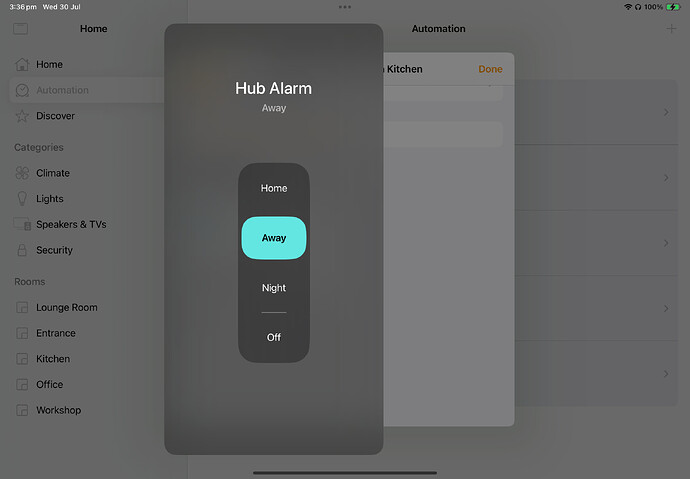

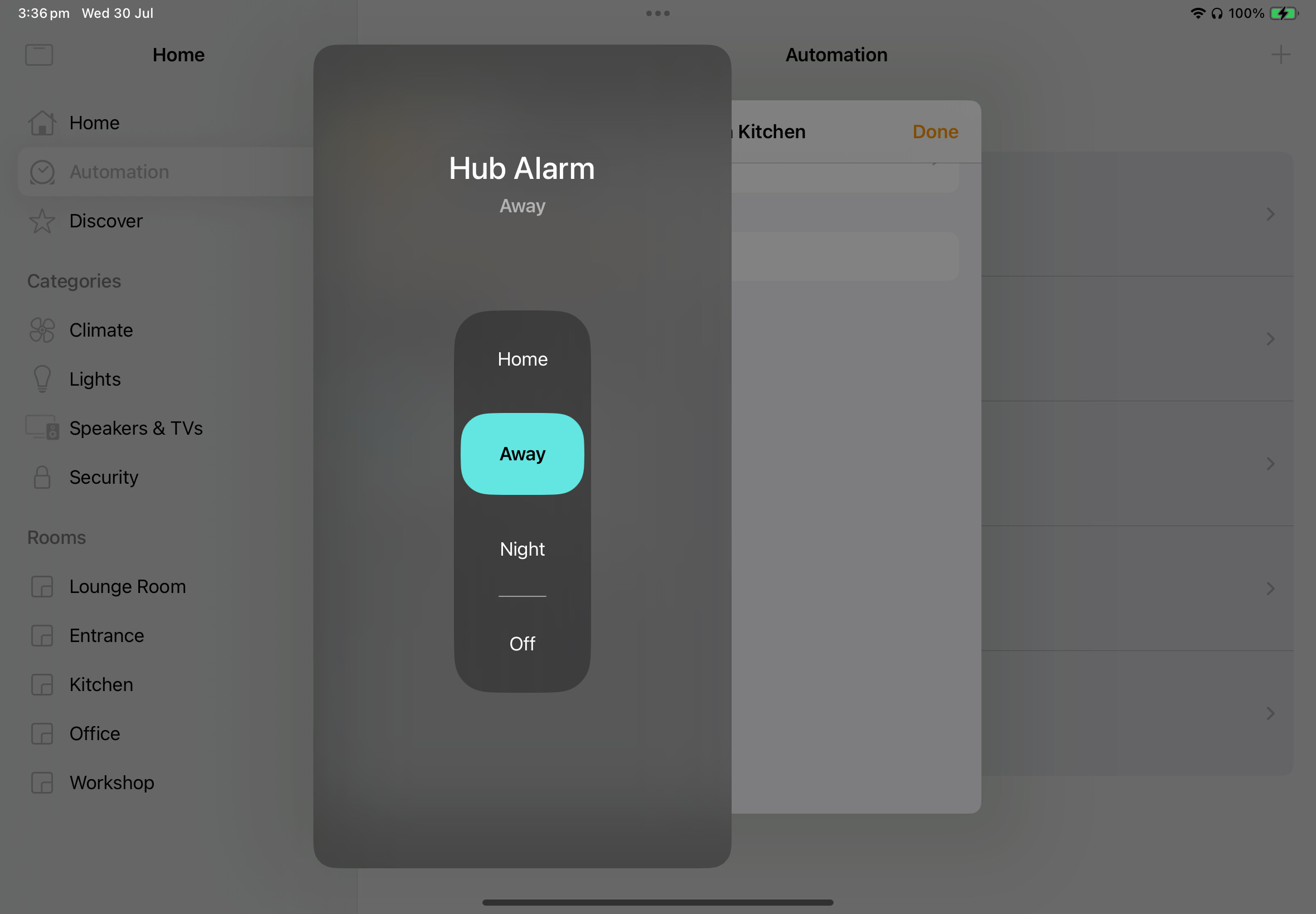

I have created an automation to set both alarms to “away” when we leave the unit, and “off” when we come home. Both automations sound an alarm off/on sound when testing.

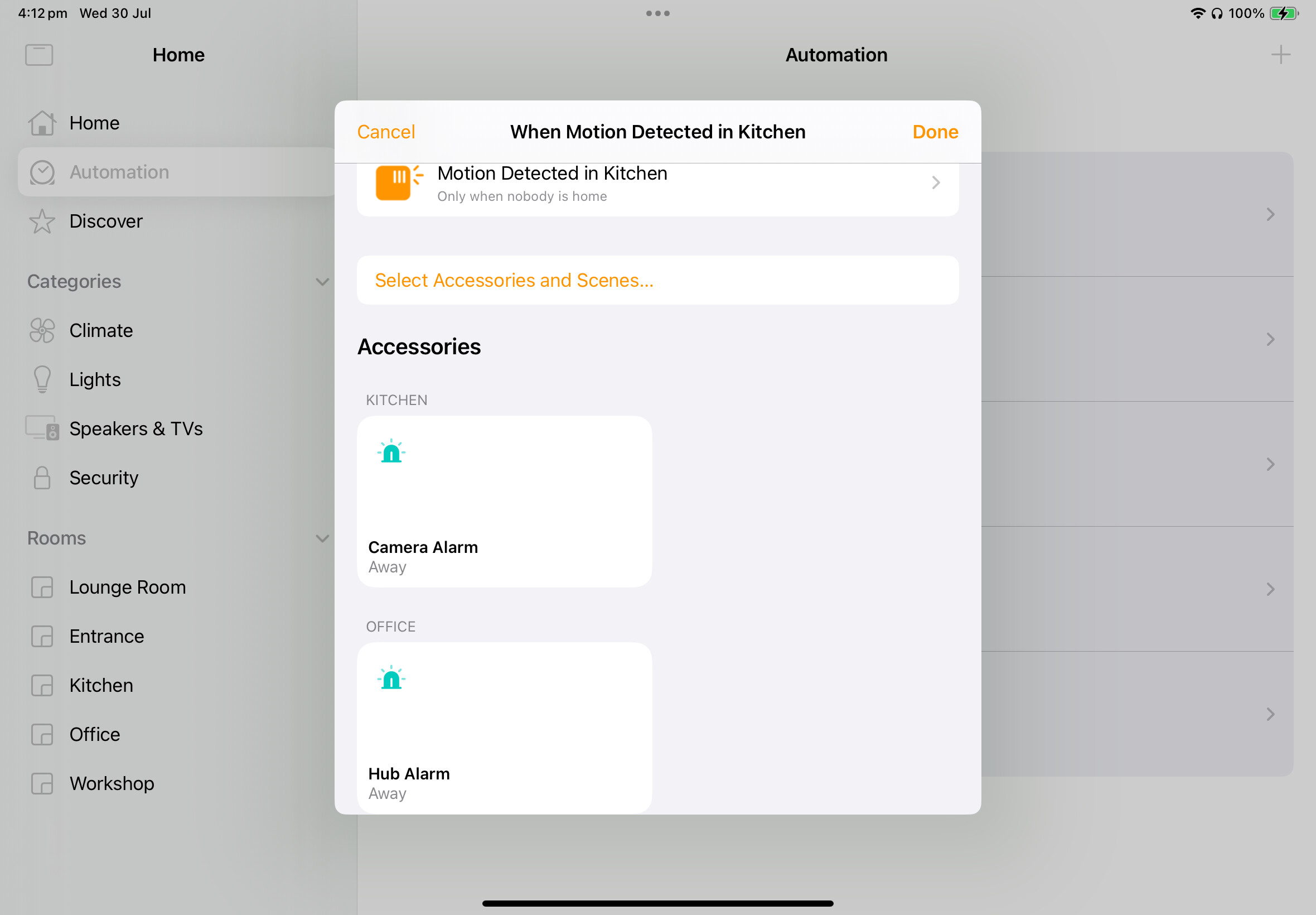

But when I try to create an automation to set the alarm off after the camera detects motion, I can only change the alert system

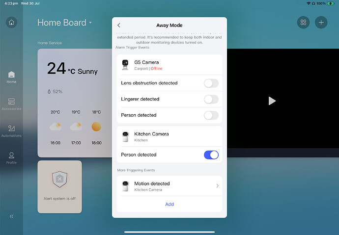

I am assuming that there are more settings to set up in Aqara. So here is what have setup thus far under the “alert system away mode”. Nothing really changes in HomeKit after I change Aqara to HomeKit mode as well

  1. Motion Detection in Aqara App: Make sure the motion detection feature is activated in the Aqara Home app. From your description, it seems like you’ve set the alert system to “away mode,” which is great. Double-check if the motion detection is linked to trigger the alert.
  2. Automation in HomeKit: In the Apple Home app, ensure that the camera’s motion detection is set to trigger the desired action. Sometimes, the settings in HomeKit may require a recheck to ensure they align with the Aqara system settings.
