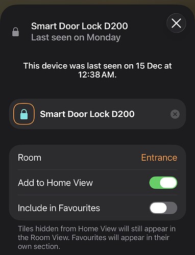

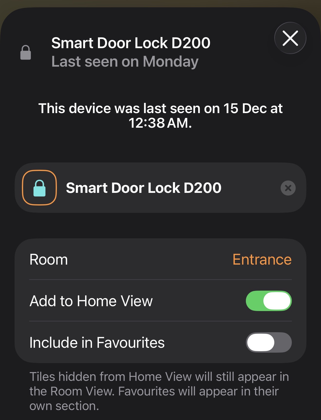

After upgrading my iPhone, tvOS, iPad, HomePod mini to ios/tv/ipados26.2, the Aqara lock D200i has been showing up as “no response”. Prior to this upgrade, it had always been working great with no issues.
Is someone out there having the same issue as I and if there’s an issue with the iOS 26.2 or something else?
