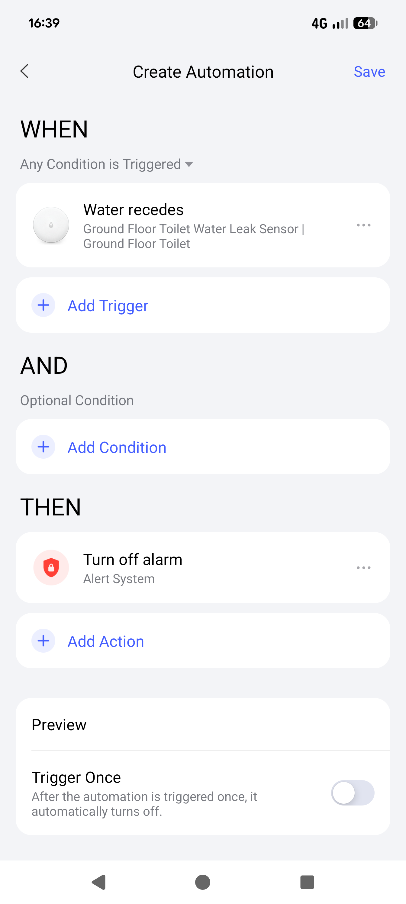

How can I stop alarm automaticly from M2 Hub If the water sensor is back to normal
When I receive an alarm the M2 Hub keep flashing red until I have confirm that I have seen the alarm. Is it possible to get an automatic confirmation that will stop the alarm if the Water sensor dectector is getting back to normal without havong to confirm the alarm in the app?

I know that it can be done from the APP but I am wondering if there is a way that I can set the HUB to understand automatically that if the leak detector come back alone to normal than the alarm from the hub will also go off without going into the app to confirm and silence the alarm
Try
