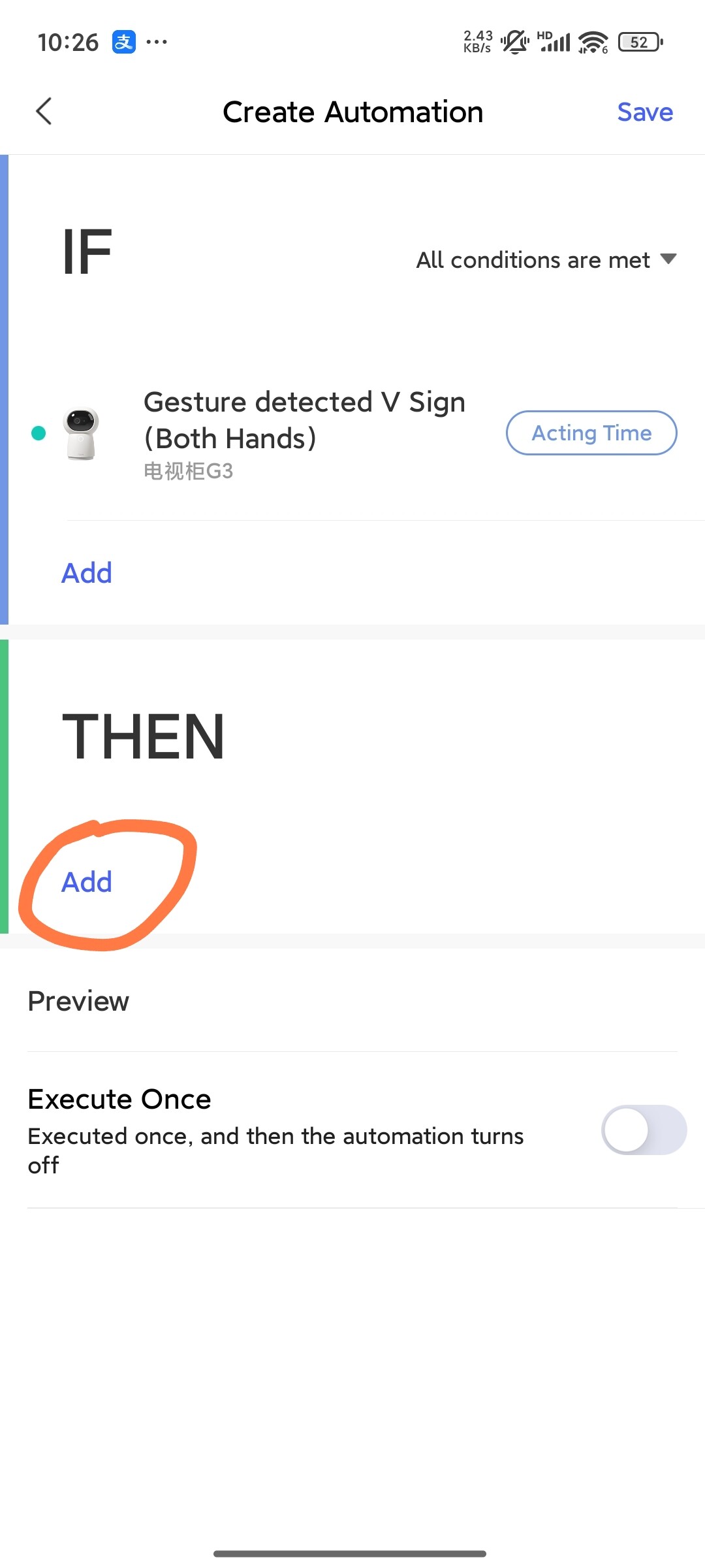

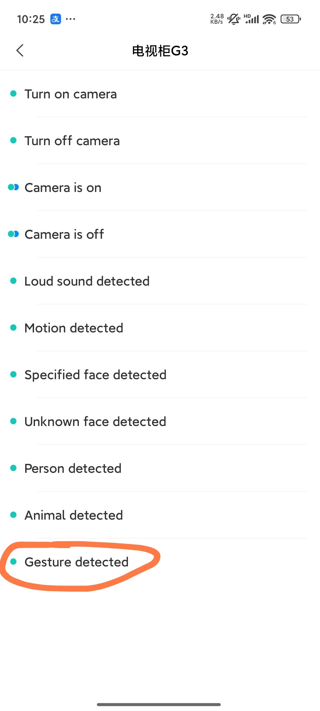

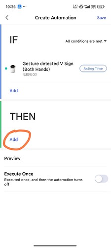

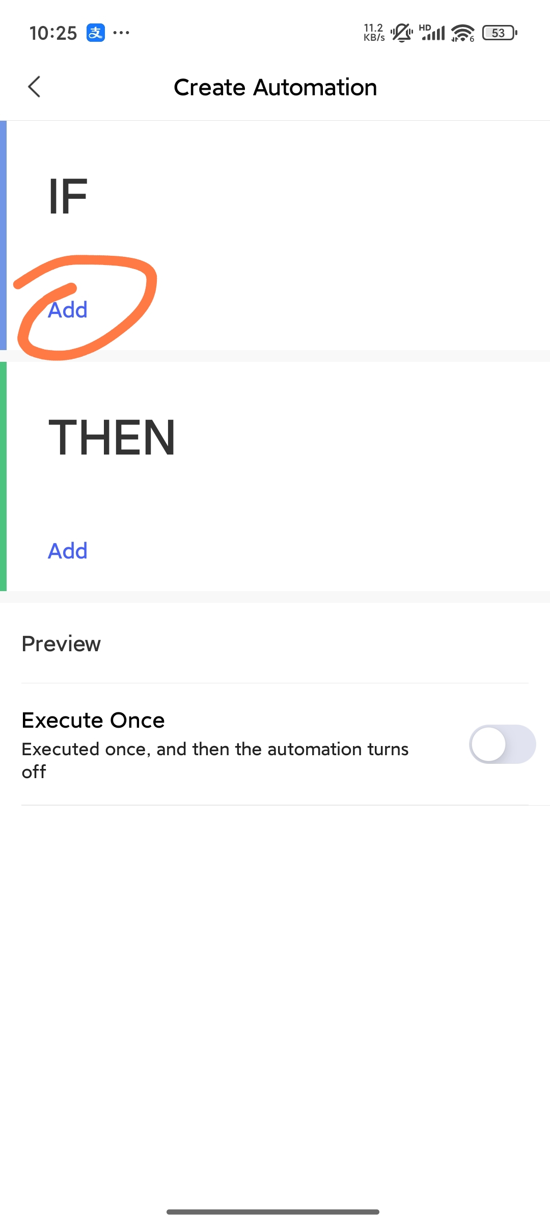

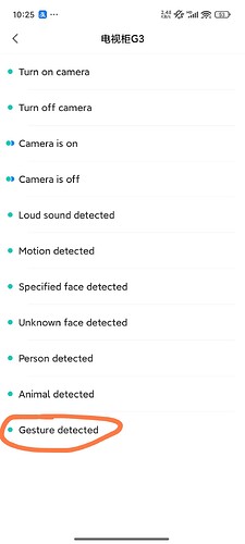

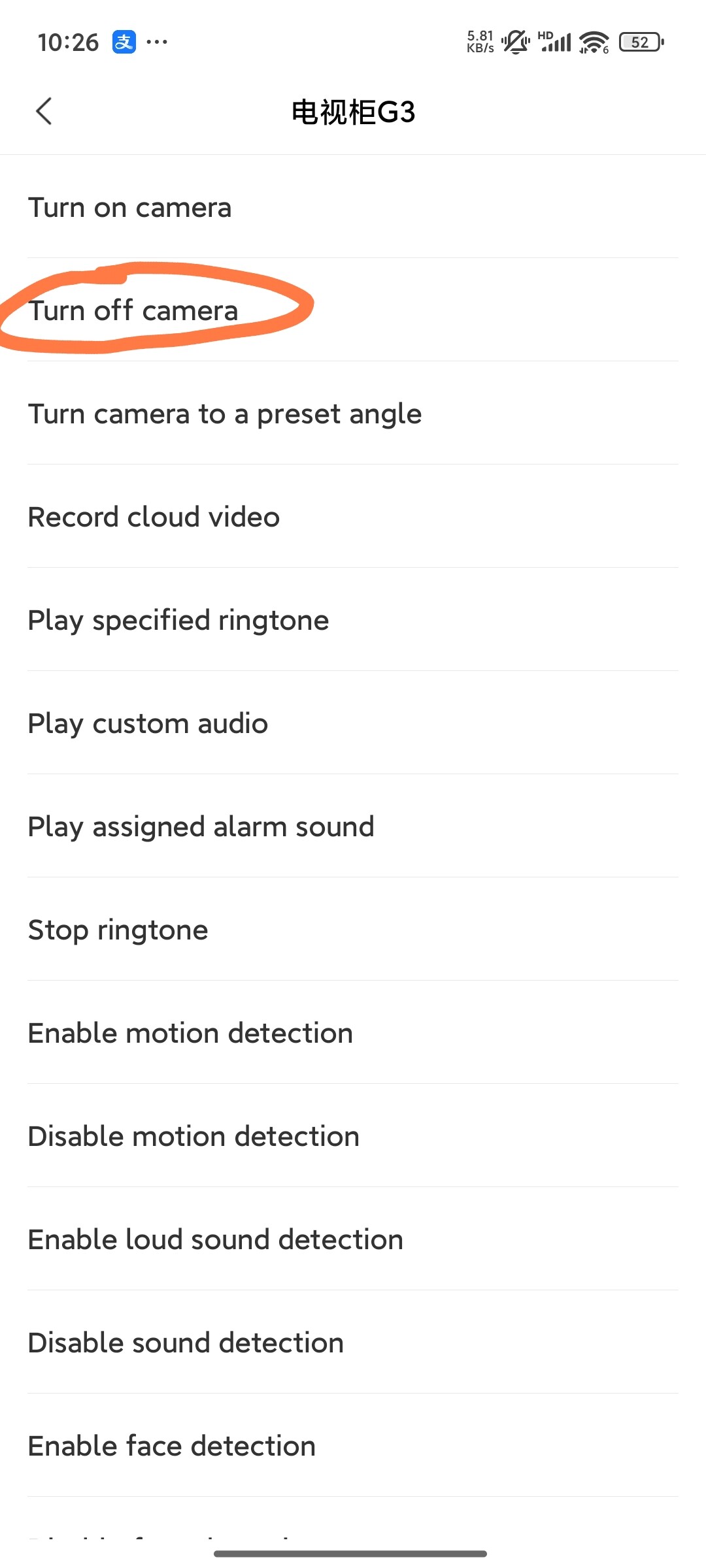

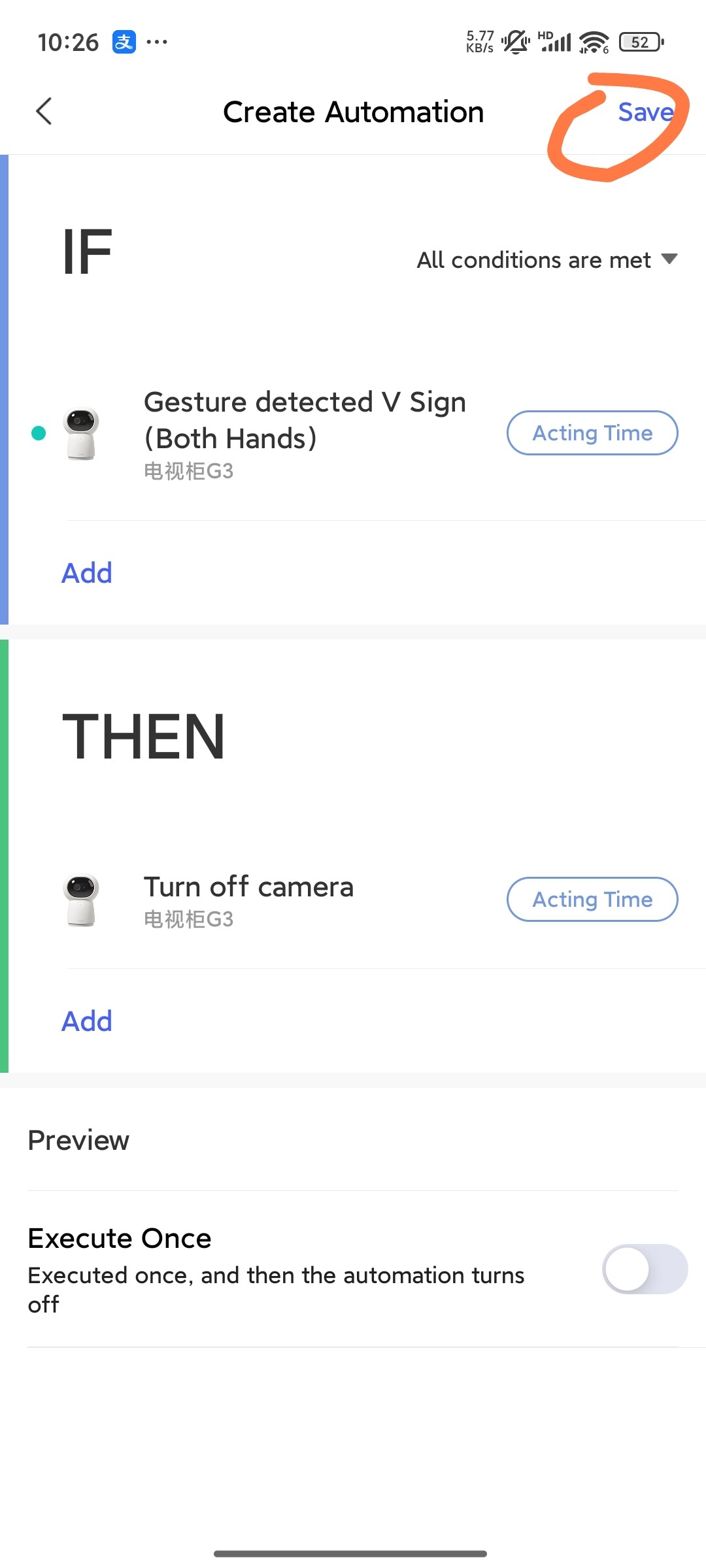

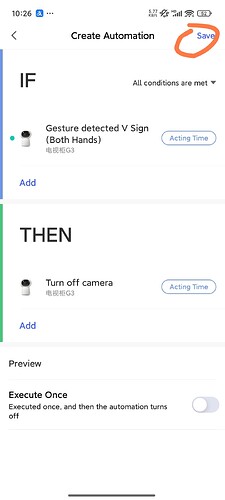

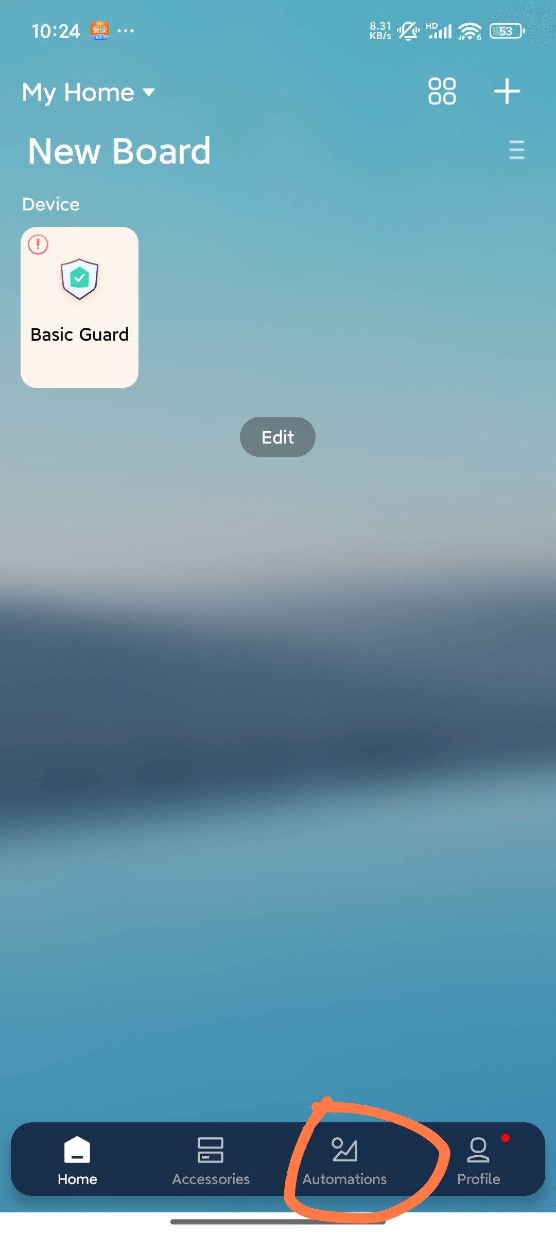

Hello friend
I showed some pictures bellow, and you can follow the configration:
When the camera goes into sleep mode, the lens will be covered and you cannot use gestures to turn on the camera. You can choose to purchase an Aqara wireless switch, bind it to G3, and automatically turn on the camera with click the wireless switch through configuration another automation.
