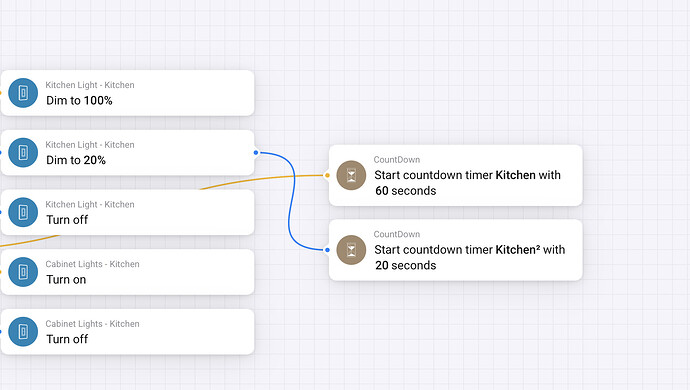

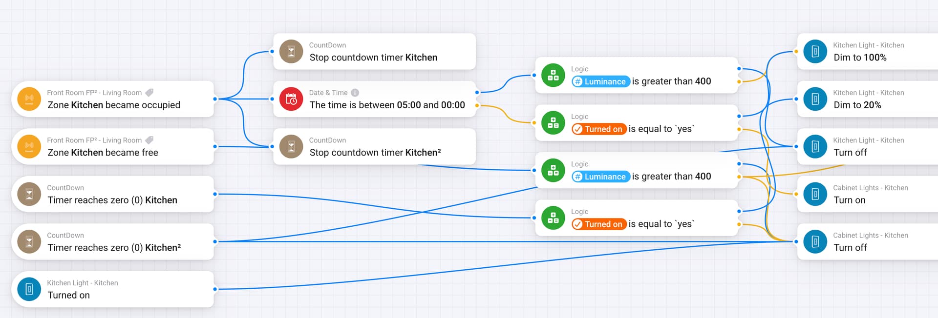

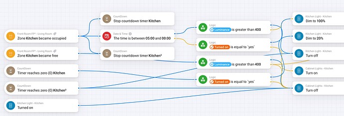

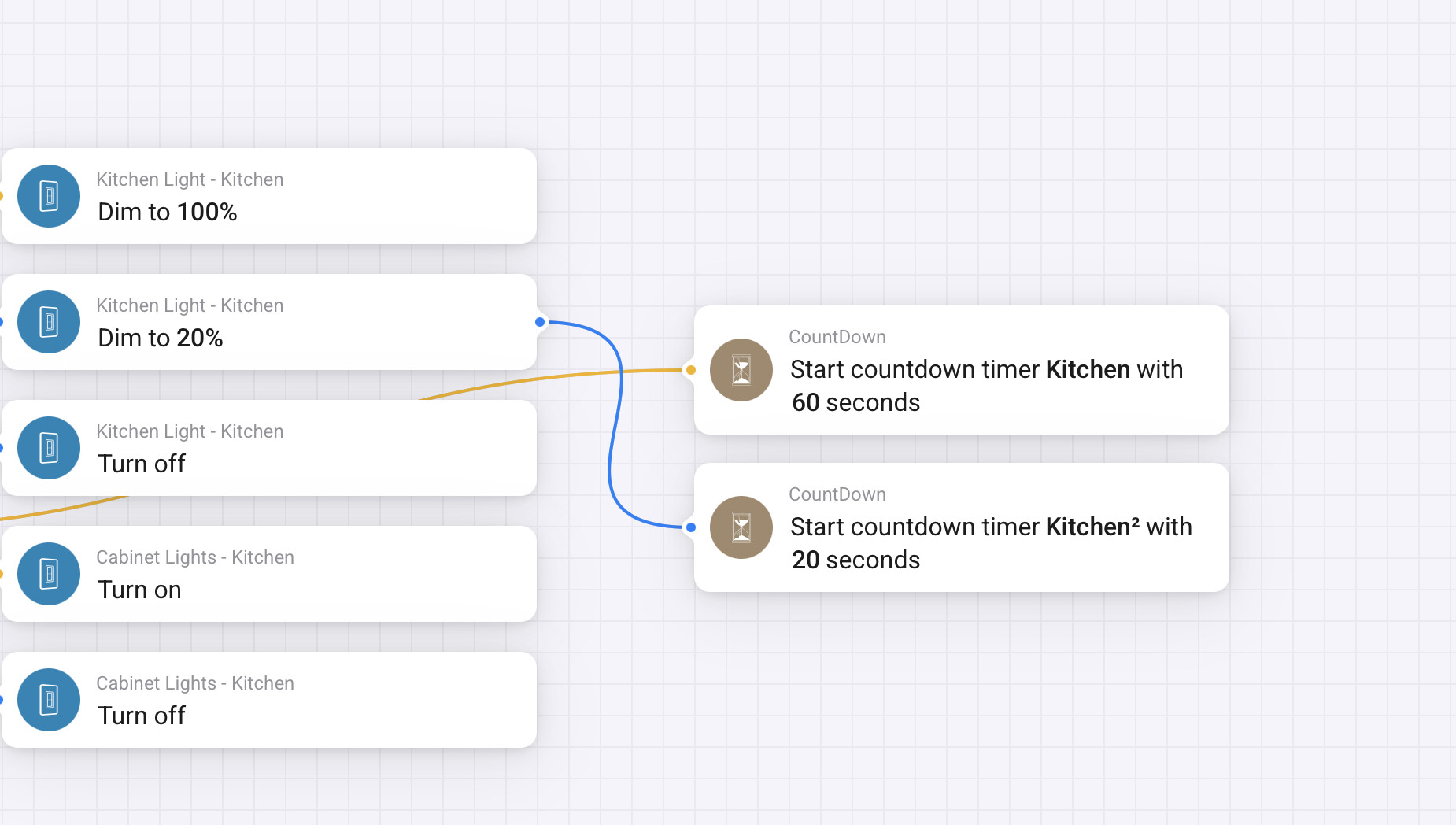

My favorite automation is for my kitchen lights:
When Motion is detected in kitchen during the day: Dim to Kitchen lights 100% if lux is below 400
When motion stops: wait 2 mins then dim kitchen lights to 20%
Wait 20 secs the turn lights off.
At night when motion detected: turn on under cabinet lights
when motion stops: turn off cabinet lights
