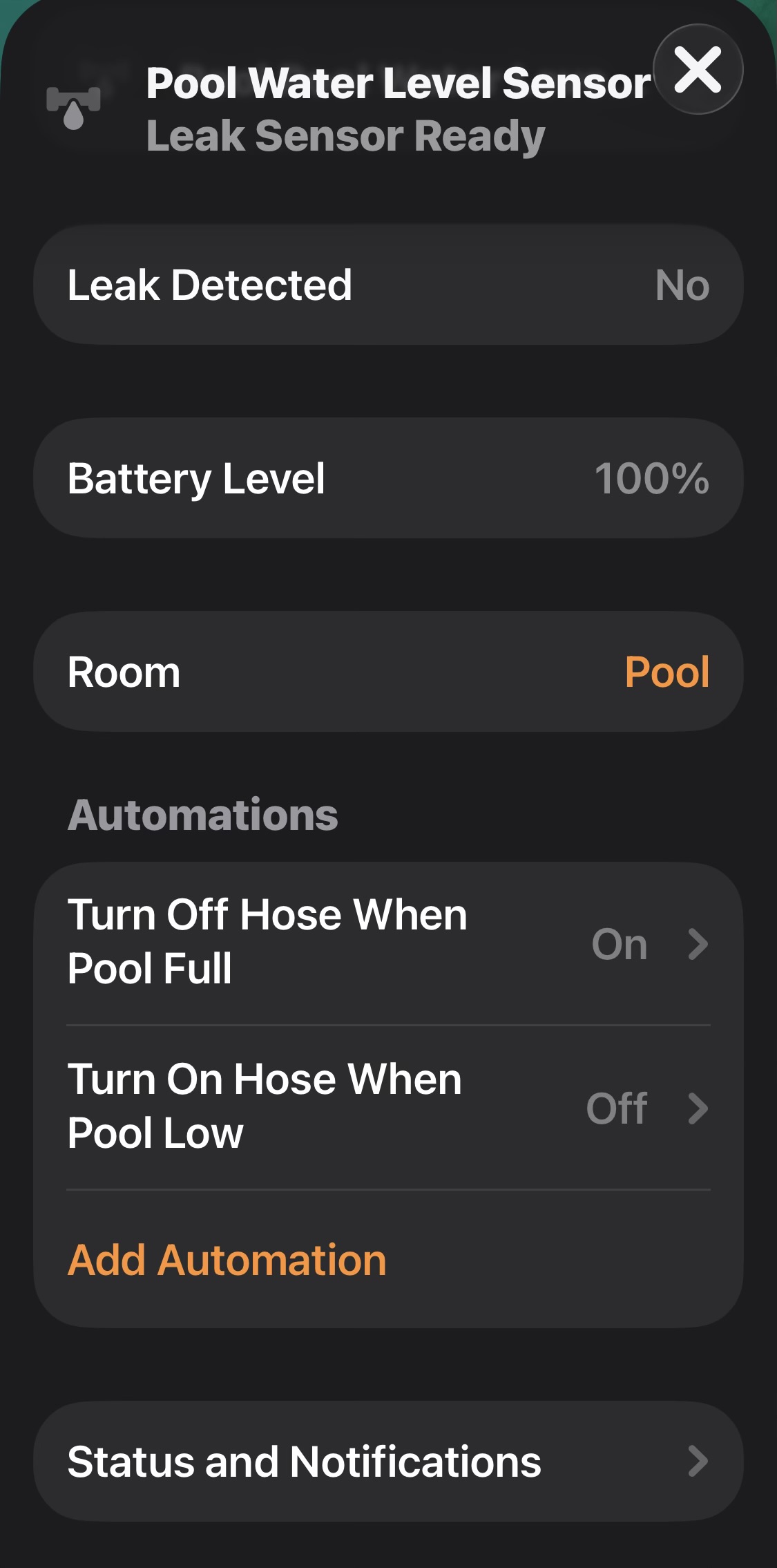

  3. Automations in the Aqara Home app:
  • When Leak Sensor = “Dry” → T1 opens the valve, water flows through the hose/PVC into the pool.
  • When Leak Sensor = “Wet” → T1 closes the valve, stopping the fill.
  1. Scheduling: In the Aqara app, I can have the sensor check the water level on any schedule I want — for example, only in the morning and evening, or just once a day — so it’s not constantly triggering checks.

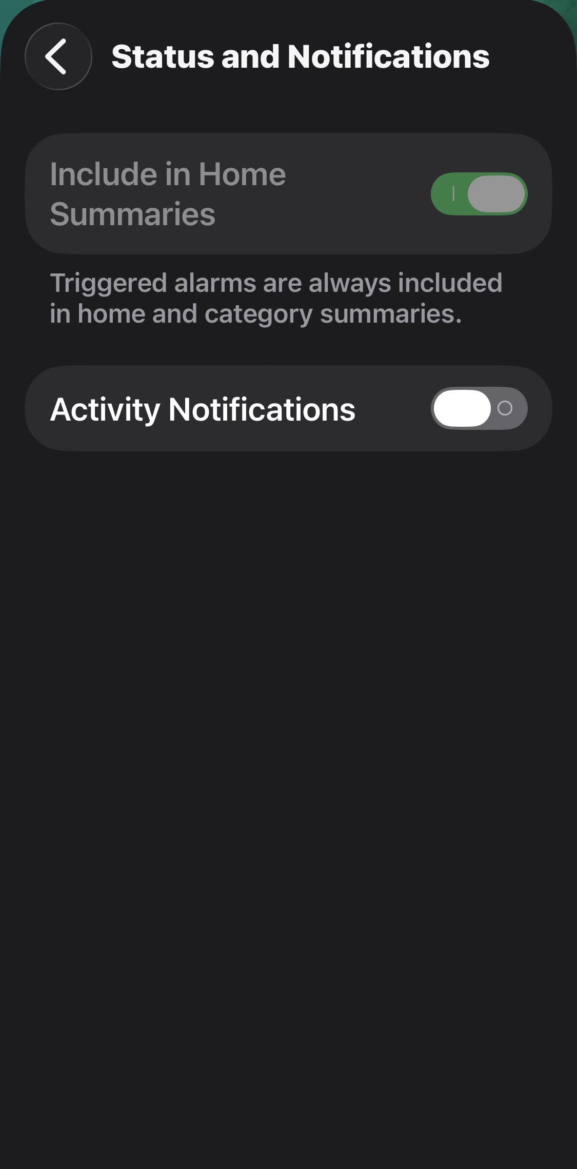

I have the leak sensor added in Apple Home and it triggers critical notifications when it gets wet. Is there a way to disable this? It is perfect when you want protect your household from leaks, but not so great for automations such as pool water level monitoring.
I have the sensor check for the absence of water on Sunday (for example) at 9:05 PM. Since my pool pump turns off at 9:00PM, this gives the water time to calm and stop splashing. Based on my experience, the pool will normally fill for at least two hours before reaching the desired level. I make sure the sensor doesn’t check for the presence of water until at least 11:05PM. I’m sure you can get even more granular if you use an app like Controller for HomeKit.
If you click on the leak sensor and go into the accessory settings, scroll down to Status and Notifications and click. Here you can turn off Activity Notifications. In this case, I prefer to get a specific notification from the Aqara App that the pool needs filling or is full versus HomeKit’s generic message. But, you can choose to turn off HomeKit activity notifications for the sensor and Aqara notifications as well.
