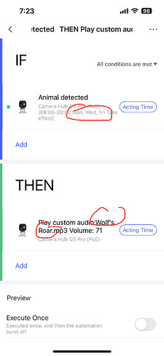

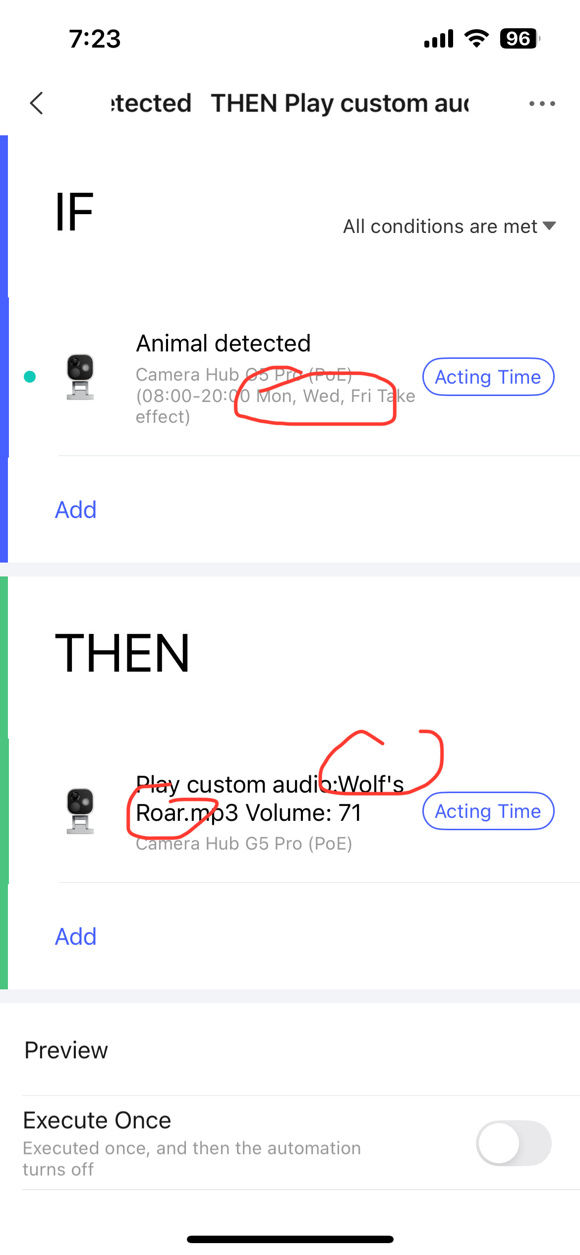

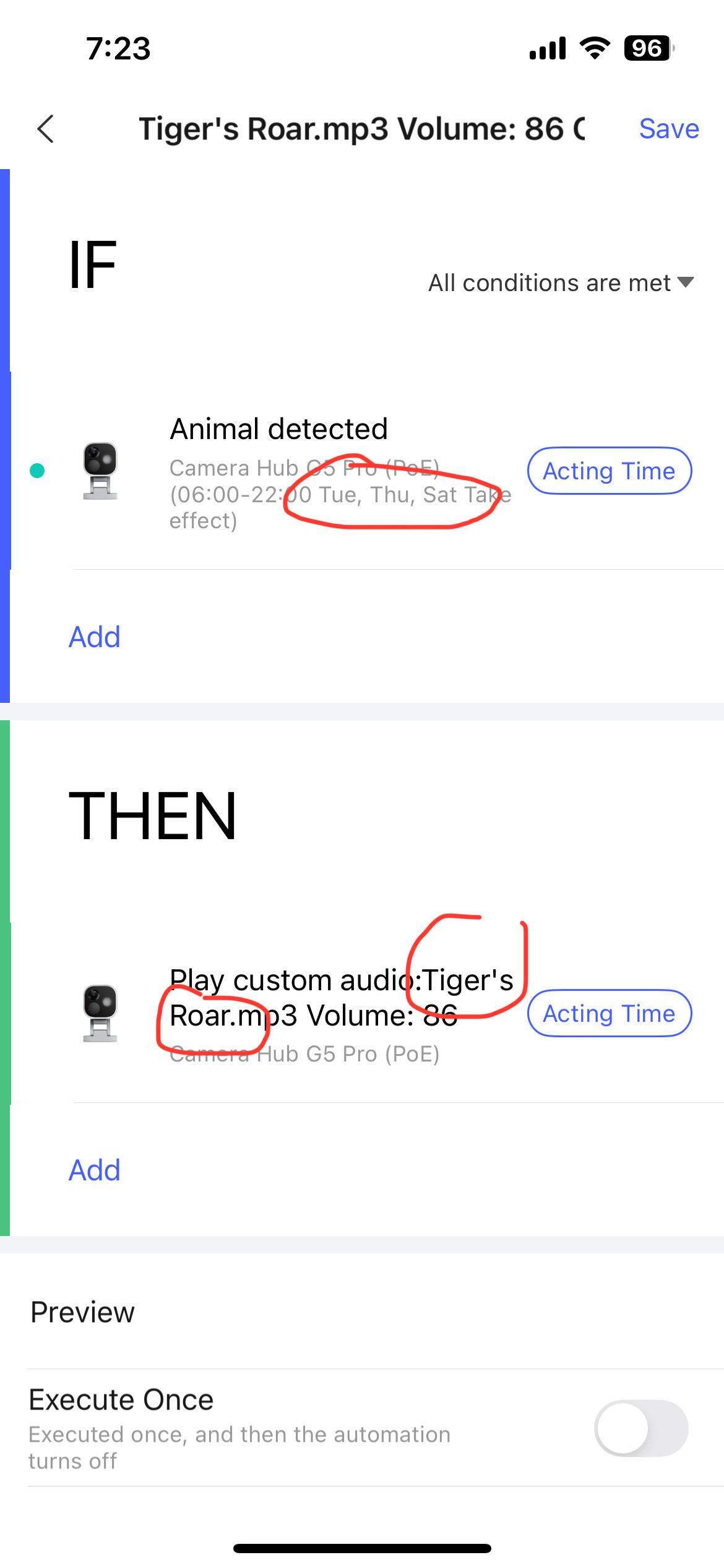

I provide a simple method for your reference:
Just use the custom ringtone feature and the animal detection feature to compose a automation. Here are two examples: playing different carnivorous animal roars at different times in a week to avoid these herbivores forming negative conditioned reflexes and no longer being afraid. You can even increase the number of cameras, distributed in different positions, integrating carnivorous animal roars of different tones for each camera, and setting different time periods for cameras in different positions to detect animals and emit roars, making it difficult for herbivores to find patterns. I think it may be effective, but of course, this may be a relatively complex task (I am using the G5 Pro camera here, and I believe its speaker sound is loud enough, as it can also work outdoors)
