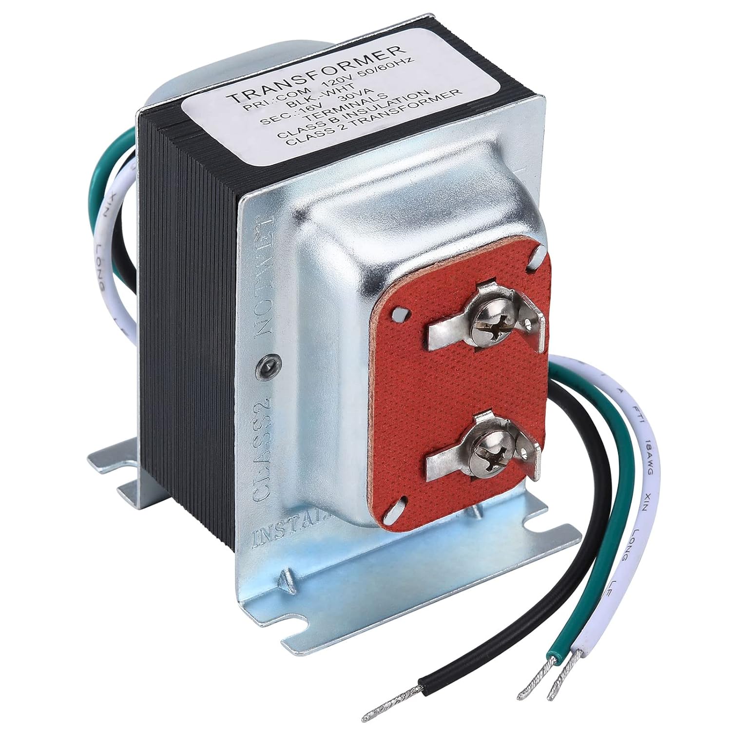

I’m using this: Doorbell Transformer 24V 40VA AC Power Supply Thermostat Power Adapter Hardwired Door Chime Transformer
But I don’t seem to get any power to the relay after connecting it to the mechanical doorbell chime via instructions above.
Do I have the correct transformer? Or any other idea of why I’m not getting power to the relay?
I did have an extra two wires that were tied together under a wire nut. It’s possible I disconnected those a long time ago when I wired a chime kit for a Feit doorbell. Kit has been removed and I follow these instructions. But alas, no power. Thanks.
