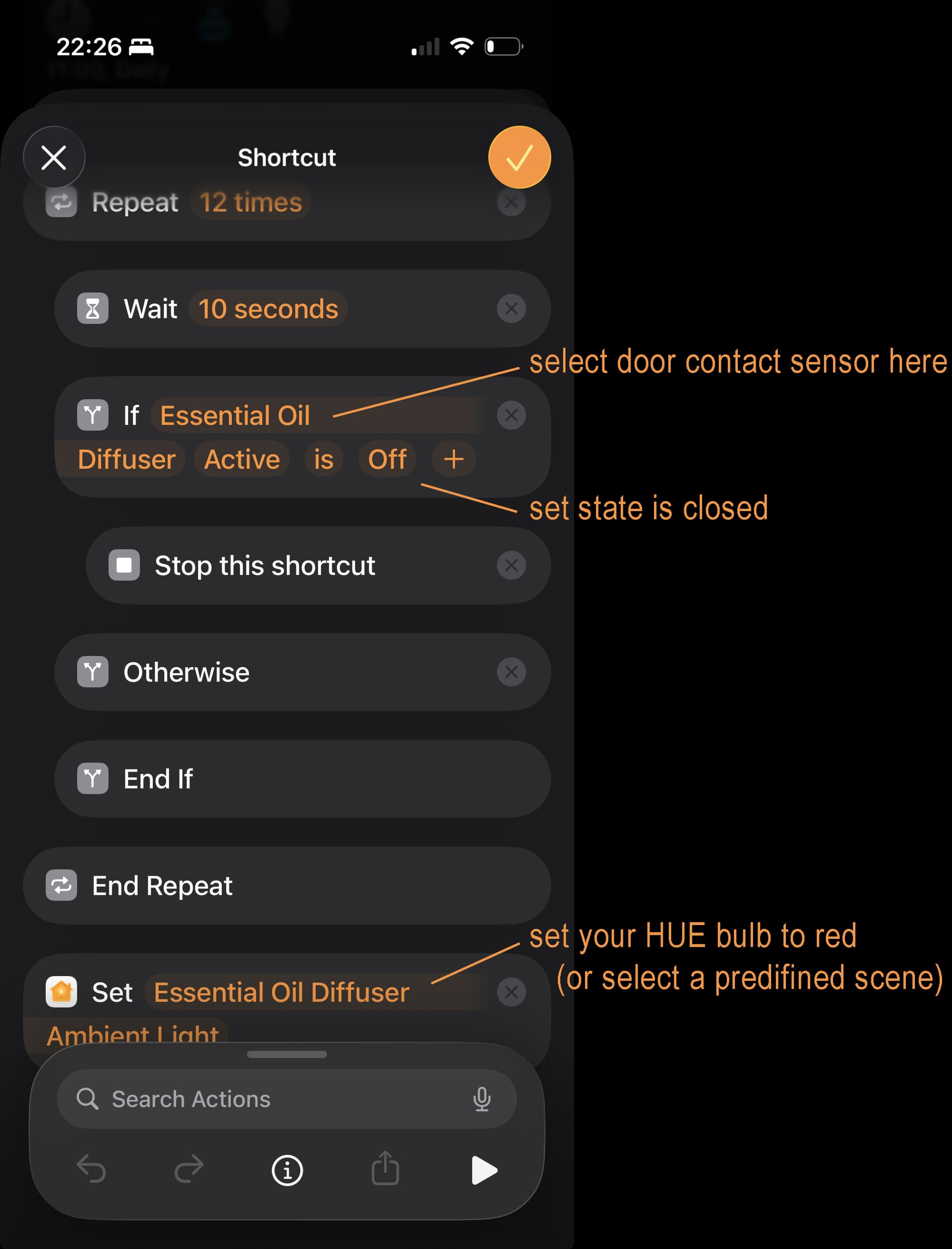

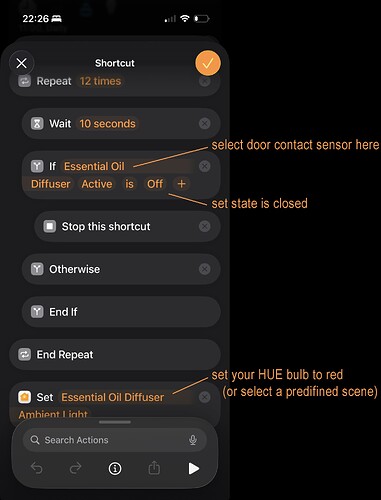

Hi, I’m not using any Google stuff and I don’t know Alexa’s capabilities, but in my ecosystem using Apple’s Shortcut built-in app it’s very easy. If you can write similar logic, than it should work.
-trigger: when front door open
-get variables of your bulb (like color, dim level, hue, saturation, whatever) by the time of door opened
-store the variables above
-run a repeat shortcut (2 min for eg. every 10 sec for 12 times)
-if door closed before 2 min expired: do nothing
-if door still open
-set your hue bulb color to red (scene also possible in Shortcuts)
-trigger: when front door closed
-set the stored variables to your bulb
Again, this is just to give a logic/idea to solve your automation wish.

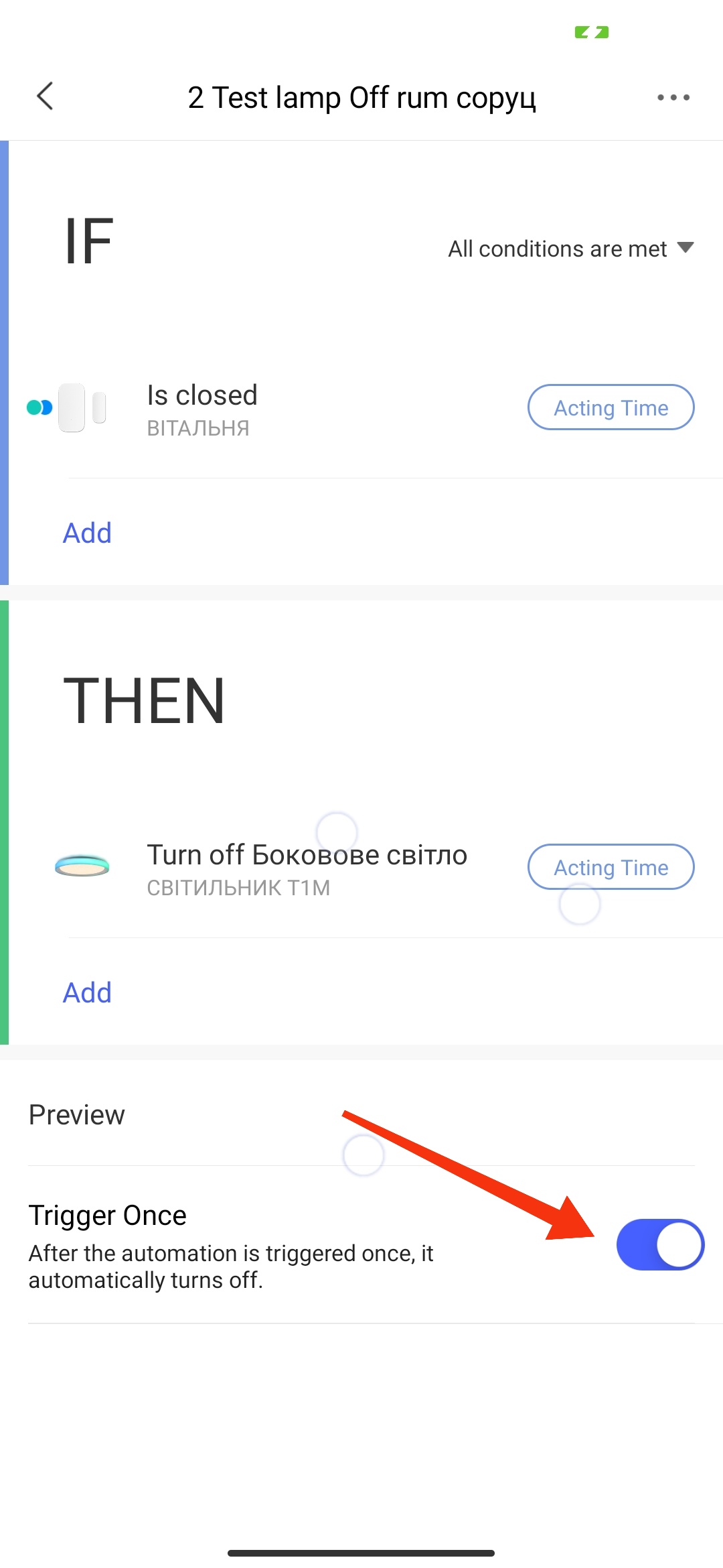

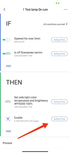

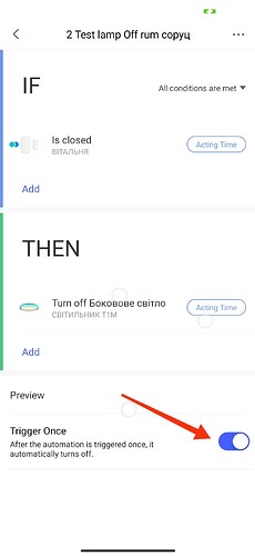

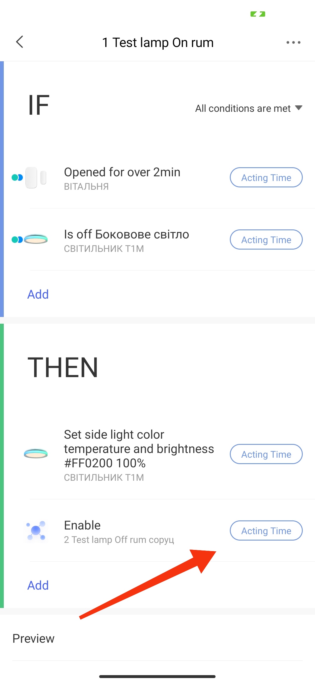

Hello. I made it on 1.0. 1 - if there is a light (turned on in the room) then someone is walking and working with the light, the door is open under human control, the red light is not on… 2- the light is off (conditionally there is no one) the door is open for 2 minutes, the red light is on (attention, the door is not closed). 3 - the door is closed, the light is off. The first automation turns on the second when there is a condition (the door is open, the light is not on). The second automation, the single-action mode is turned on, the door is closed - turn off the light. If I understood what you wanted correctly. Regarding your lamps, I do not know their settings in the automations.

Hi, interesting to use Apple’s Shortcuts I’ve never used them so far except of very simple activities. How can you get variable of the bulb and make any condition check of the sensor?
Hi, so let’s do it from the basics.
-Add new automation (in Home App, not New Shortcut in the Shortcut app!)
-Select Events (A sensor detects something > select your door contact sensor) than Next
-Select the conditions (open/close) than Next
-Select accessories you wish to participate in your automation, than at the bottom of this page push ā€œConvert To Shortcutā€ (note: I’m on iOS 26 Beta 6, as far as I remember you should be on iOS 18.1 or later to have this ā€œConvert To Shortcutā€ option available)
The Shortcut itself to monitor your door open for 2 minutes. If your sensor close within the repeat cycle than nothing happen and shortcut stops. If not closed than your bulb will do what you set up to do.
