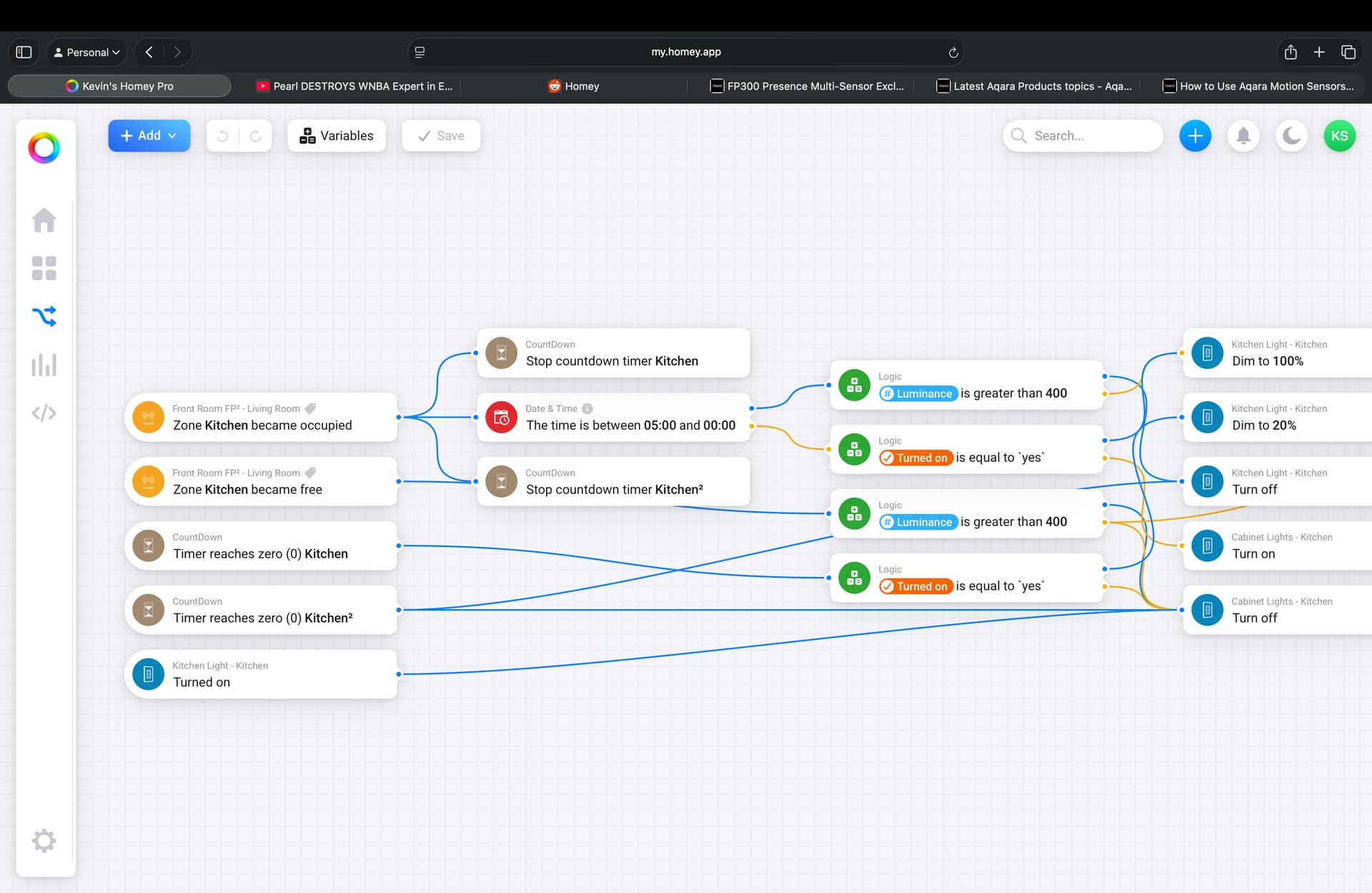

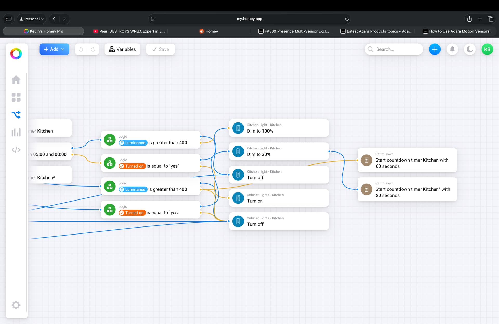

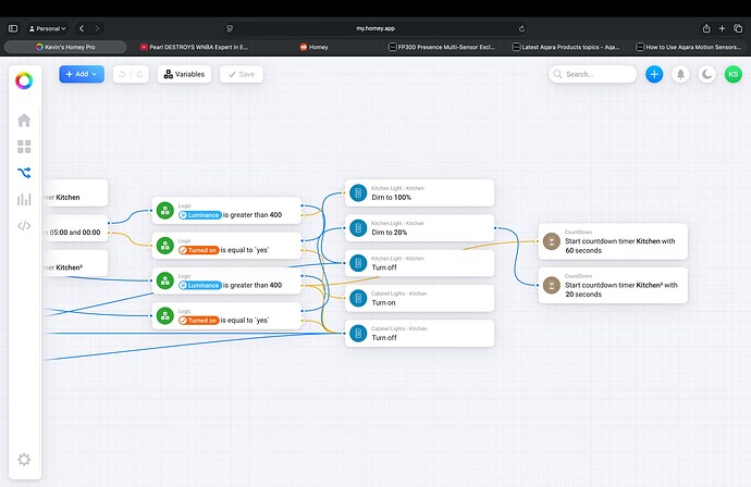

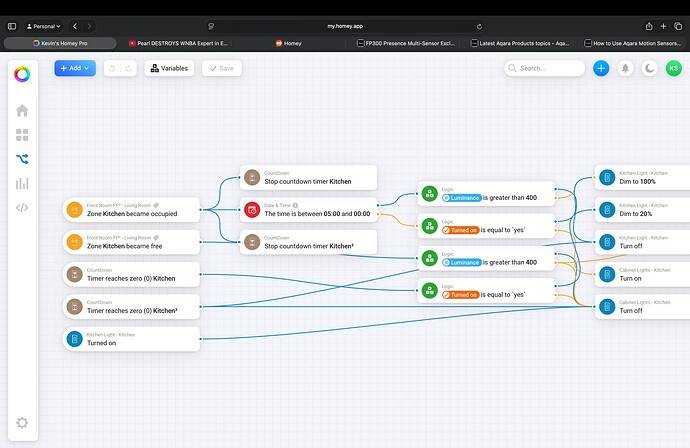

My best automation using the Homey Pro & Aqara FP2’s
