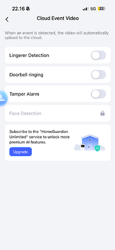

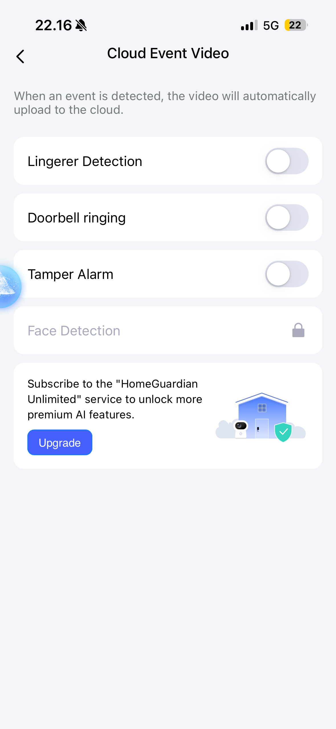

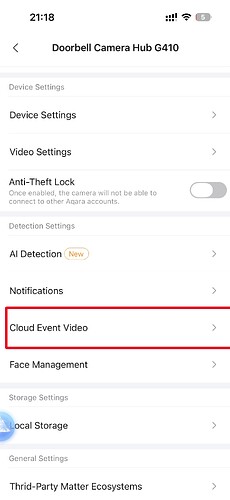

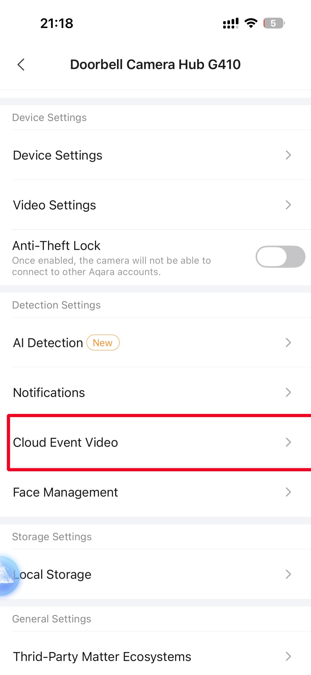

You can disable recording to the Aqara cloud in your camera settings in Aqara Home. Below is an example of how to do this using the G410.
So like this? Than all videos should go to HomeKit?

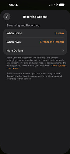

I have set up 9 cameras on Apple Home without using the Aqara app. Do not even have the app downloaded. Cameras are working great and have control of them without the Aqara app. But I am not seeing in Apple Home where to access the video even though the settings have them recording.

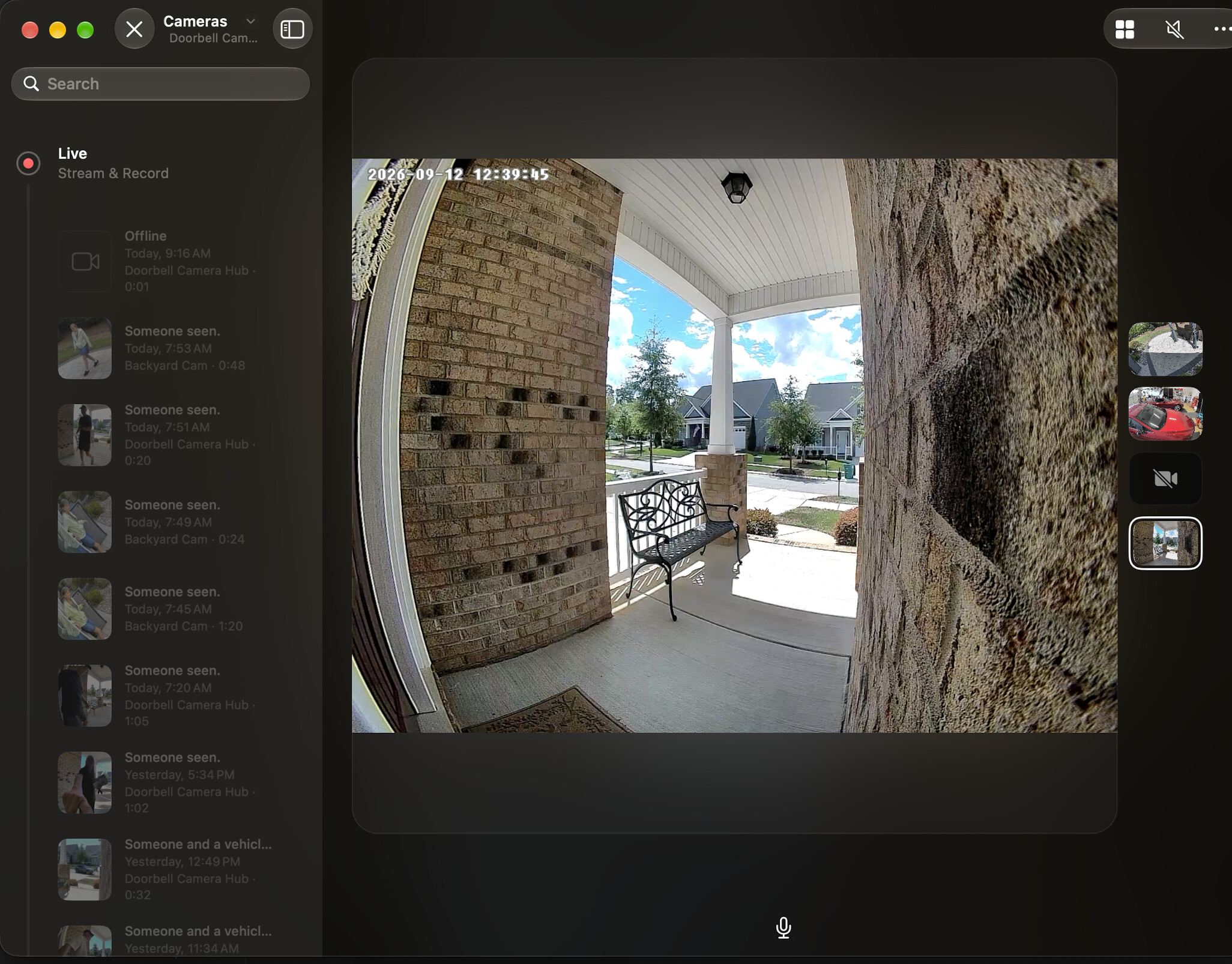

When you view one of your cameras, do you see the history clips on the side? Like this:
