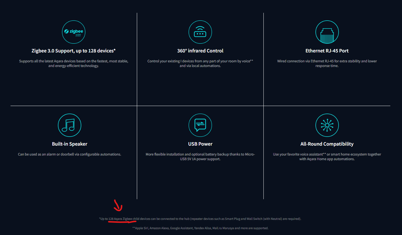

There is no direct trick to this. While you can physically put the M2 into pairing mode (by quickly pressing the button on the hub three times), it will simply ignore pairing requests from non-Aqara sensors (such as Tuya, Sonoff, or IKEA). Unfortunately, you also cannot connect Matter sensors to the M2.
Image Source: Hub M2 - Aqara
