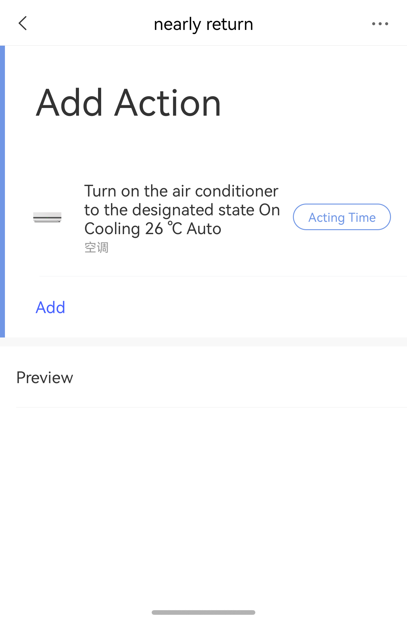

Issue 1: When you press the button on the app, the command will first be sent to the cloud server, then sent to the M3, and only then will the infrared signal be emitted. Therefore, when you press the button too fast, there will be a situation where the M3 cannot respond in time. It is recommended that you set up a scene to turn on the air conditioner to the preset mode and temperature, which can improve the success rate of your command execution.
Issue 2: When you synchronize the air conditioning mode to Apple Home, you will find that the temperature is fixed at 25.5 degrees Celsius. This is because your M3 is not connected to the temperature and humidity sensor, and the program has set a fixed temperature.
Therefore, suppose you give Siri an instruction: Turn on the air conditioner and set the temperature to 26 degrees Celsius. Siri will determine that 26 degrees is higher than 25.5 degrees Celsius. Therefore, the final instruction it will issue will be: Turn on the air conditioner, set to heating mode, and set the temperature to 26 degrees Celsius. Even if your intention is to save electricity for the air conditioner, it will stubbornly insist that this is the desired temperature for the room. The suggested approach is that when you set up automation on Apple or give instructions to Siri, break it down into multiple steps: Hey Siri, turn on the air conditioner; Hey Siri, set the cooling mode to 26 degrees Celsius.
