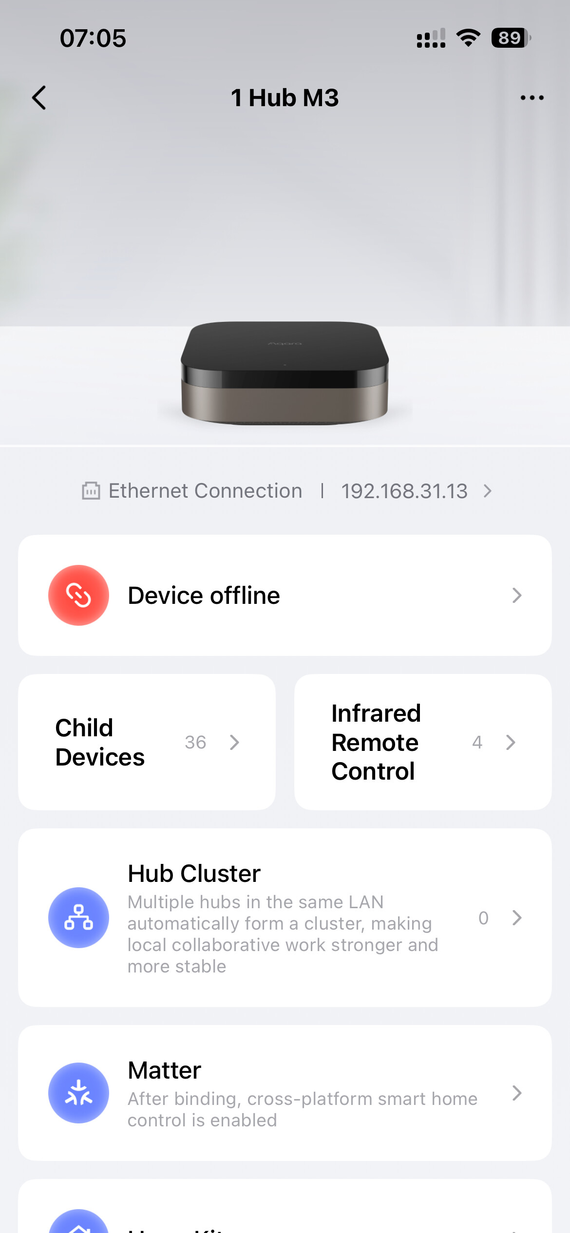

Currently i use power and network through POE lan hardware
Currenlty

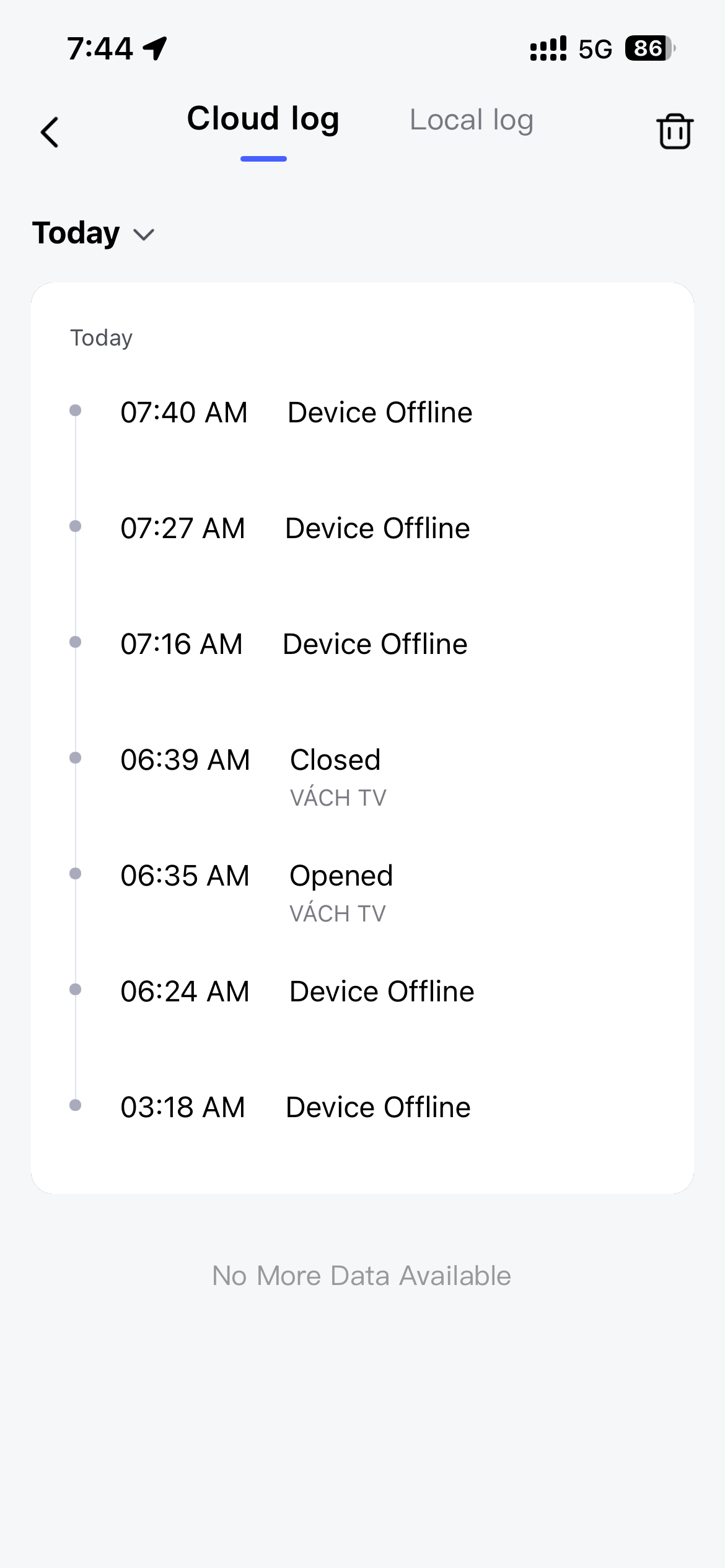

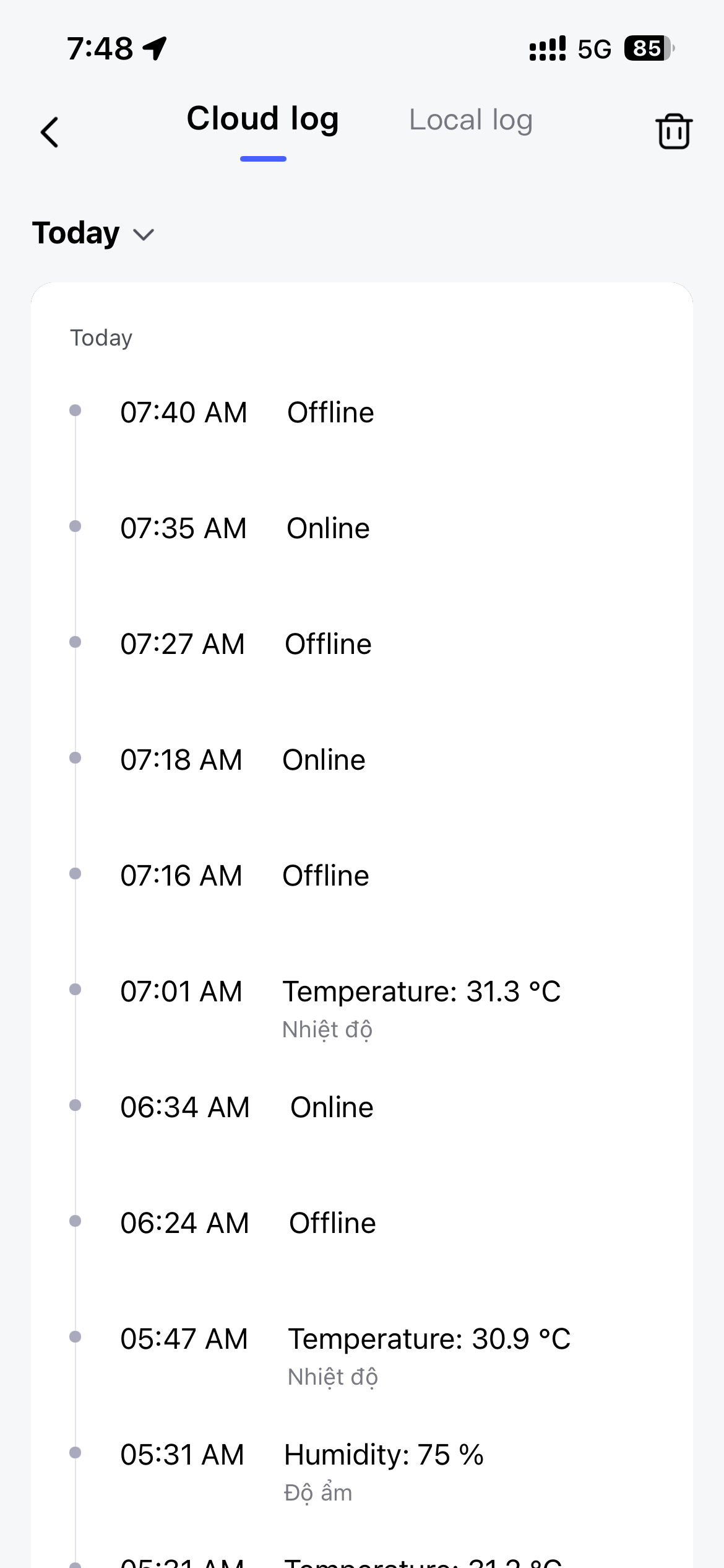

It restart repeatedly several times.
And it back to normal after nearly 1 day keep offline without any action such as remore POE switch or connect by other power adapter.

1: hardware E-net plus power through POE
2. Actually i have no chance to do it. Then it was back after nearly 1 đay without any action
3. Surely during offline no have any led indicator
That is not normal as i have an M3 too but doesn’t have issues vreun offline or something.did you check your internet when the M3 goes offline?as my be it is also your internet provider that have issues there.but if is not your internet ether the problem you should contact aqara support.still you should check it vía wifi and conect it to an USB and see if the problem still continue.as personally i am using it vía wifi and i Connect it to an Apple charger via USB type and works perfectly
