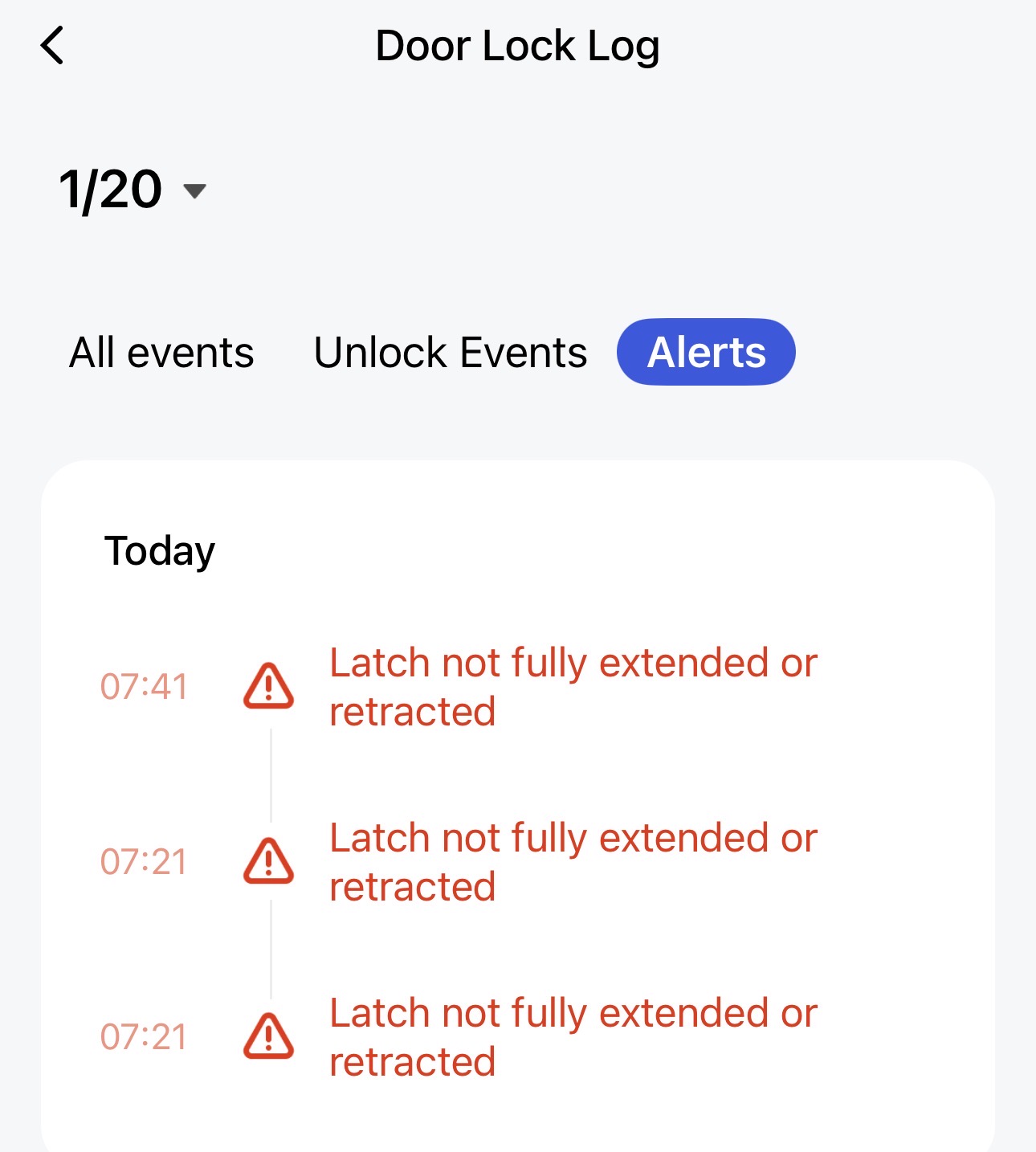

In the Aqara app “Door Lock Log” (Alerts tab), I regularly see alerts such as:
• “Latch not fully extended or retracted”
(I attached a screenshot.)
This alert is important because it indicates the lock tried to lock/unlock but the bolt/latch did not complete travel (for me this often happens in winter when the security door doesn’t fully close).
However, when the lock is bridged via Matter into Home Assistant, Home Assistant does not receive any equivalent fault/alert state or event. HA typically only shows the basic lock state (locked/unlocked), and when a lock attempt fails, HA just remains “unlocked” with no distinct “jammed/fault/operation failed” signal I can use for automations/notifications.
