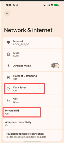

Based on what you described, this issue is very likely related to mDNS (local network discovery) . After the network credentials are sent to the Matter device, the phone needs to re-discover the device on the local network. If mDNS traffic is blocked or restricted, the process may remain stuck at this step.
On Pixel devices with Android 16, certain network protection features may interfere with this. Please try the following:
  1. Go to Settings → Network & Internet
    Turn Data Saver off (if it is enabled)
  2. Go to Settings → Network & Internet → Private DNS
    Set it to Off ( not a custom DNS)
3.Go to Settings → Network & Internet → Adaptive Connectivity
And it’s better to turn Adaptive Connectivity off as well, if necessary
And it’s better to turn Adaptive Connectivity off as well, if necessary ,
After changing these settings, please restart the Aqara Home app, or if needed, reboot your phone , then try the Matter pairing again.
It’s funny that it only effects the new IKEA thread devices.
It doesn’t change anything. I tried it now. My settings were like that anyway.
