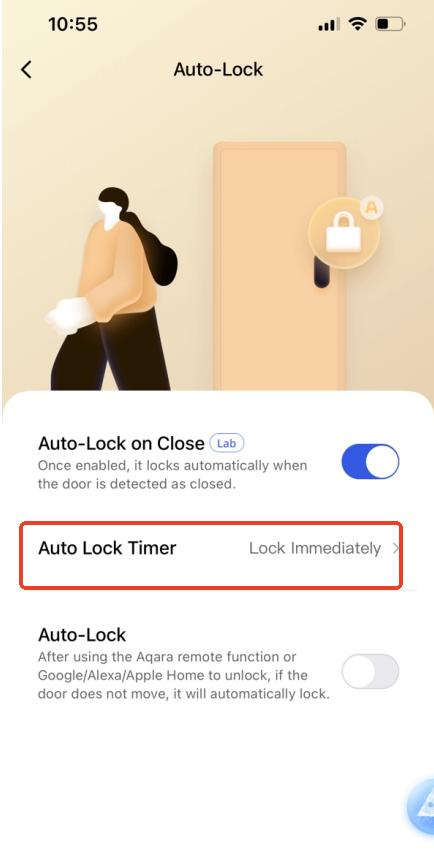

Hi Jacob, have you tried this Time feature already?
@SiyuBot, yes. That is the feature that is not working reliably for me. There are two main scenarios where it fails.
The Auto-Lock on Close feature routinely doesn’t detect that the door was opened and closed (and the proprietary security system contact sensor automation intermittently doesn’t work), so I leave the house and the door stays unlocked. The Door Left Unlocked Alarm goes off, but since I’ve already walked away, I don’t hear it. I’ve tried recalibrating the lock multiple times with different door open angles, and it hasn’t seemed to fix the issue.
The other scenario is where someone will unlock the door manually and not open it. When this happens, both current Auto-Lock options do not lock the lock. The door isn’t opened, so Auto-Lock on Close won’t trigger (neither will the contact sensor) and the other Auto-Lock feature only triggers if the lock is controlled remotely by app.
What I would like is an Auto-Lock feature that always locks the door after it’s in an unlocked state, regardless of what method the door was unlocked by (manual turn, key, app, Matter, keypad, etc.). This could be a separate timer, or it could just be an option to extend the existing Auto-Lock timer feature to all unlocked states, instead of just when unlocked remotely by app.
