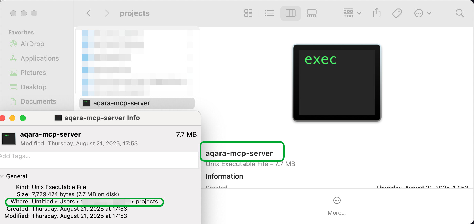

  2. In the claude_desktop_config.json, what do you mean by “/path/to/aqara-mcp-server”? Do you have a real patch example? Do I need to point to a path only or to a file?
Thanks for your support. Let me help you resolve these issues:
  1. There are no specific devices required; the only requirement is that you have registered an Aqara Home account.
  2. The “/path/to/aqara-mcp-server” refers to the absolute path of the aqara-mcp-server executable file on your PC.
    For example, if I saved the aqara-mcp-server in the project folder, the path should be written as:
    /Users/*****/projects/aqara-mcp-server
Feel free to ask me if you have any questions.
