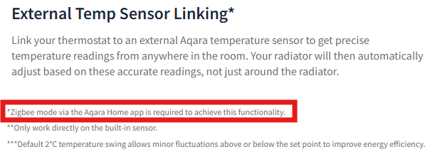

Unfortunately, you can only connect an external temperature sensor directly to the W600 via the Aqara app.
Image Source: Aqara Radiator Thermostat W600: Efforteless Comfort Control
However, with Zigbee2MQTT, you could set a value to external_temperature_input via an automation in HA. Unfortunately, I don’t know if this also works via ZHA.
Bear in mind that manufacturer hubs are designed to work seamlessly. When pairing devices with Home Assistant via a Zigbee coordinator, however, you can’t assume that everything will function exactly as it does with manufacturer hubs. Many tasks that are automatically handled by the hub’s software (such as the use of an external temperature sensor) must be implemented manually in HA.
