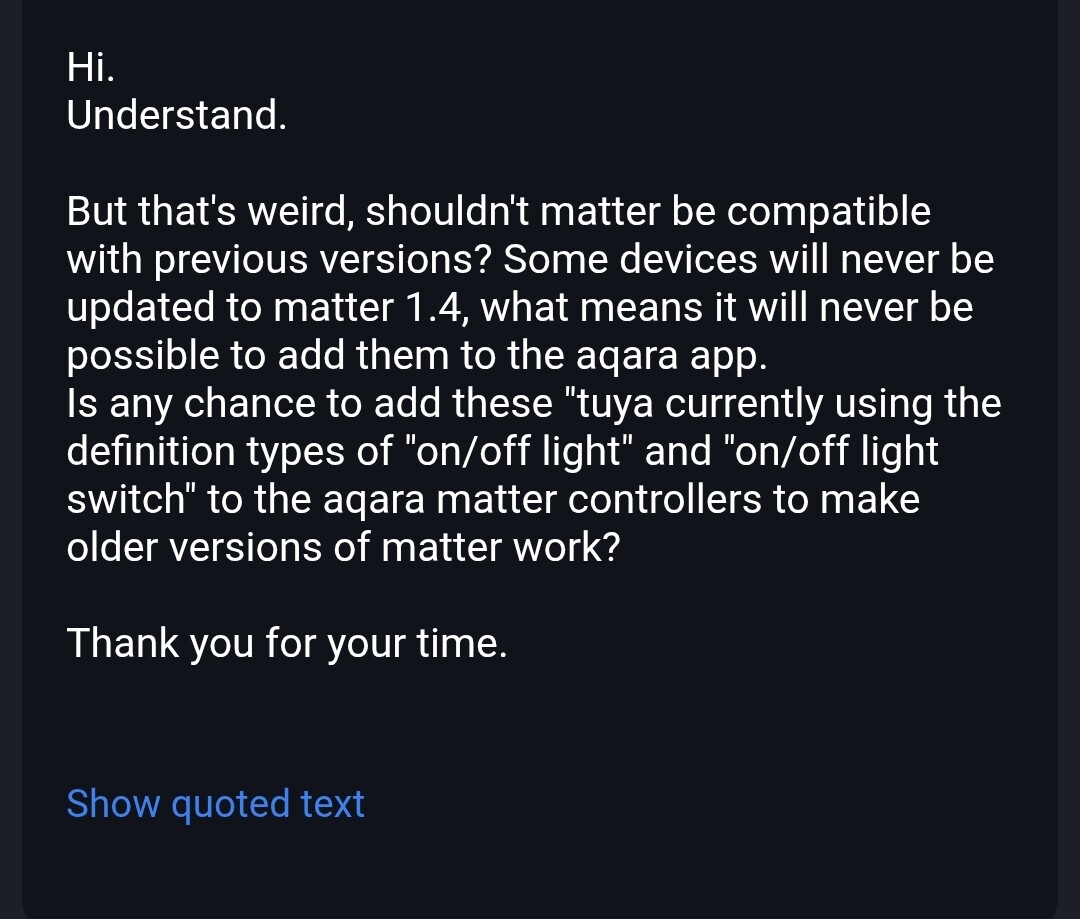

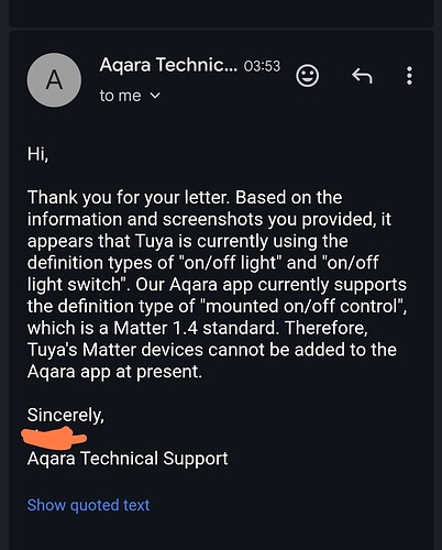

Is it real? "on/off light" and "on/off light switch" not supported in aqara app
Shouldn’t it be compatible with previous versions?

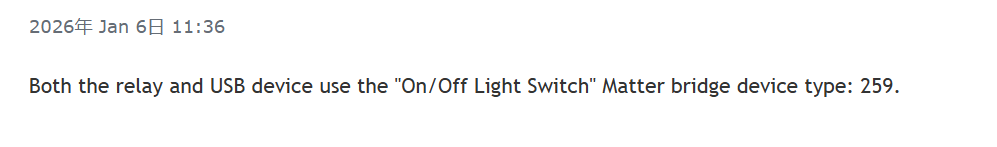

Do I understand this correctly? Your device identifies itself as Matter Device Type 259 (On/Off Light Switch). Other systems (like Google) accept this mismatch and effectively bind it as Type 256 (On/Off Light) because it has the on/off capabilities.

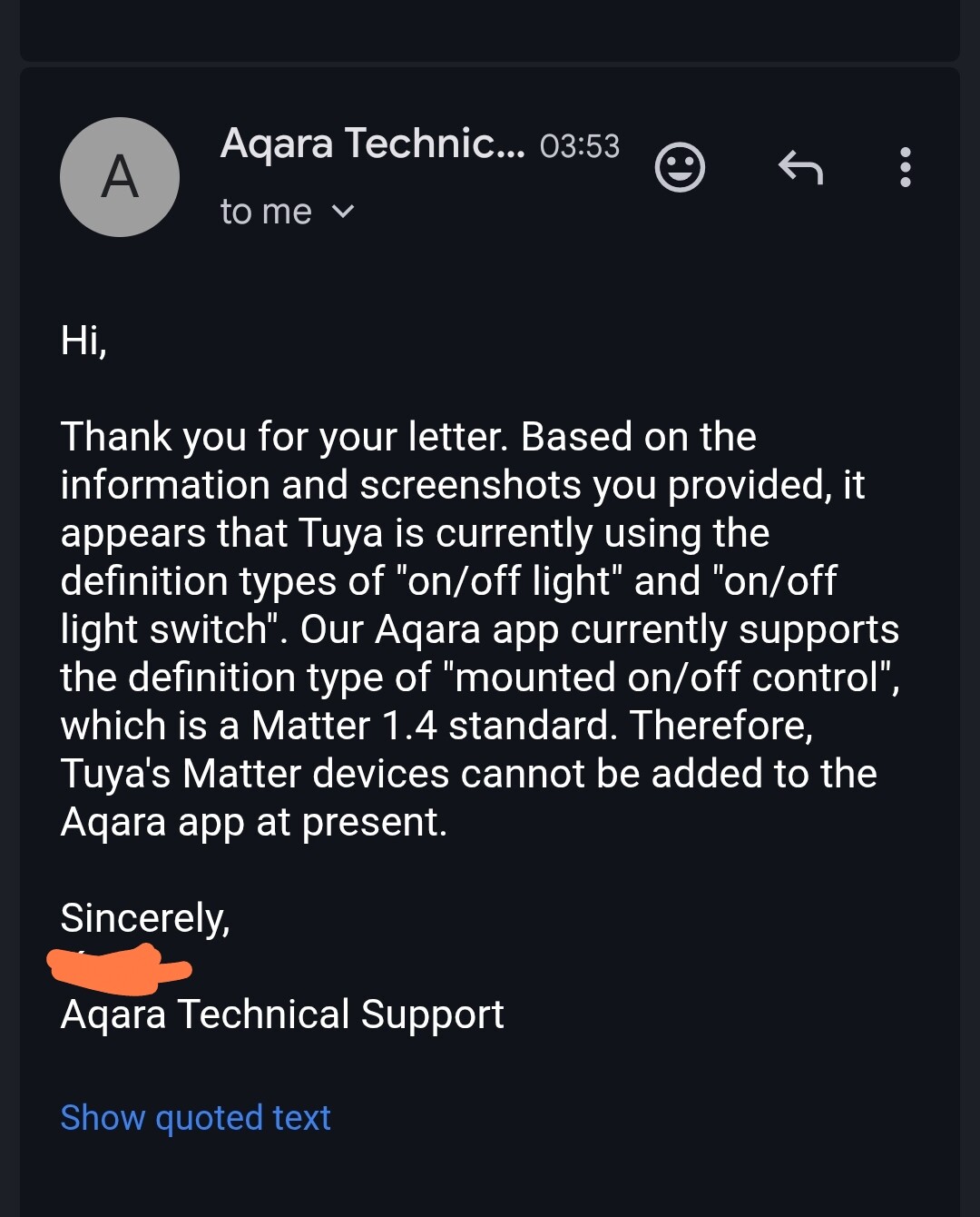

The Aqara Support email is essentially saying: No, we won’t do that. We will only support this kind of device if it correctly identifies itself as Type 271 (Mounted On/Off Control).

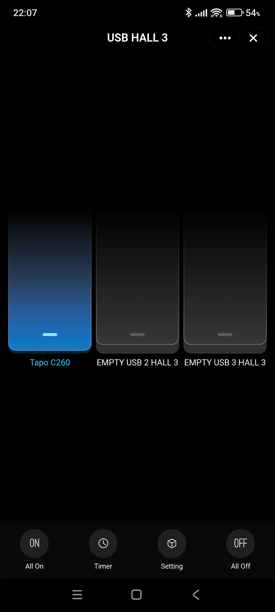

So how they supposed to expose them to make it work with all platforms?

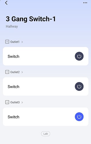

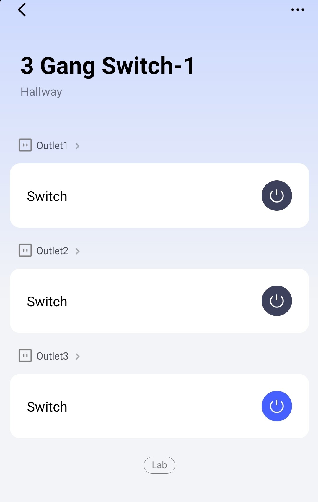

Thanks I asked them to expose that relay as on/off light and that usb as On/Off plug unit.
Will “on off plug in” expose these 3 on/off?
I don’t know, do Matter power strips or dual outlets display correctly in Aqara? Those are also on/off plug-in units.
No idea, we will see then, thanks a lot <3
Thanks, they changed it, and everything is working now.
