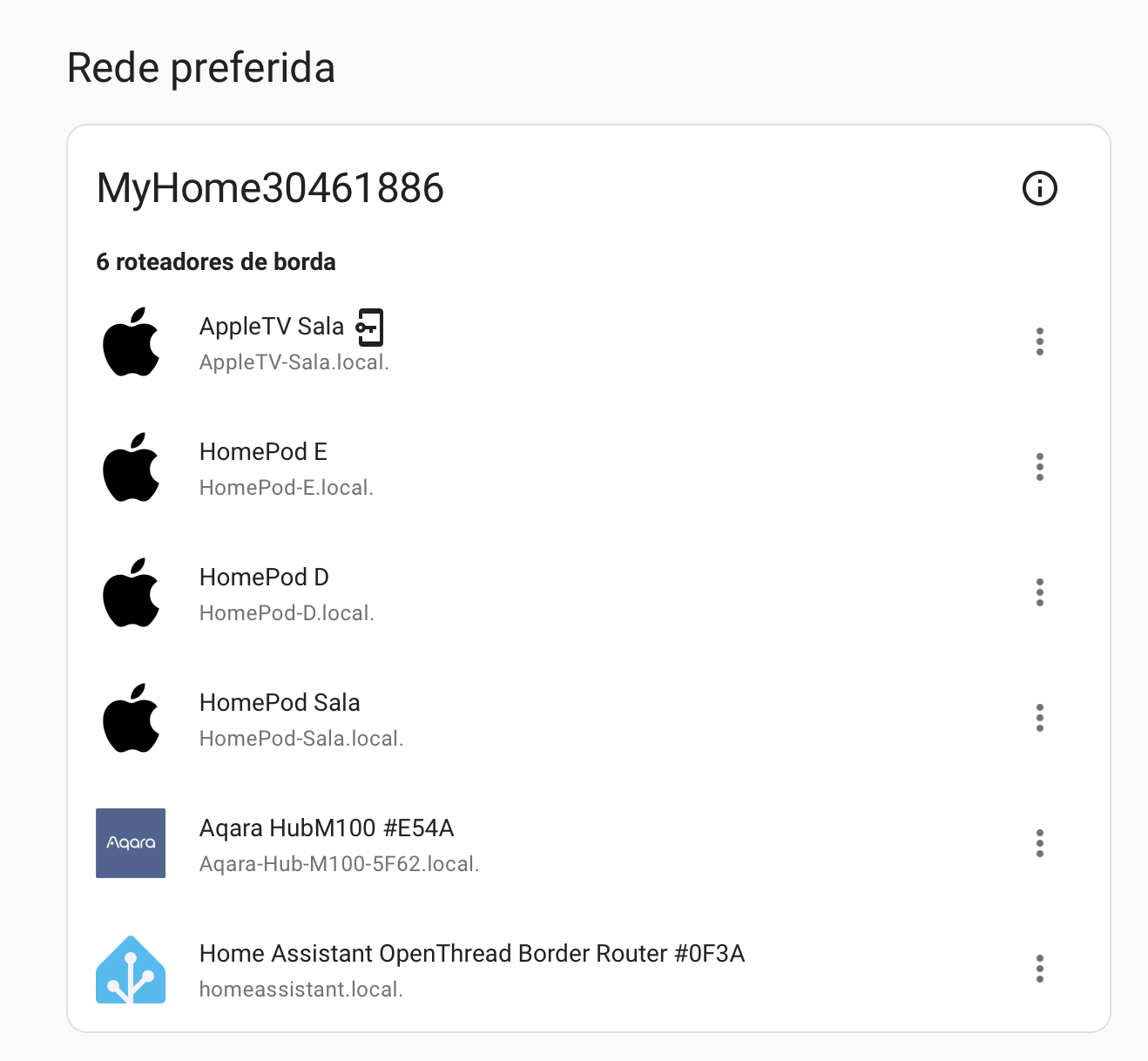

That’s not true. M3 and M100 joins on Apple network too!
Here’s my M100 and Home Assistant dongle at same Apple Home network, called as MyHomeXXX
