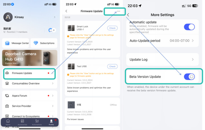

Hi Could you please provide a video of the door lock calibration? We can have our engineers review it to see if there’s a solution. Additionally, if you share your Aqara account with us, we can add it to the whitelist, allowing you to upgrade the firmware to version v84.

Hi,v84 firmware version is now open for all aqara users. I noticed that you have a UK door lock, which we improved with v77 firmware with the aim of making its auto-calibration more accurate. If you have any issues after updating to v84 please feel free to contact me and we will assist as soon as possible! (My email: Kinsey.yu@aqara.com)
