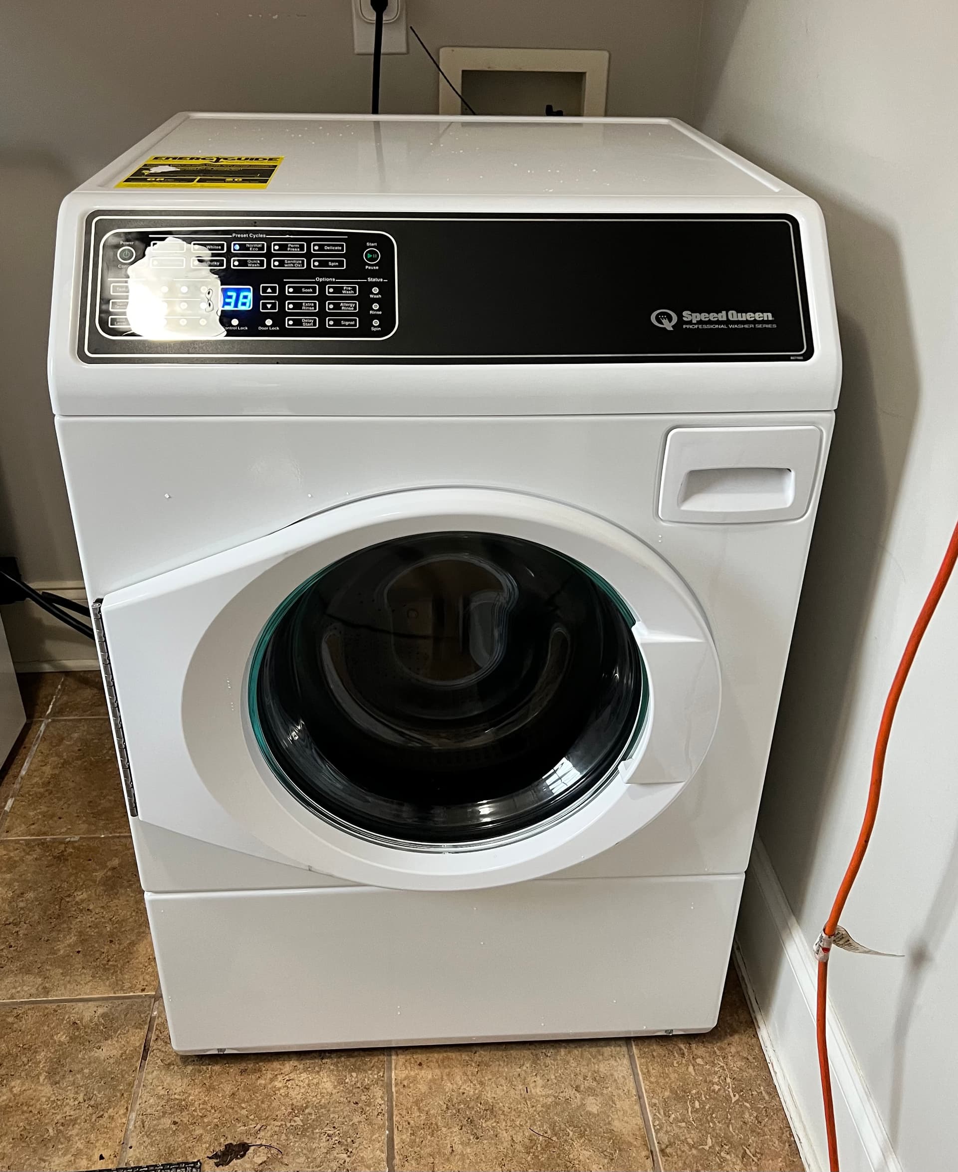

  1. Pair your T1 and place your T1 on the side or back of your washing machine and test it’s sensitivity. I have mine set to Low with a reporting interval of 5s.

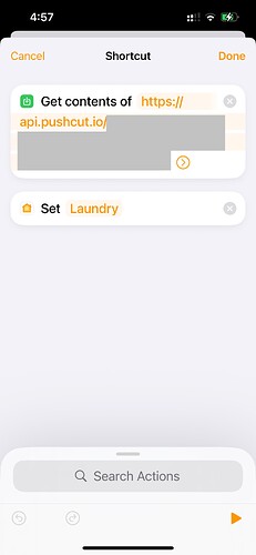

  1. Create a shortcut that will run certain actions when triggered. For me the shortcut can do two things depending on the scenario. If I am at home, it can set a 10 minute timer to remind me about the laundry. If I am not at home, it will set a reminder that will trigger when I arrive at home. It looks like this:

  1. Apple Home, now create an automation with Convert to Shortcut. When “Washer Running” [this is the virtual switch created from your Home Assistant Input Boolean] turns off, Run Shortcut.
The shortcut calls my PushCut URL triggering my Reminder, and also sets a laundry scene that can change a lightbulb blue or send an audio file to my HomePods if needed.

  • I did at one point use a power monitoring socket to do this automation. My new washer has too many options with varying power draws that made this now inconsistent.
  • Finally, the T1 vibration sensor makes the difference here. The original vibration sensor was not quite sensitive enough for this task.
