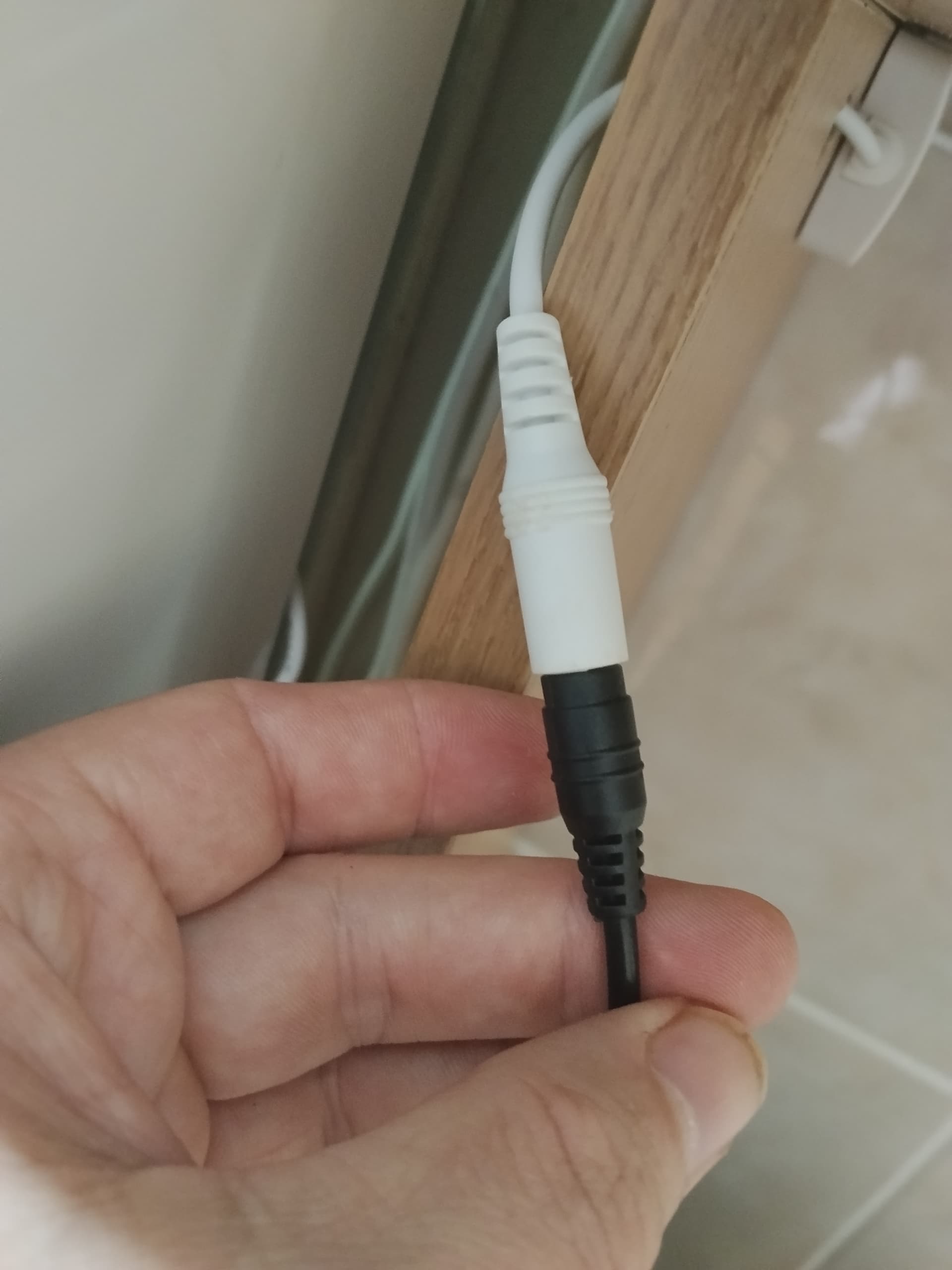

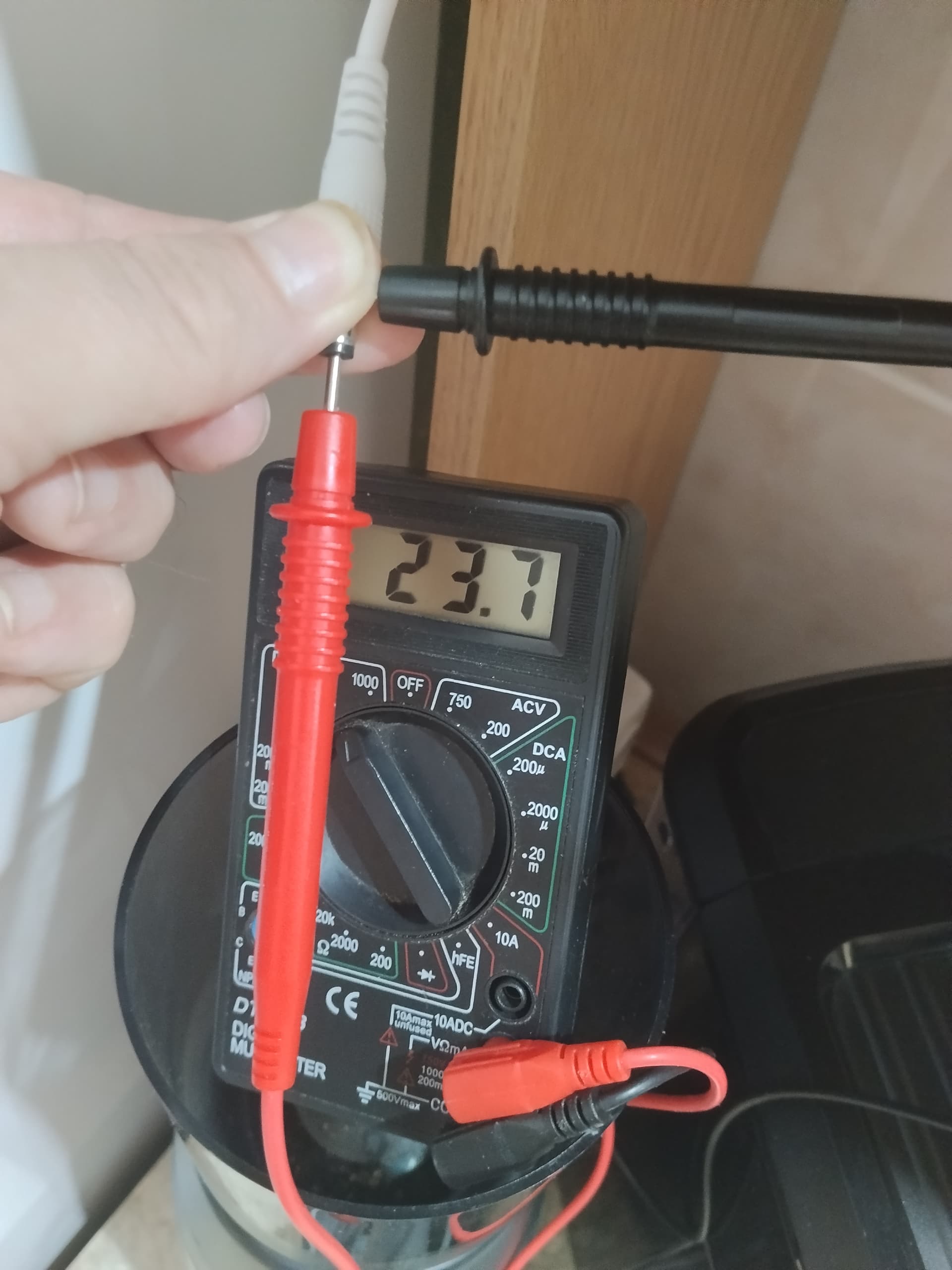

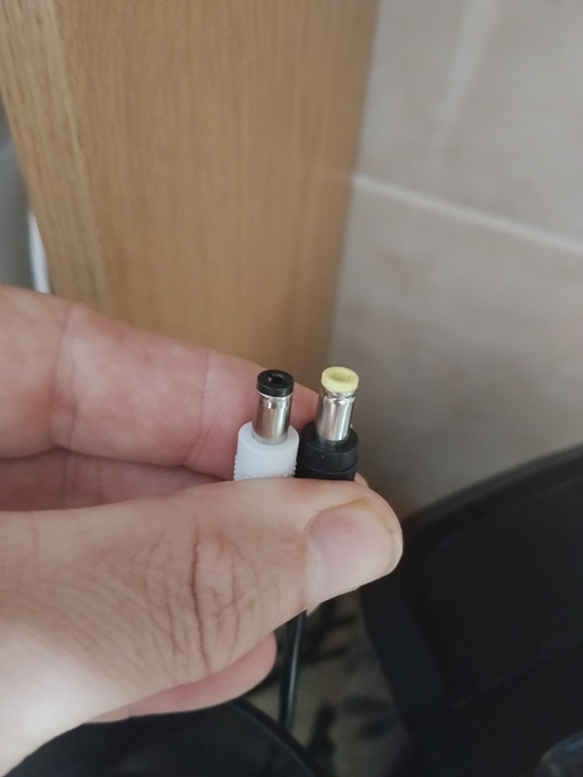

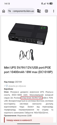

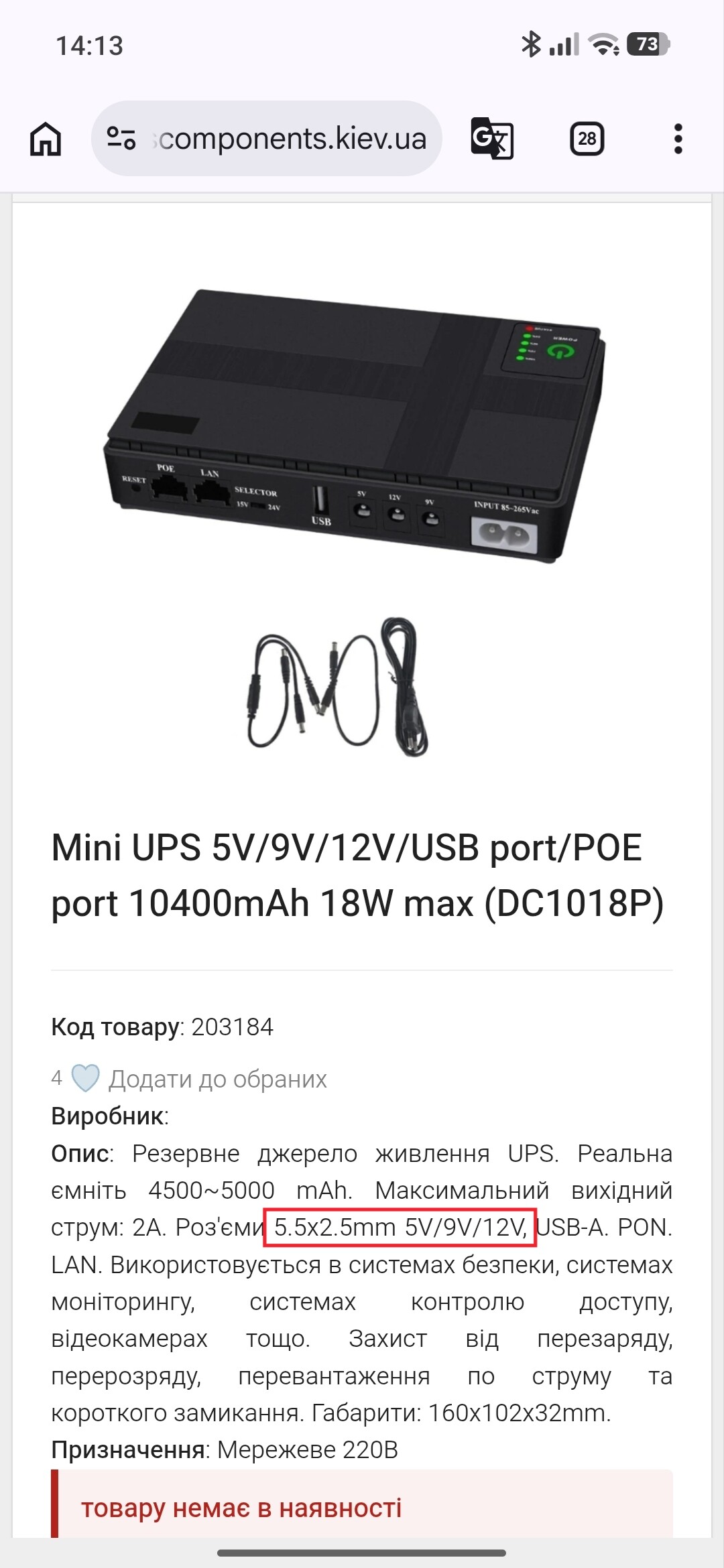

Hello, welcome to the forum. Power supply voltage ~24.0 volts. Center “+24”. Size 5.5x2.5. I have a spare adapter for a mini UPS, I checked it. I’m adding a photo for clarity.
