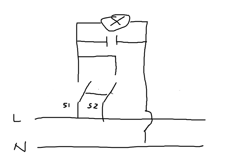

I tried connecting both but as soon the S1 switch on, because on the S2 there will be no ΔV, it turns off.
With the capacitor this shouldn’t happen.
What capacitor did you use for you, I have no idea where to start

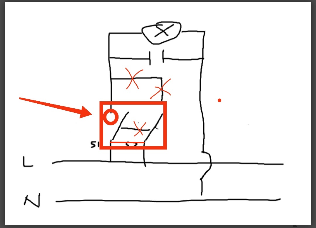

Do you mean like this?
Hello.
Theoretically, at this point in the H2 switch, voltage is supplied through the capacitor to power the switch (constant power for the operation of the control and management system). You can experiment to see which point of the switch (1 or 2) you need to supply the wire from the capacitor to make the switch work when the light is off (load on the lamp).

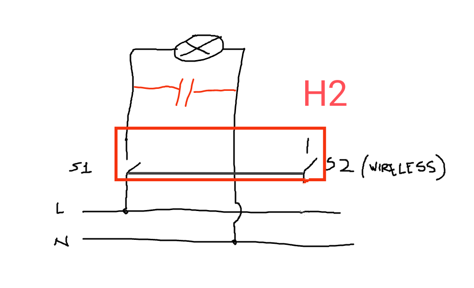

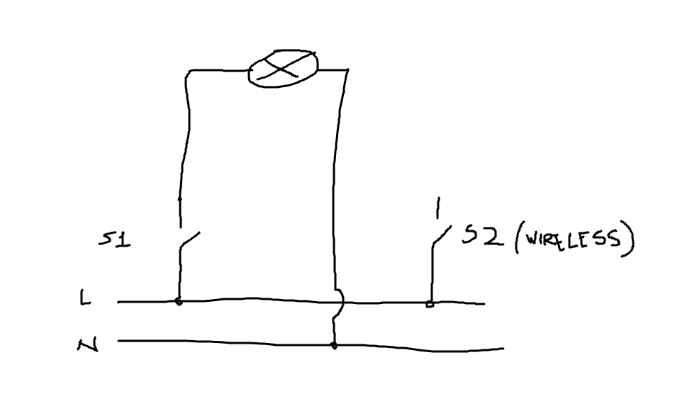

Just to be clear, both switches are H2, I just want to use one of them in “wireless” mode for a two-way set-up.
I will try
That’s how I understood it, so I adjusted your scheme for your situation
