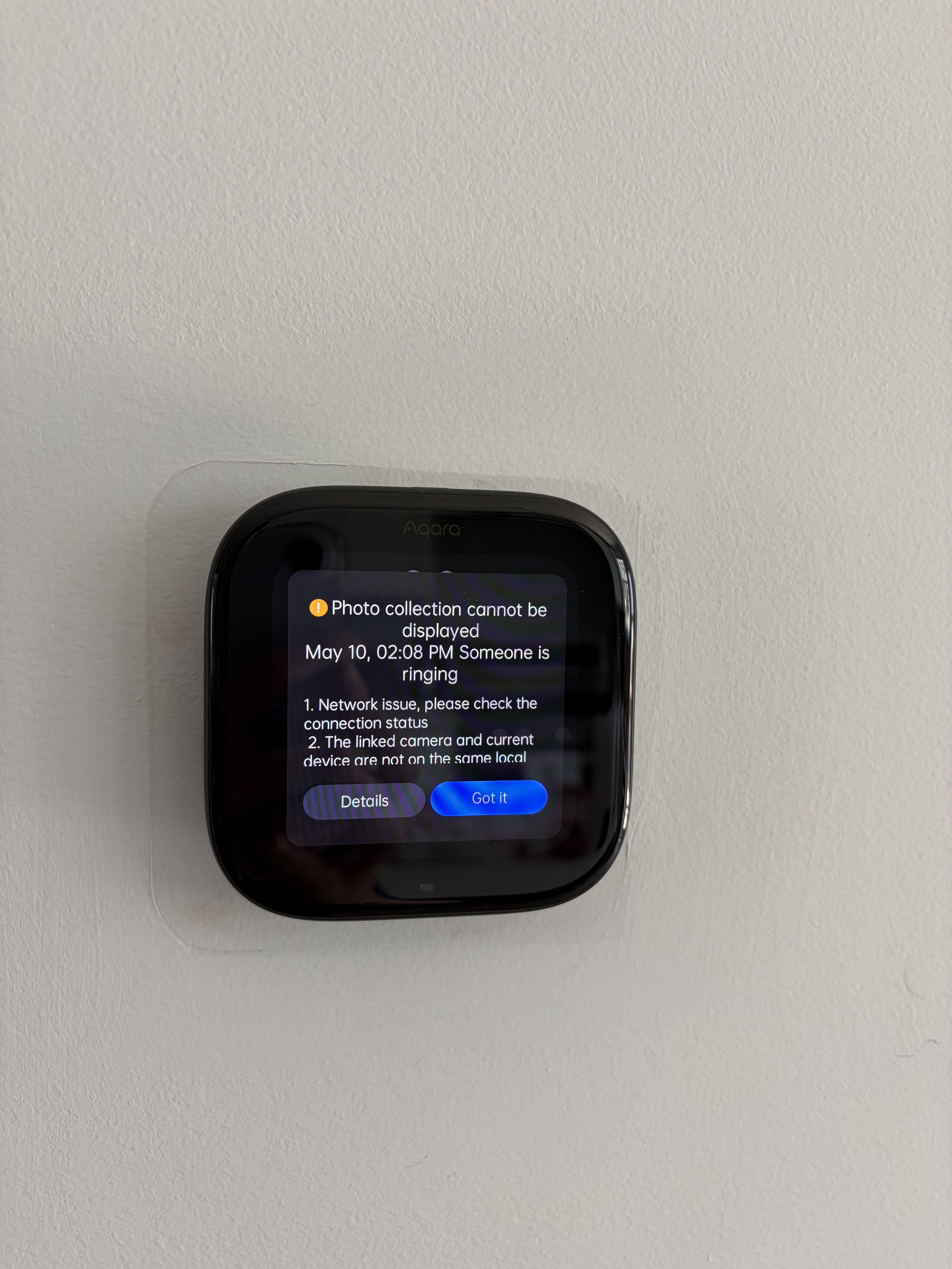

I received purchase 3 W200 thermostats for my home (3 zones in my house.) I linked all 3 thermostats to my G400 and U400 for the snapshot feature. It looks like only one of the thermostats is showing the preview and option to unlock the door. The other 2 thermostats displays a “ Photo collection cannot be displayed” error. Does this feature only work with one W200 thermostat or am I doing something wrong?

Unfortunately I still have the same issue. It still only works on one of the thermostats. The other thermostats still gives the same error.

This is resolved with the latest G400 update. Thank you!
