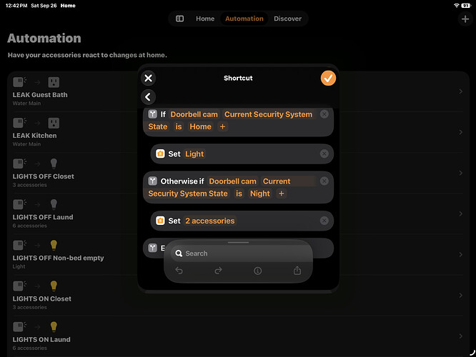

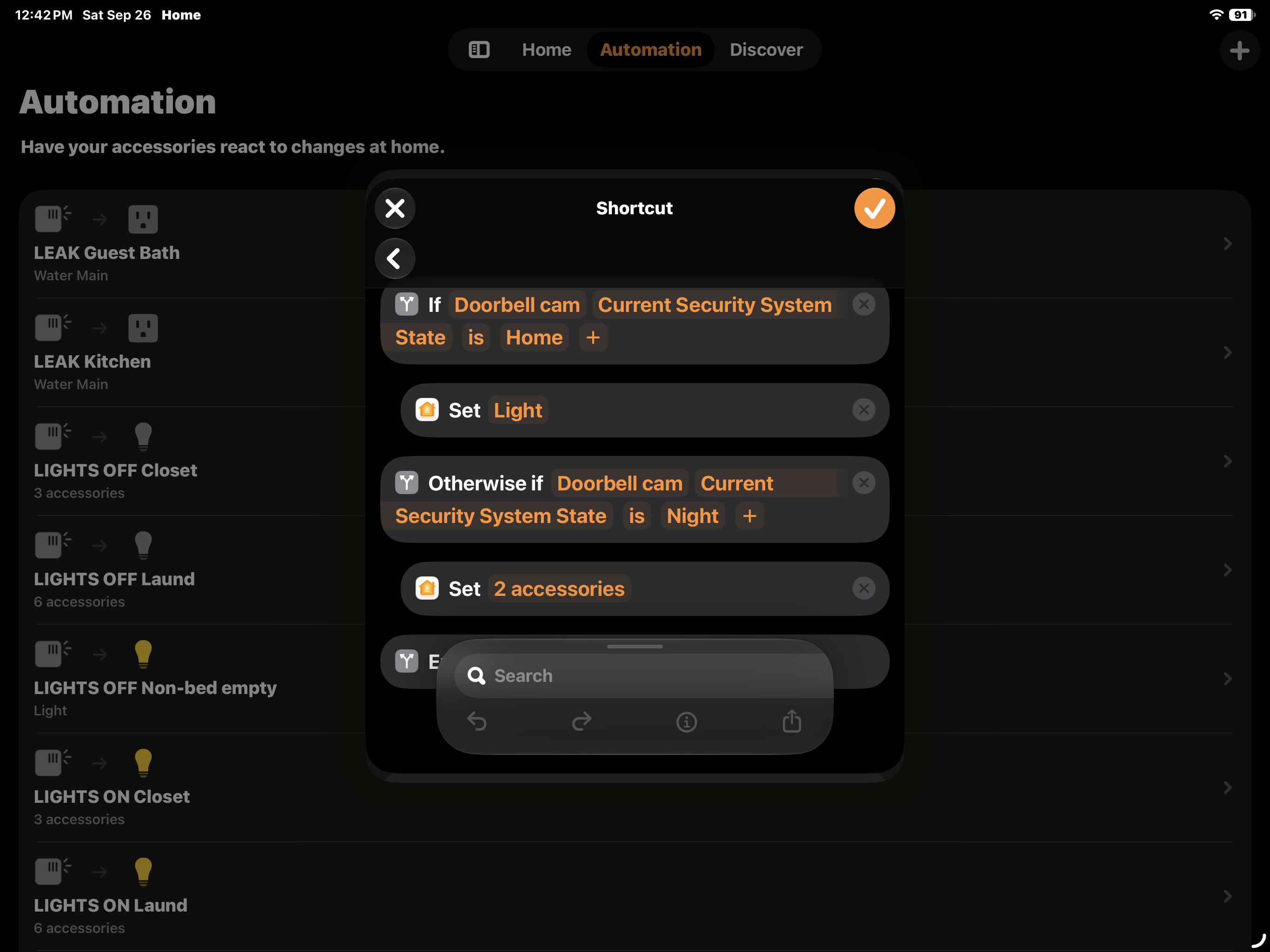

While it’s not the most natural or obvious interface, conditionals in Apple home are pretty good.

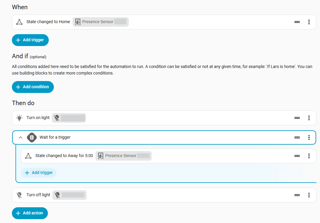

That can also be implemented in Home Assistant.
The easiest way is something like this:
Or, a slightly more complex approach using a timer (helper) that is reset repeatedly. But this actually makes more sense if you have multiple conditions or sensors that keep increasing the timer.
However, it still must be said that if the mmWave sensor is unreliable and doesn’t detect you for a longer period of time, a timeout will probably expire anyway. Does the sensor only fail to detect you for short intervals?
