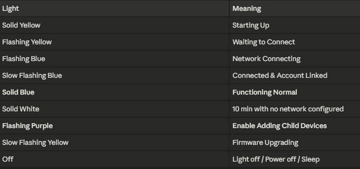

Added a 2nd M100 Hub; it is attached to WiFi and Homekit. Now every time I try to add a child device using the Aqara App, the M100 immediately changes from solid blue light to a blinking red light, and no chiuld device is ever added. Firmware is up to date. Any idea what is happening ?
Good morning, I’ve reviewed the M100 manual and don’t see any documented indicator lights for a red blinking light.
  1. Any chance it is blinking purple and not red? Blinking purple is the correct state for adding a child device.

Hi @ssc4me , the indicator light isn’t red, but purple, and that means the hub is searching for Zigbee devices. What device are you trying to add to the hub? Is it an Aqara Zigbee device?
