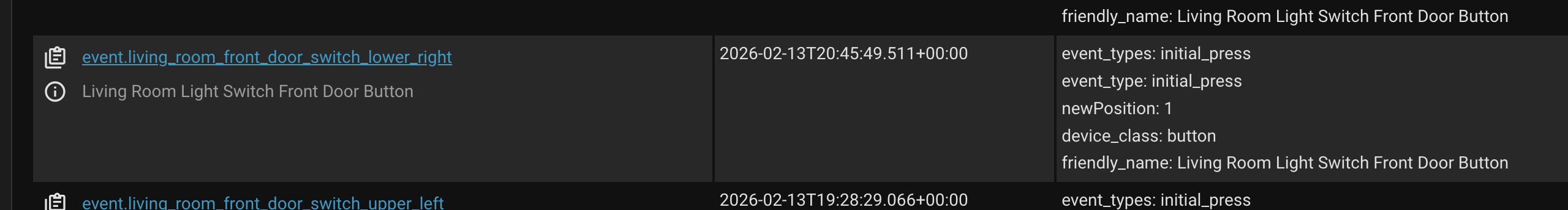

  4. Check event entities for H2 in HA → only initial_press available
  5. Double-click H2 lower button → Aqara Home shows “double click” in logs, but HA receives nothing

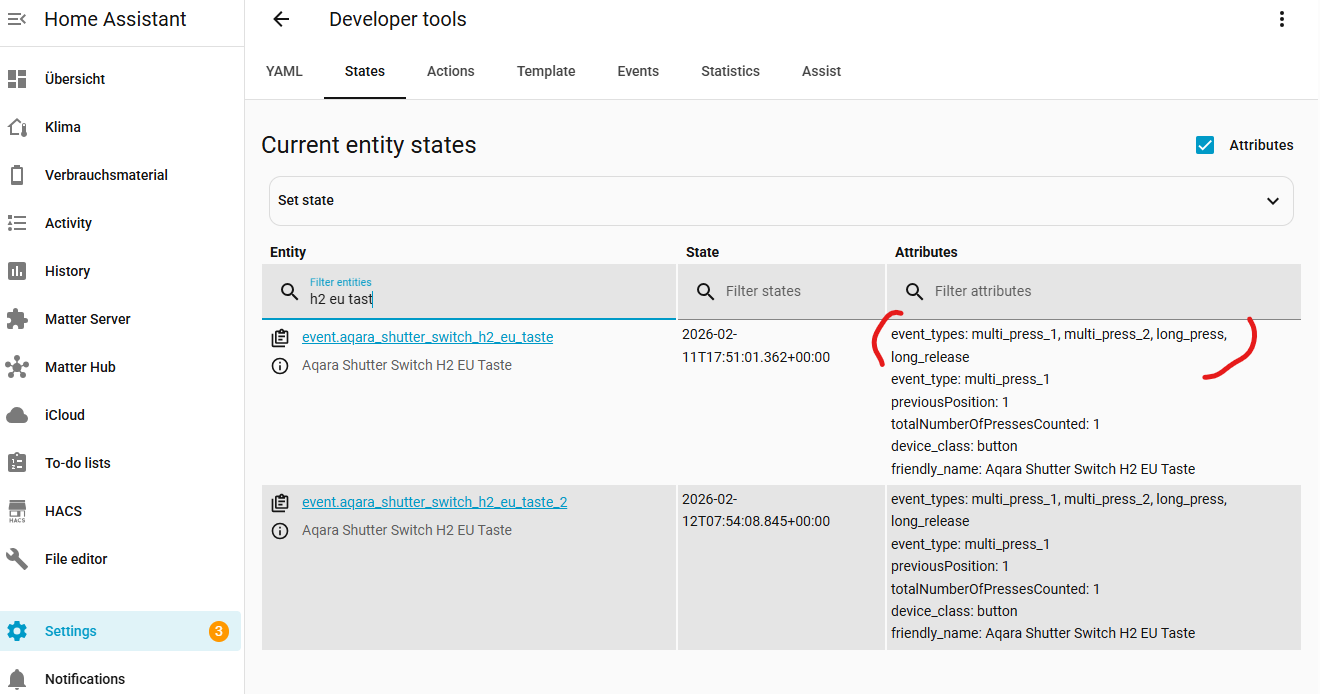

How exactly did you determine that?
a) Have you checked in (“Settings” ->) “Developer tools” → “Current entity states”?

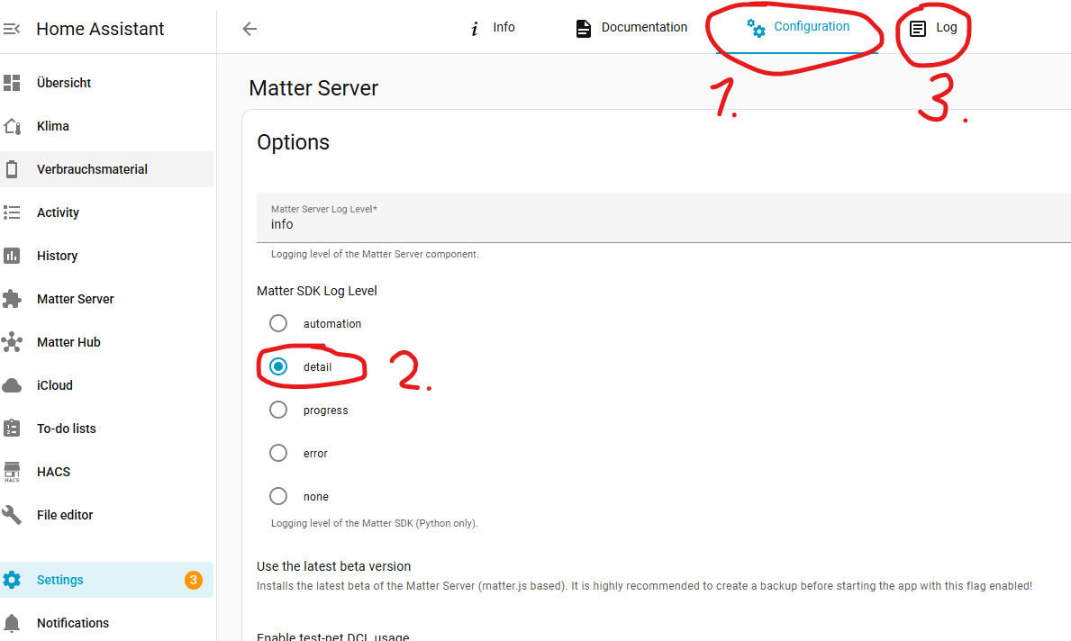

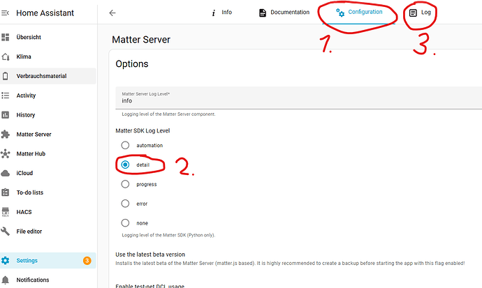

b) Or have you looked at the Matter raw data in “Settings” → “Apps” (formerly add-ons) → “Matter Server” → “Log”
If you have set the logs to “Details,” you must restart the add-on or app and then switch to the “Log” tab. Wait a moment until there is no more activity in the logs, then double-click the H2 button to view the raw data in the log. Can you show us the data here?
I see in your screenshots that you have a shutter switch, and maybe the issue is only present in case of H2 switch (2 or 4 channel) and H2 dimmer switch?

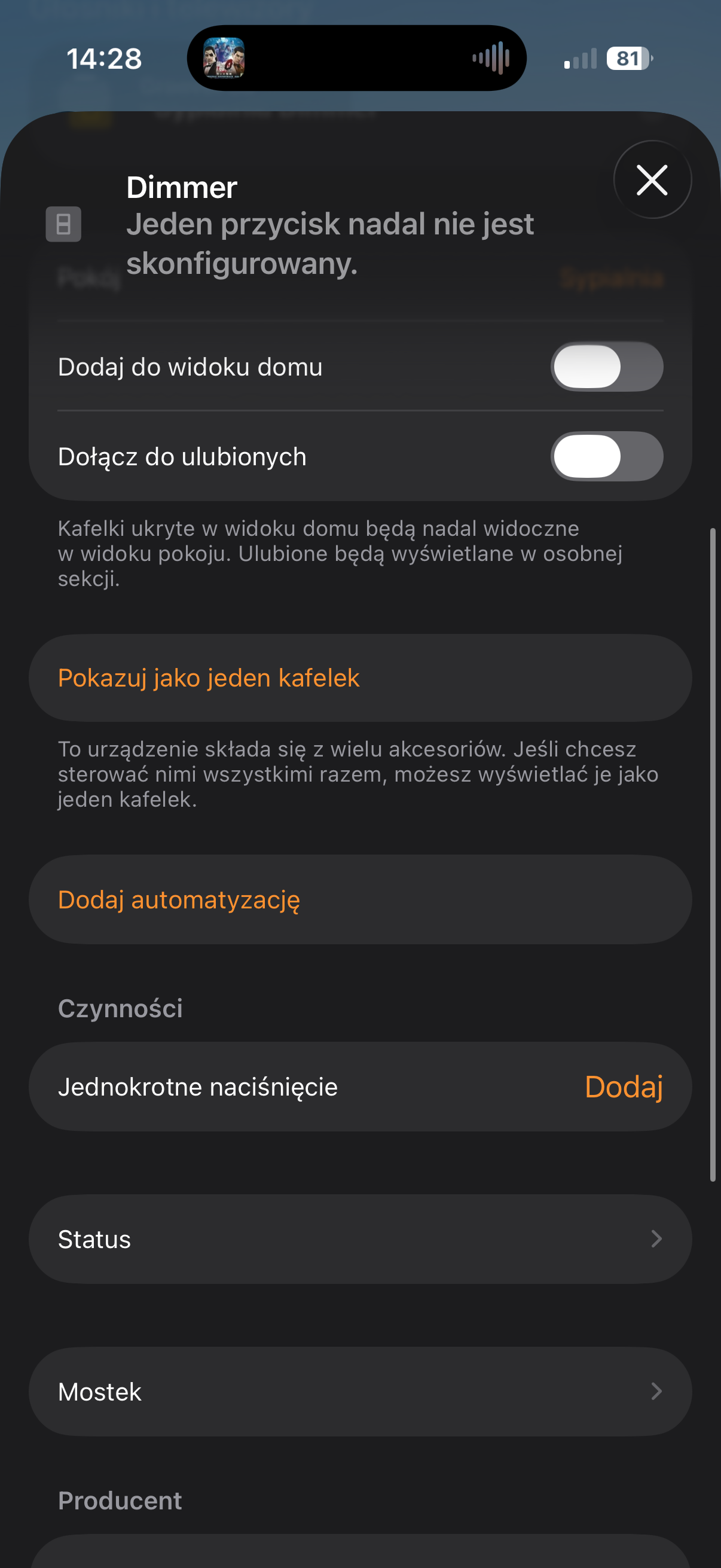

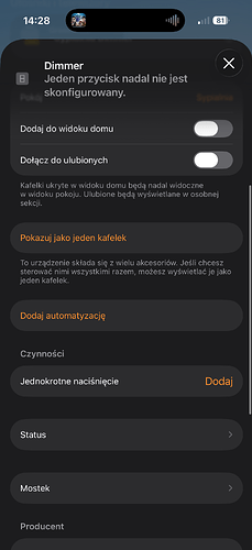

That’s how a H2 dimmer switch’s programmable button looks in my Apple Home („Jednokrotne naciśnięcie” means „Single press”). Firmware version 1620, connected via Zigbee, exposed by M3 via Matter

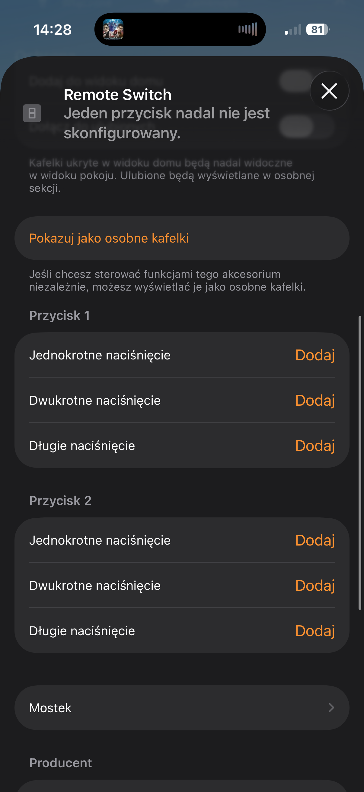

However, this is how the battery powered wireless switch is exposed. There are programmable actions for single press, double press, and long press for left („przycisk 1”) and right button („przycisk 2”), it’s also exposed by the same M3
I would still be interested in the raw data. As far as I understand, option a) in Home Assistant and what you can see in the screenshots only shows the Matter ‘Feature Flag’, which basically shows what the device is capable of. With option b), you can see in Home Assistant which events are actually being sent.
I’m just curious, but perhaps only one of the two is missing, or maybe both. It might help the developers fix the problem more quickly if they know in advance where it lies.
yes I have checked it and still the same thing - only single press
As I said, I’m curious to see what happens when you press the button. I would be interested in the raw data sent via Matter, as described in option b). Of course, if you’d rather not, I completely understand.
