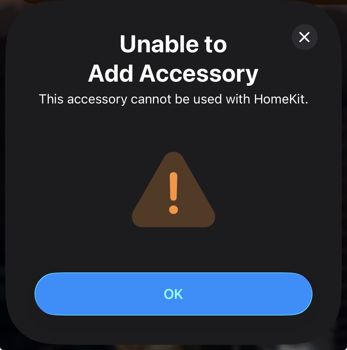

Try to pair the device again, received the following error after Apple Home app says “set up”
Tried the above steps on another M1S Gen 2, got into the same situation.
I suspect that there is a bug somewhere that causes the devices to lose it pair tokens. Can I get some help?
