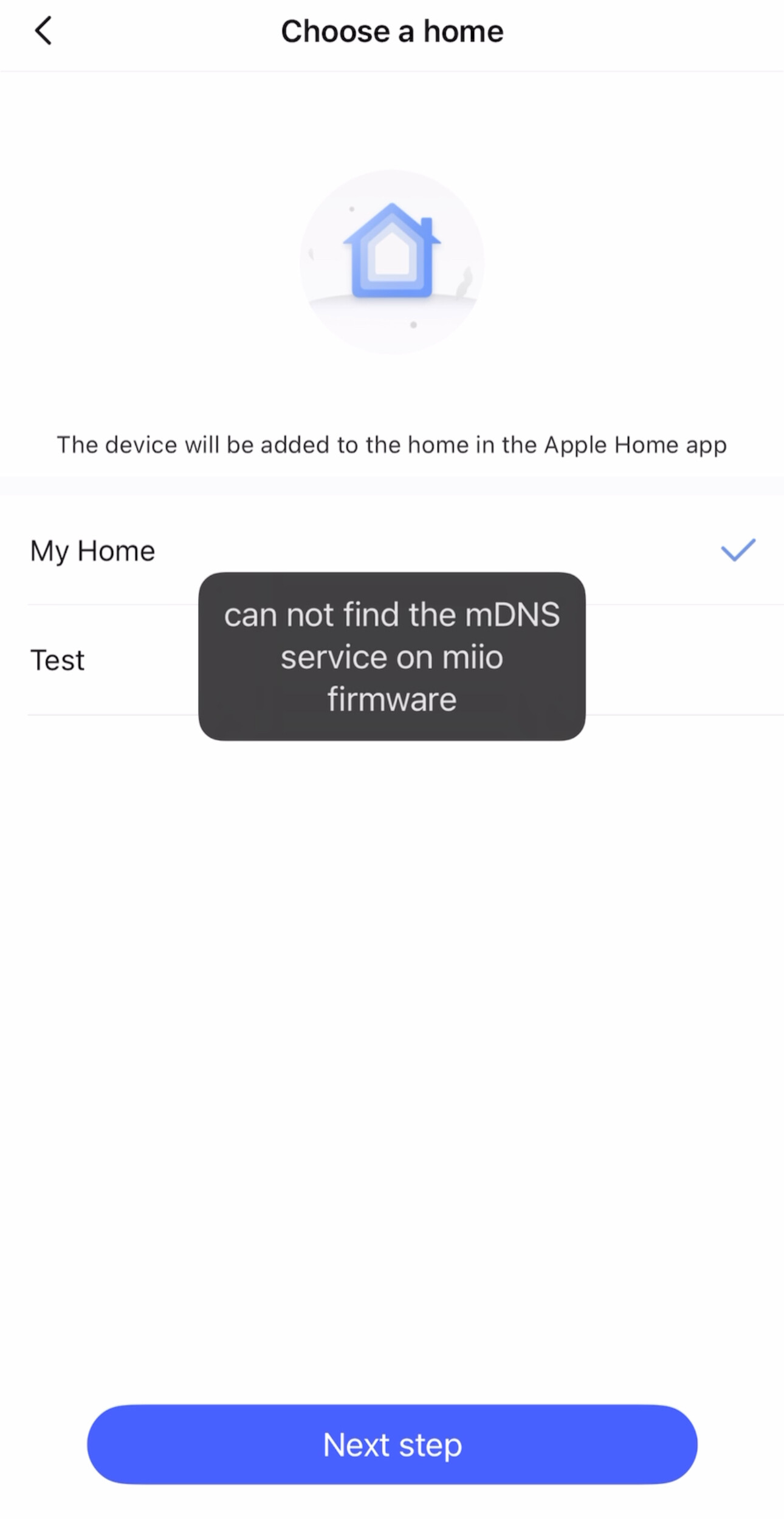

I am trying to add the hub to the Aqara app and it doesn’t seem that the app is going to do that, it’s added to Apple Home but not to the Aqara app. @AqaraBot

It looks like your M1S is currently running the Mi Home firmware, which is why you’re unable to add it to the Aqara Home app. You’ll need to switch the firmware to Aqara Home first. Here’s a step-by-step guide to help you do that:
:repeat: Switch Platform Mode (Mi Home ↔ Aqara Home)
1. Restore Factory Settings
  • Quickly press the power button 10 times in a row.
  • The yellow LED will start flashing, and you’ll hear a voice prompt confirming the reset.
  • Note: This step is required before switching platforms.
2. Enter Platform Switching Mode
  • Within 10 seconds after the factory reset, quickly press the button 2 times.
  • If successful, you’ll hear a “ding” sound and the white LED will flash briefly, indicating the platform mode has changed.
3. Wait for the Voice Prompt
After a few seconds, the hub will announce one of the following prompts:
  • “Waiting for connection. Please open the Mi Home app.” → Mi Home Mode
  • “Waiting for connection. Please open the Aqara Home app.” → Aqara Home Mode
If you don’t hear the voice prompt, repeat the 2 quick presses until the mode switches.
