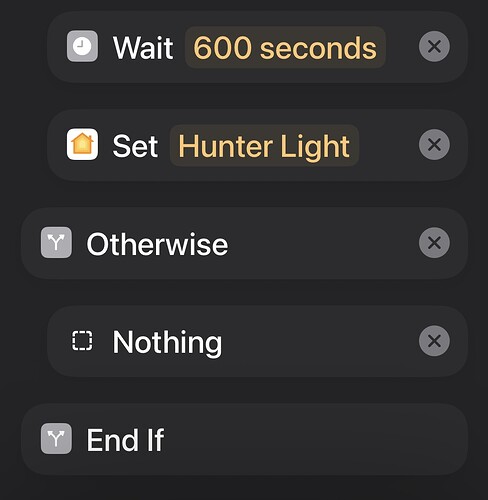

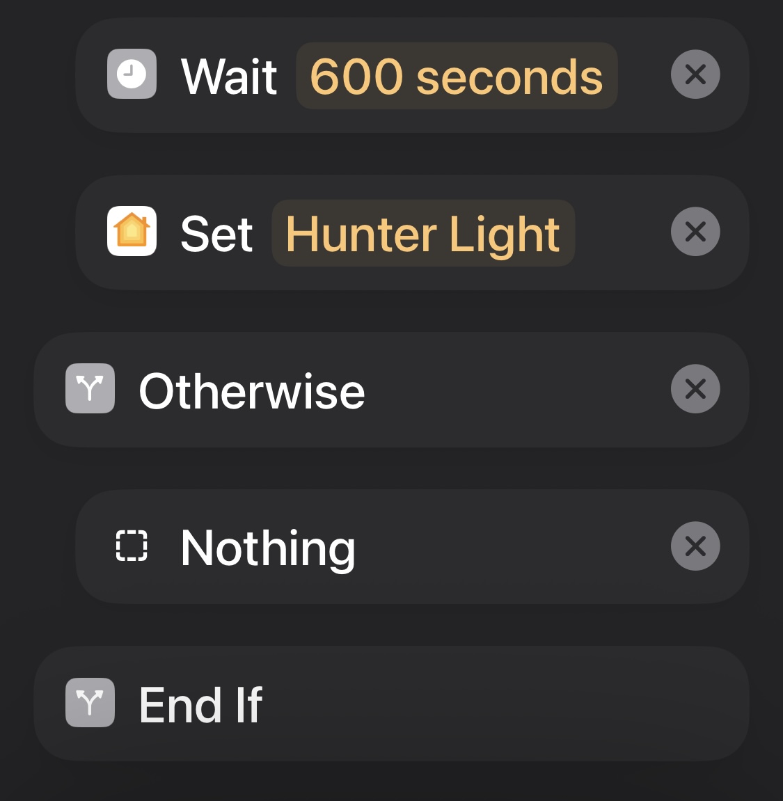

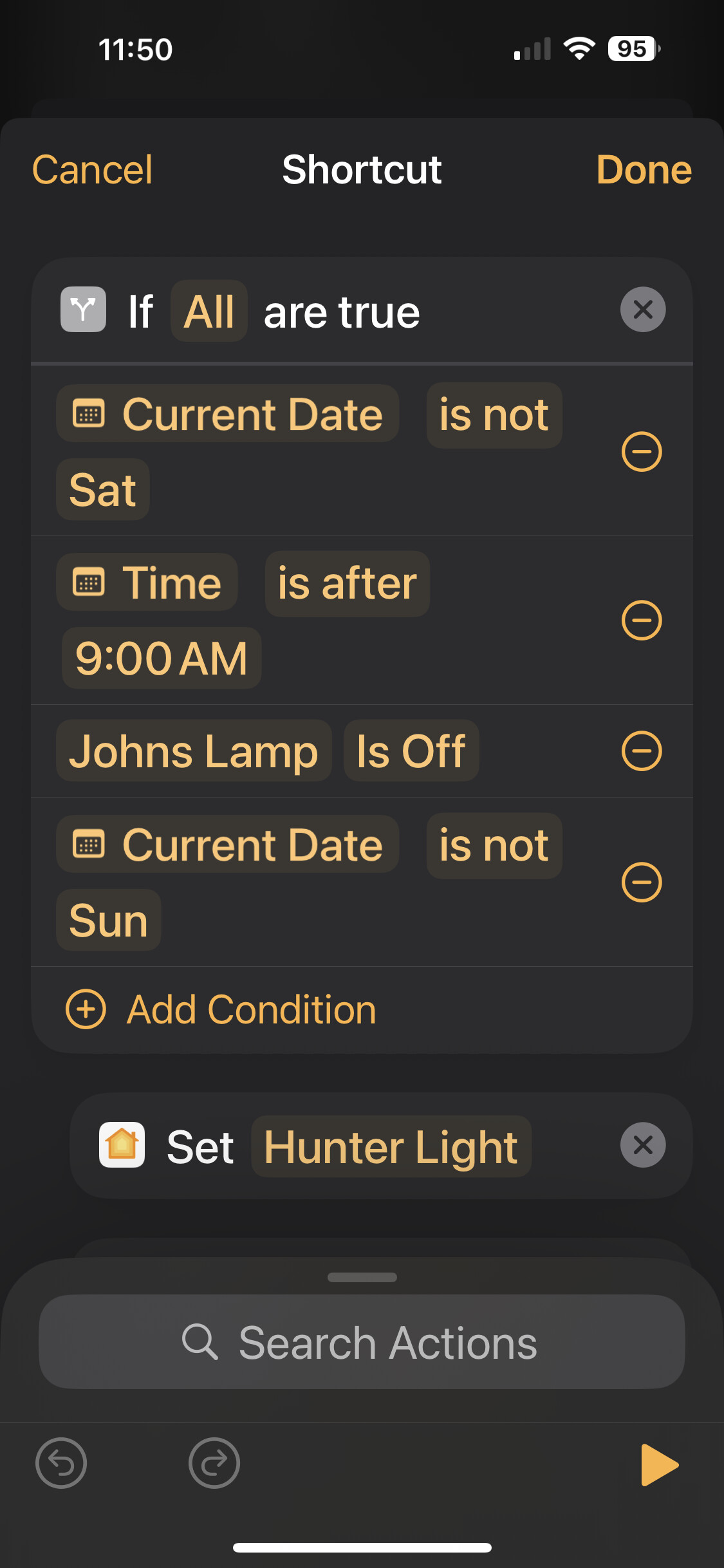

I had created the automations as shortcuts in HK. I was able to simplify and recreate and adding screenshots here. Basically, in the master bedroom I want to trigger a light to come on after 9am on weekdays on motion detection.
