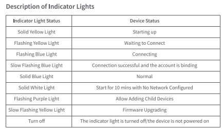

Here is a description of the indicator lights on the M3:
Unfortunately, there is no mention of a red light here, but perhaps it was yellow?

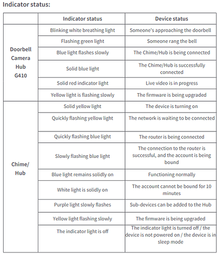

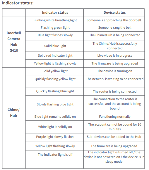

The red light on the doorbell may simply mean that the camera is recording something. With my G410, it also lights up blue when motion is detected and then changes to red to indicate that recording is in progress.
Here is a description of the indicator lights on the G410:
