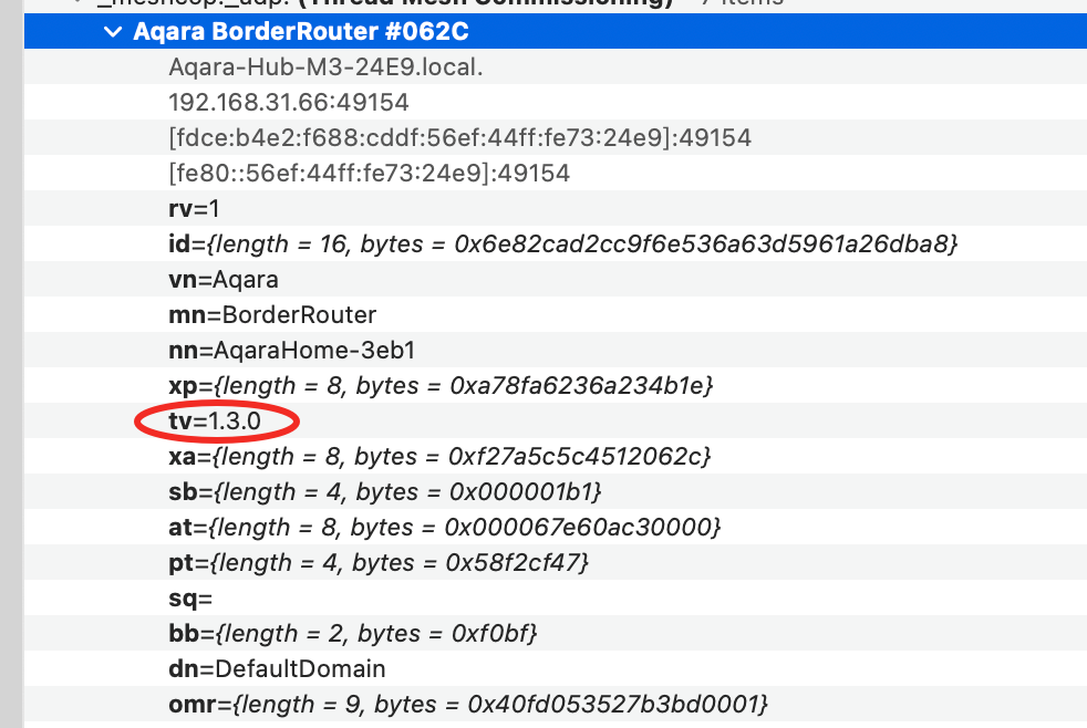

Interesting. Aqara support finally got back to my email and told me they are not on Thread 1.4 yet, but do support an Apple style way of having more than one border router on your network. I wonder if that’s what your problem was, your other border router wasn’t compatible with that or something.

My Apple TV is still showing Thread 1.3 on tvOS 26.
It looks like only the beta versions of tvOS 26 included Thread 1.4 - the final release does not.
