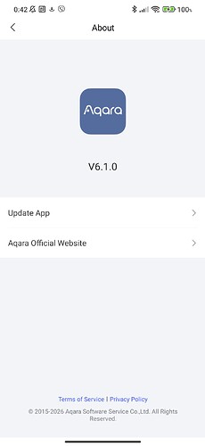

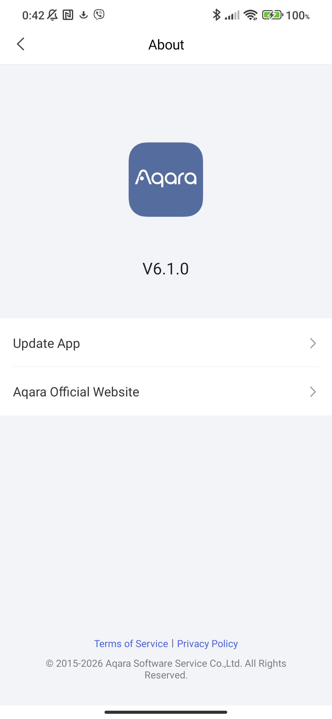

By the way, @gtxteo, update your app android, I deleted version 6.0.9 and my android pulled up version 6.1. Now I’m investigating its behavior.

Hello, I don’t know. The program didn’t work well for me. I deleted the app, rebooted the phone and started adding the app from the store again. I got a new version. I don’t know if it was a coincidence or if I just got access. But when the program was 9.0.9, it didn’t show me that it could be updated.
