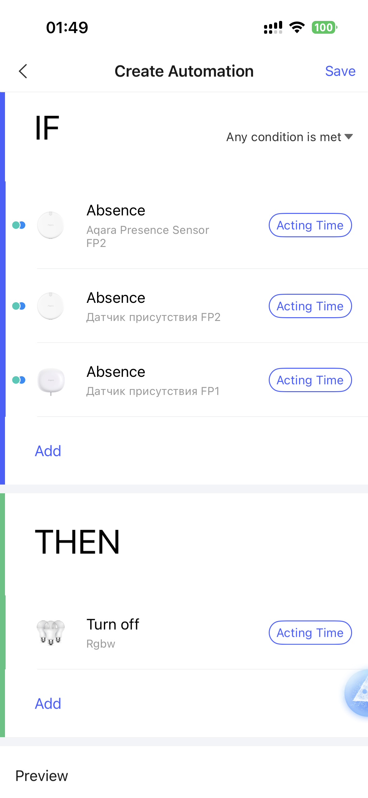

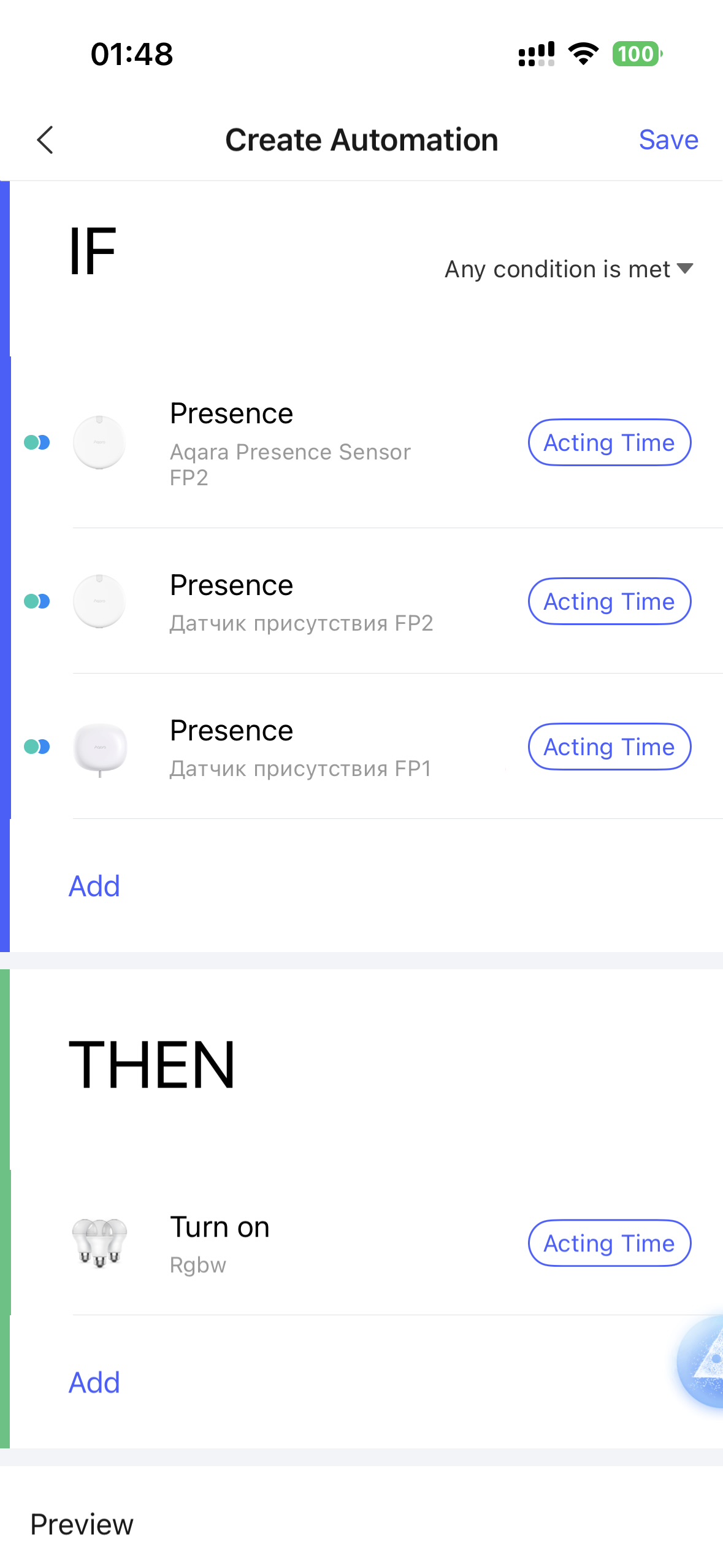

I’m trying to find a way to make my presence sensors work together because I have three of them in my garage. The garage is very large, so I needed three sensors to cover the entire area. I want the lights to come on whenever either of the three sensors detects a person, then I want the lights to go off when none of the sensors detect a person. This has been harder to do than expected. I’m trying to setup this automation in the Home App, however, all three sensors continue to be independent. Any ideas?
Actually the issue with Apple Home app is that you cannot use all of them together (all motion sensors), so you won’t be able to do that with the home app. You need to either switch to the aqara app directly or use HomeAssistant. I would suggest using the Aqara app to do this since that is the easiest way to do it, but if your light switches are not from Aqara, then you might need to switch to HomeAssistant.
My lights are controlled by Lutron switches through the Home App. How can I accomplish this in the Aqara App?
