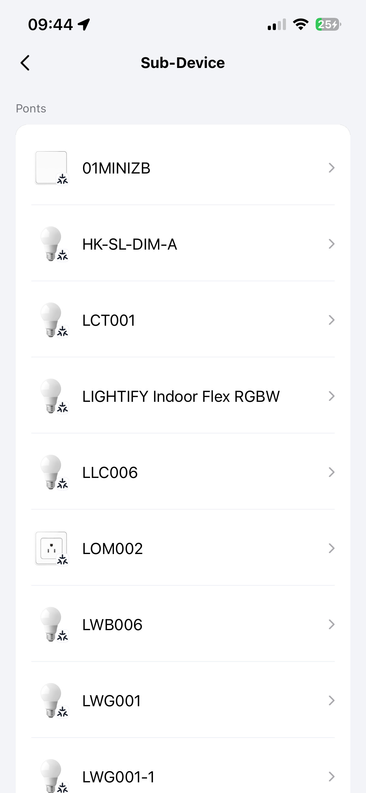

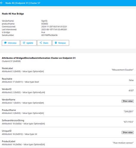

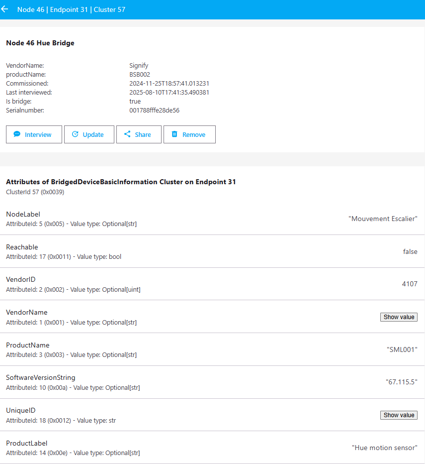

I am facing an issue when pairing a Matter bridge (like Hue Bridge) with my M3 Hub. The names of the bridged devices displayed are not those indicated in the Matter NodeLabel attribute (attribute 5), but rather those indicated in ProductName.
This makes the identification process very complicated and time-consuming. This should not be the case.

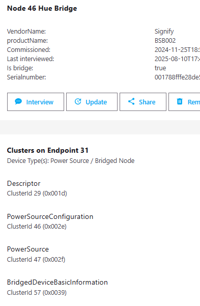

Hue bridge node
EP Bridde node

Here is the problem with the current implementation. How could you:
  1. distinguish between devices if you have several of the same model?
  2. identify what the model name, which consists of letters and numbers, corresponds to. This means nothing to users.
This does not seem sensible to me in this case because in the Hue bridge, a node name is defined for each device.
How about ProductLabel? It seems that it can be more clearly expressed than NodeLabel.
The value of the field NodeLabel is defined by the user, so it is a name that will have meaning for them, unlike a product manufacturer reference (composed of numbers and letters).
Look at 23-27349-008_matter-1-4-2-adopted-core-specification.pdf (page 760)
11.1.5.6. NodeLabel Attribute
This attribute SHALL represent a user defined name for the Node. This attribute SHOULD be set
during initial commissioning and MAY be updated by further reconfigurations.
