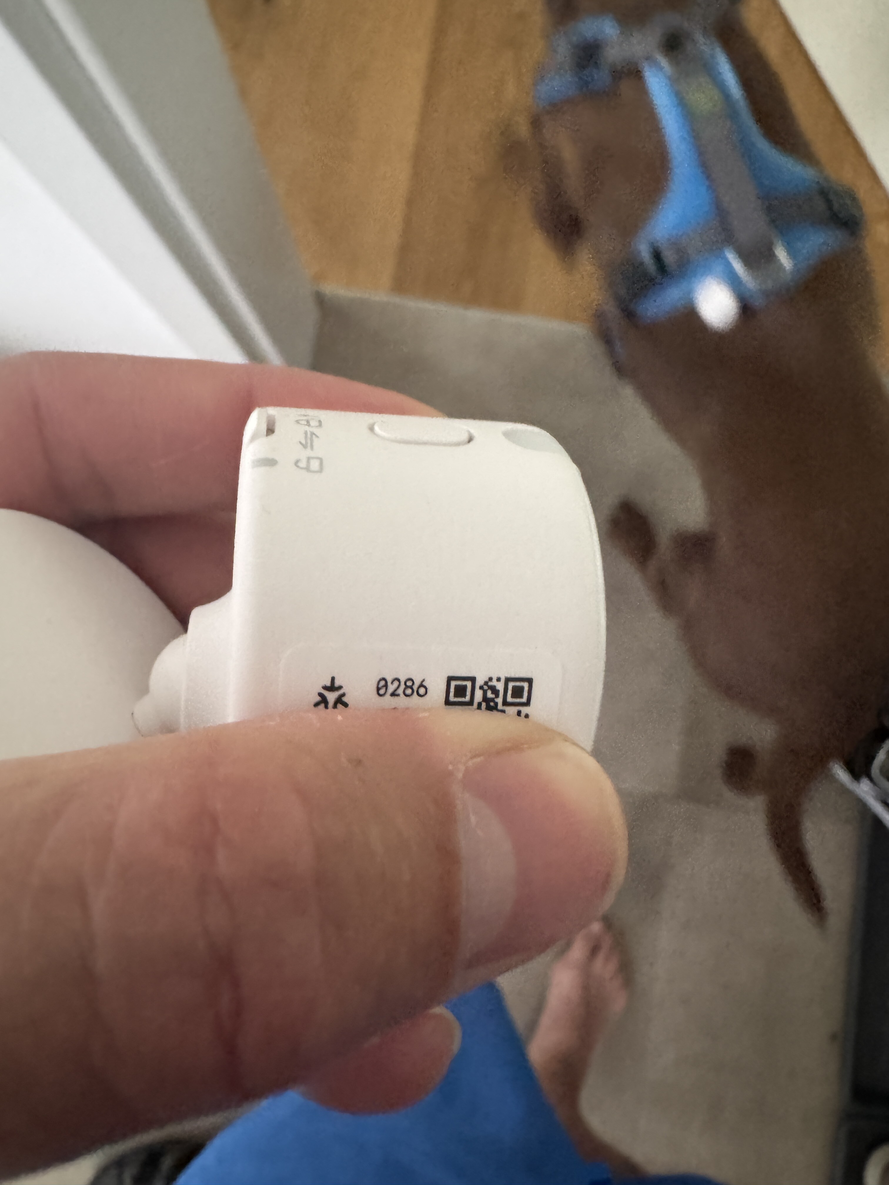

So I lost the pairing code to my G4 doorbell. I do still have the boxes, but there are no codes on the boxes. They’re just serial numbers any other options to find the pairing code? I literally bought this months ago. It was in my cabinet someone must’ve thrown it away.
Did you check the chime?
Image Source: Video Tutorial
You should be able to find a code for HomeKit, but you won’t find one for Matter, since Matter isn’t supported by the G4.
So the sticker is away on the device itself?

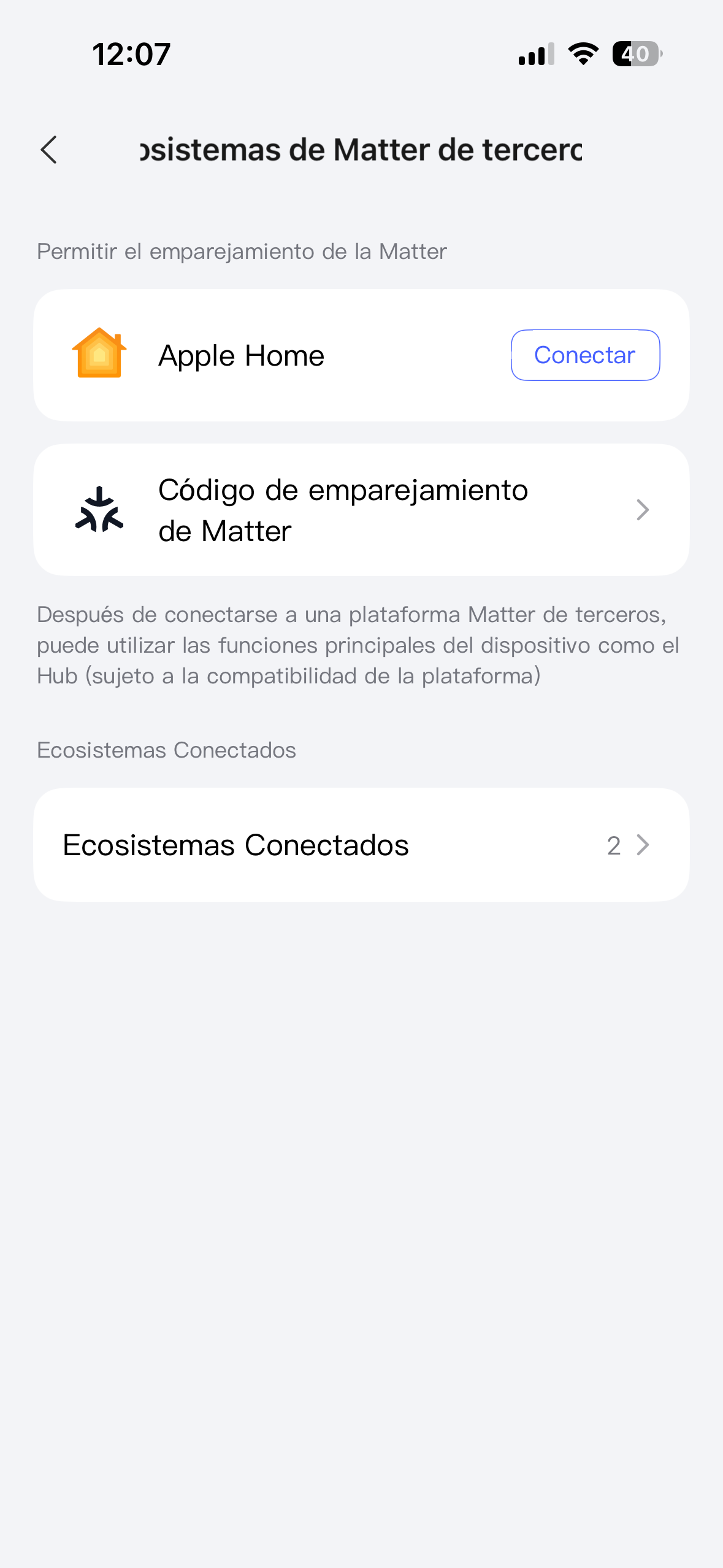

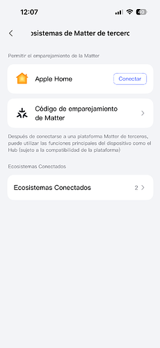

I don’t think it is imposible aqara have to store each matter/thread for each seria number because this could be a bummer that an company that sell matter/thread devices to can’t give their buyers an copy of that code in case it is lost by the buyer like in this case.for example meross have implemented that on their own app so if you loose that code you can recover it from Meross app directly.but I think also aqara have something like that on their own app if that sensor it is already paired there.if he can pair it then con to ecosystem and chose thread I think aqara app gives you the thread code there directly or I am wrong?the photo is taken from my M3 hub just as an example
