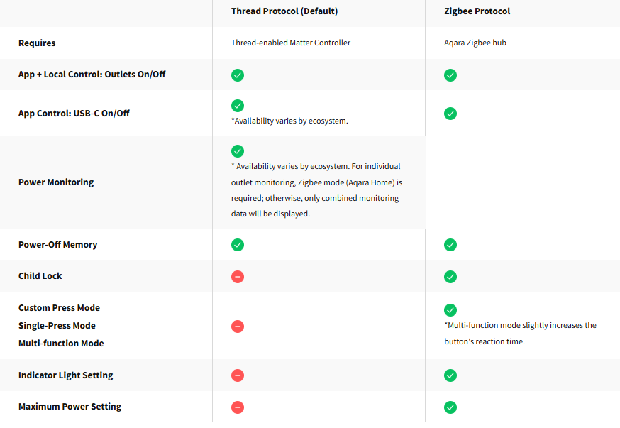

I just took a quick look at the specs for the Wall Outlet H2 UK:
Source: Aqara Wall Outlet H2 UK: USB-C Port & Power Monitoring
I can’t find any further information about the Power Plug H2 UK.
It definitely works with the Power Plug H2 EU.
