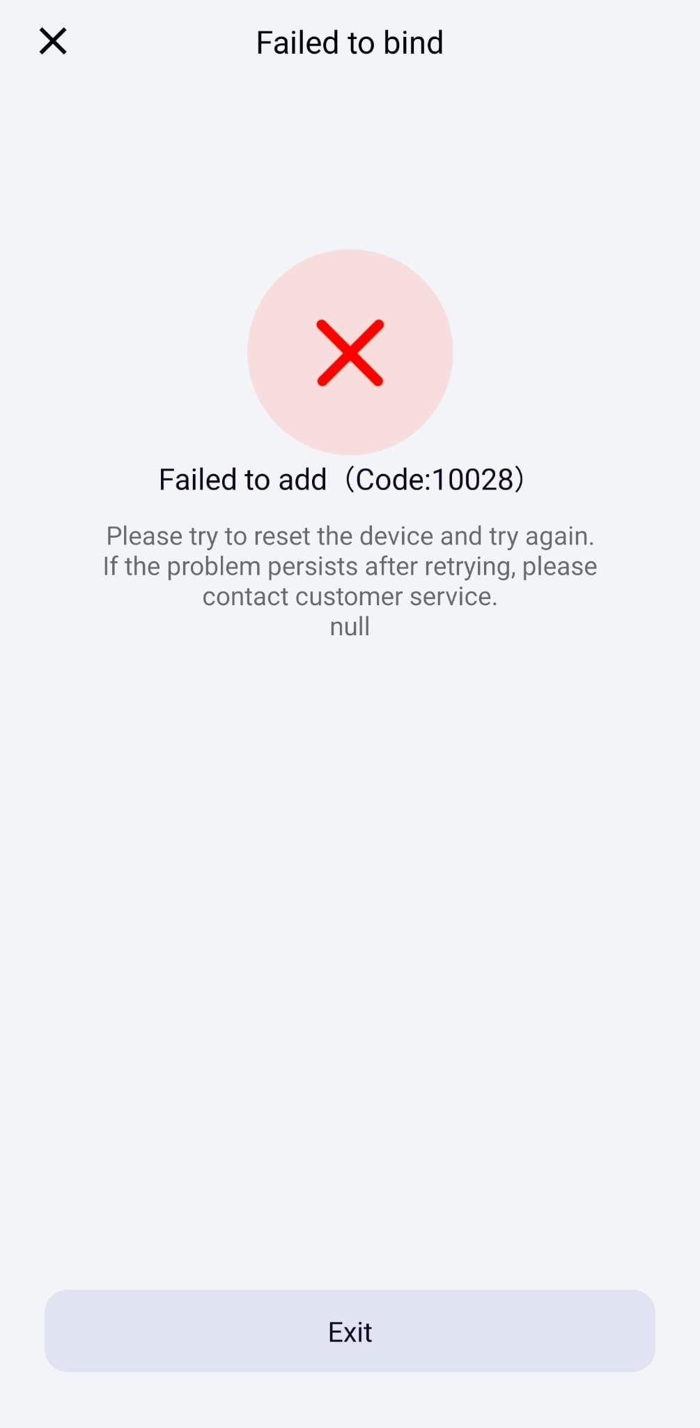

I am unable to pair the Meross M605, Matter Presence sensor to Aqara Home via Aqara M3 hub.
I keep getting the connection failed error, see below:

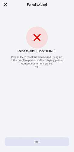

Even after a device reset, I get the error below:

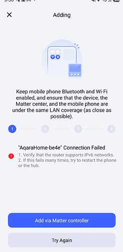

However, I get the same error when trying to pair the device to Aqara Home using the Matter code from Google Home.
Also, I do not believe that it is a IPv6 or network issue as it connects to Google Home just fine.
Any help or guidance will be appreciated.
@iEnam You seem to be facing issues pairing the Meross M605 Matter Presence Sensor with your Aqara M3 hub. Let’s try some targeted troubleshooting steps based on common Matter pairing scenarios:
First, ensure both your Aqara Home app and M3 hub firmware are updated to the latest versions. Outdated software can often cause compatibility hiccups with Matter devices.
Next, check the Thread network status of your M3 hub in the Aqara Home app. Go to the hub’s details page and verify if a Thread network is successfully generated. If the Thread Network field is blank, you won’t be able to add Matter devices—try creating a new Thread network for the M3 hub (note: this will require resetting existing Matter devices connected to it).
Since you mentioned the sensor pairs with Google Home, it’s also worth confirming that your M3 hub and phone are connected to the same local area network. Sometimes network segmentation can interfere with Matter pairing.
If these steps don’t resolve the issue, you can contact the Aqara Home App Customer Service Team (Profile> Help & Feedback > Customer Service) or scan the QR code:
