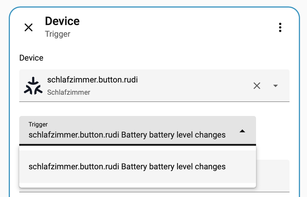

I’m a huge fan of the Wireless Mini Switches. They’re super handy, and I use them all over the house. But their integration with Home Assistant through Matter feels a bit… let’s say “minimalist.”

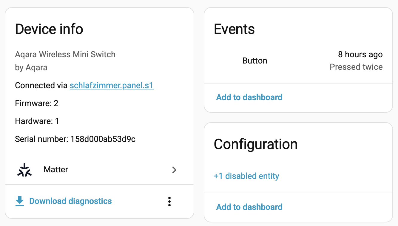

In HA I can see the button presses — single, double, long press — but I can’t actually use them as triggers for automations. The only event I can select is a battery level change. And unless someone in my house spends the whole day pressing that switch really aggressively, that event isn’t all that useful.

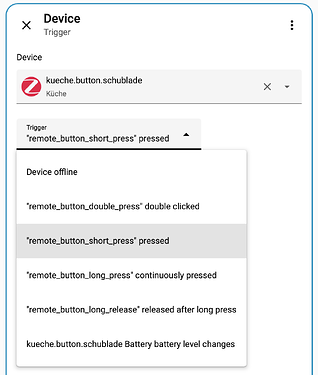

The switches are connected via an Aqara Hub through Matter. When I pair the same switch via Zigbee, all events magically appear and I can use everything as expected.

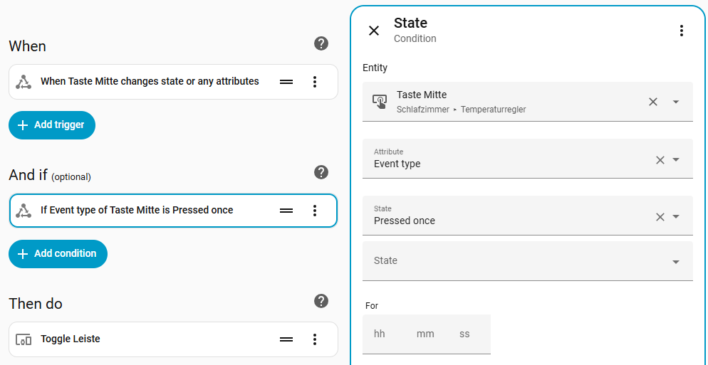

Hi. I don’t think device triggers work there. It only works with the state trigger in the WHEN block and a state condition in the AND IF block. I think this is due to the Matter plugin and not Aqara’s implementation. I once read that this is also the case with other manufacturers.
@JohnD Yes! That’s how it works. Thank you!
