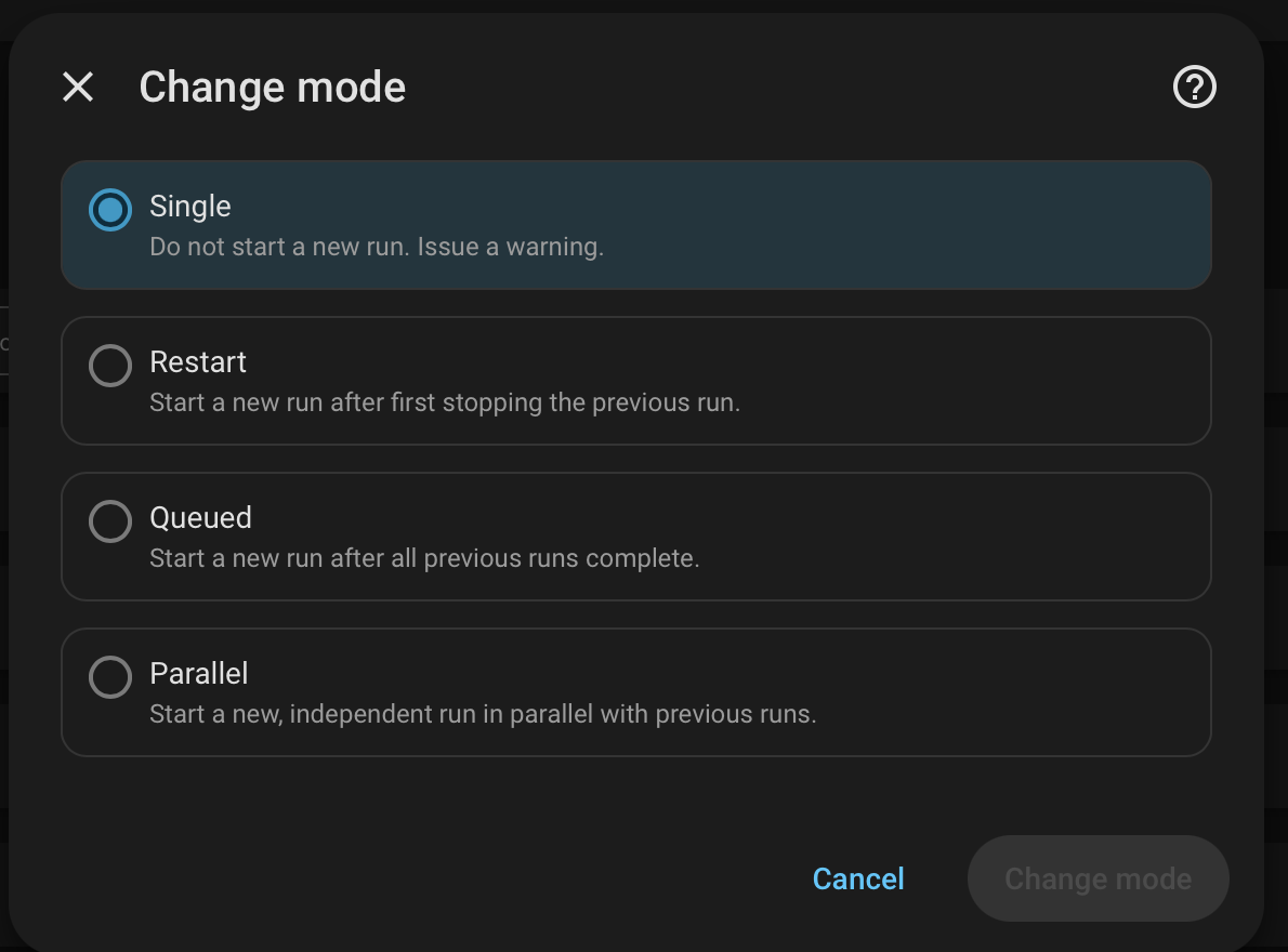

These options can also help certain automations in addition to everything mentioned above.
