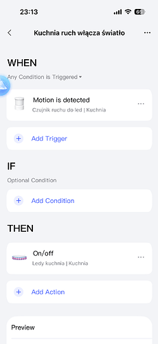

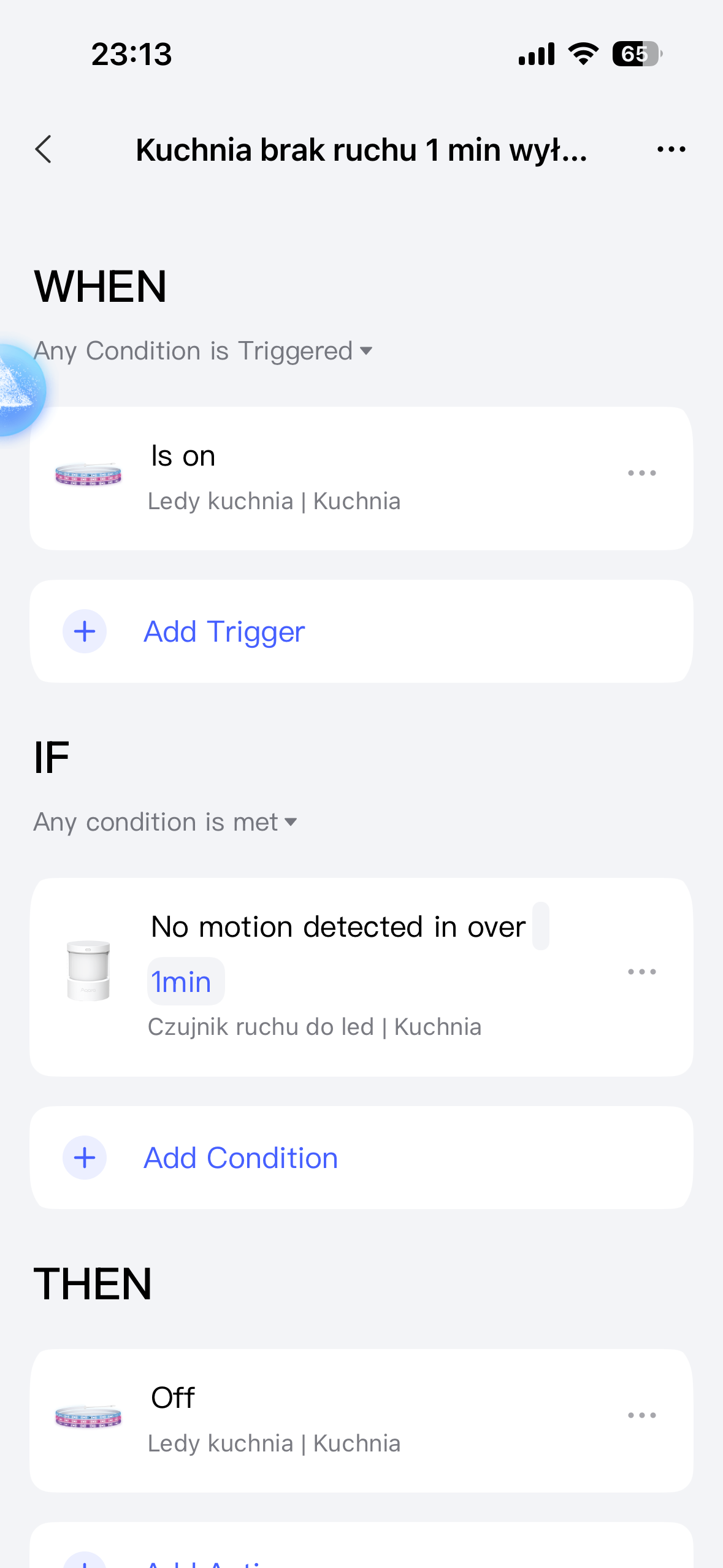

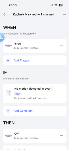

I’m having a problem with creating an automation for LEDs with a motion sensor. I’m trying to set up the following automation: when the LED is turned on, if the motion sensor does not detect any movement for more than one minute, then turn off the LEDs. Unfortunately, this automation is not working for me.

Hi @adam2dobrzycki. For ON → Your starting automation is false. You must set when Motion is detected TURN ON, not On/OFF.
And for OFF → When no motion motion ist detected for (1 minute, 10 minutes, etc etc) IF LED is ON then turn off
