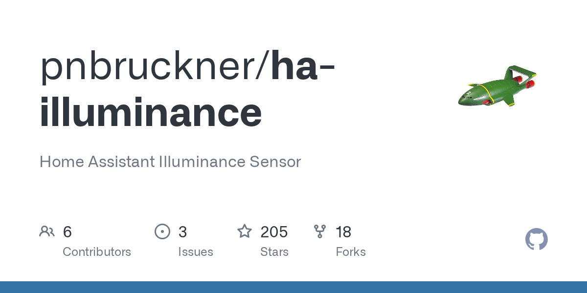

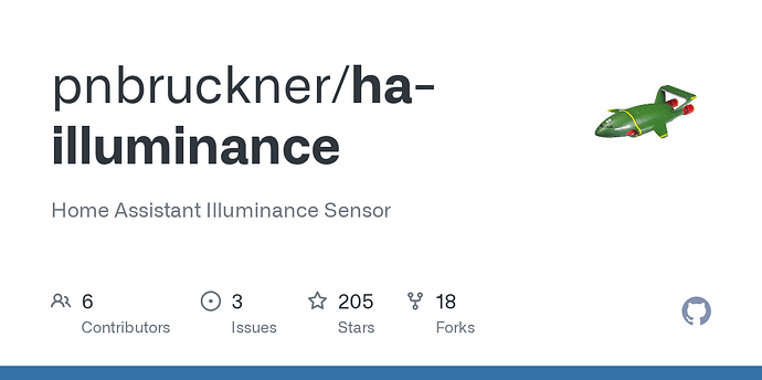

In case you’re interested, there are also integrations for HA that estimate light values based on the position of the sun and cloud cover.
